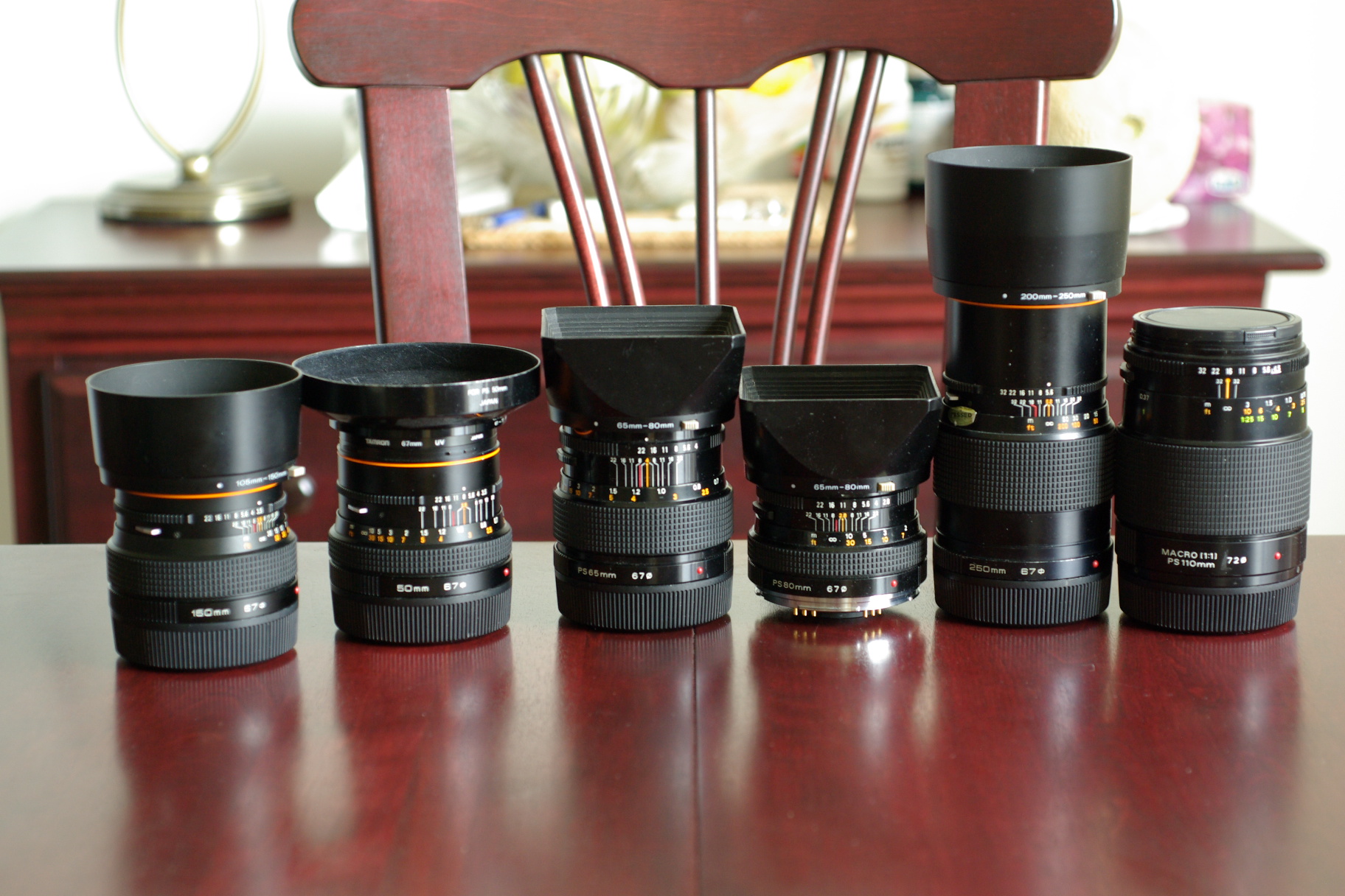

Here is the promised photo.
Congratulations Scott it's a first rate camera I hope you have a lot of pleasure using, it's amazing what good prices you can buy pro quality cameras for these days, I too have cameras now that could only dream about 25 years ago that I never thought I would ever own.
