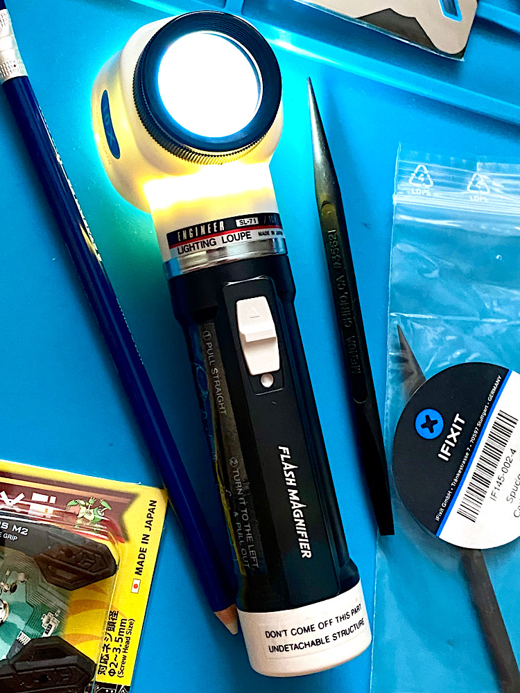

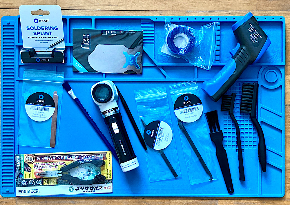

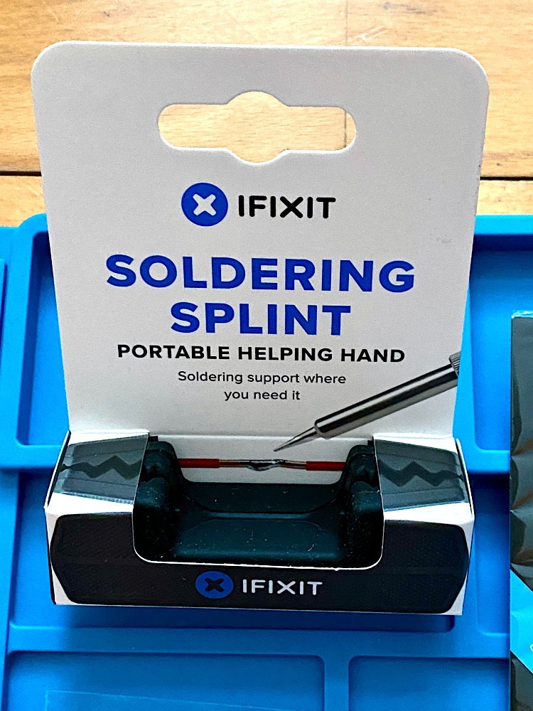

Yesterday I went on a more extensive shopping spree in the German iFixit store.
There were a lot of tools I didn't know yet. Now I'm waiting for tools to open electronic devices, solder, clean or inspect.
Although the things are tailored to modern devices, they can also be used perfectly for electro-mechanical cameras from the 1980s.
The Spudger for working on circuits or the Opening picks that I use to remove the leatherette are already in use.
The offer in the German and US stores should be comparable:
I have replaced several screens and other components of iPhones using iFixit kits that come with tools.
The tweezers are particularly good for fine work, but they are rather delicate. Everything else is fairly durable.
The scratch brush is an underknown tool, I used it when I was in the Navy, and rediscovered it years again when I found a great source for tools and small hardware.
BTW: what about a pinned thread for sources for our special needs, small screws, springs etc?
not sure it would be so long, tiny springs or screws are not that easy to source.
I agree used cameras are a great source, sometimes.

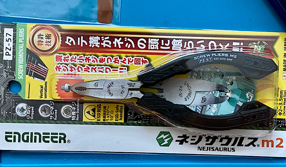

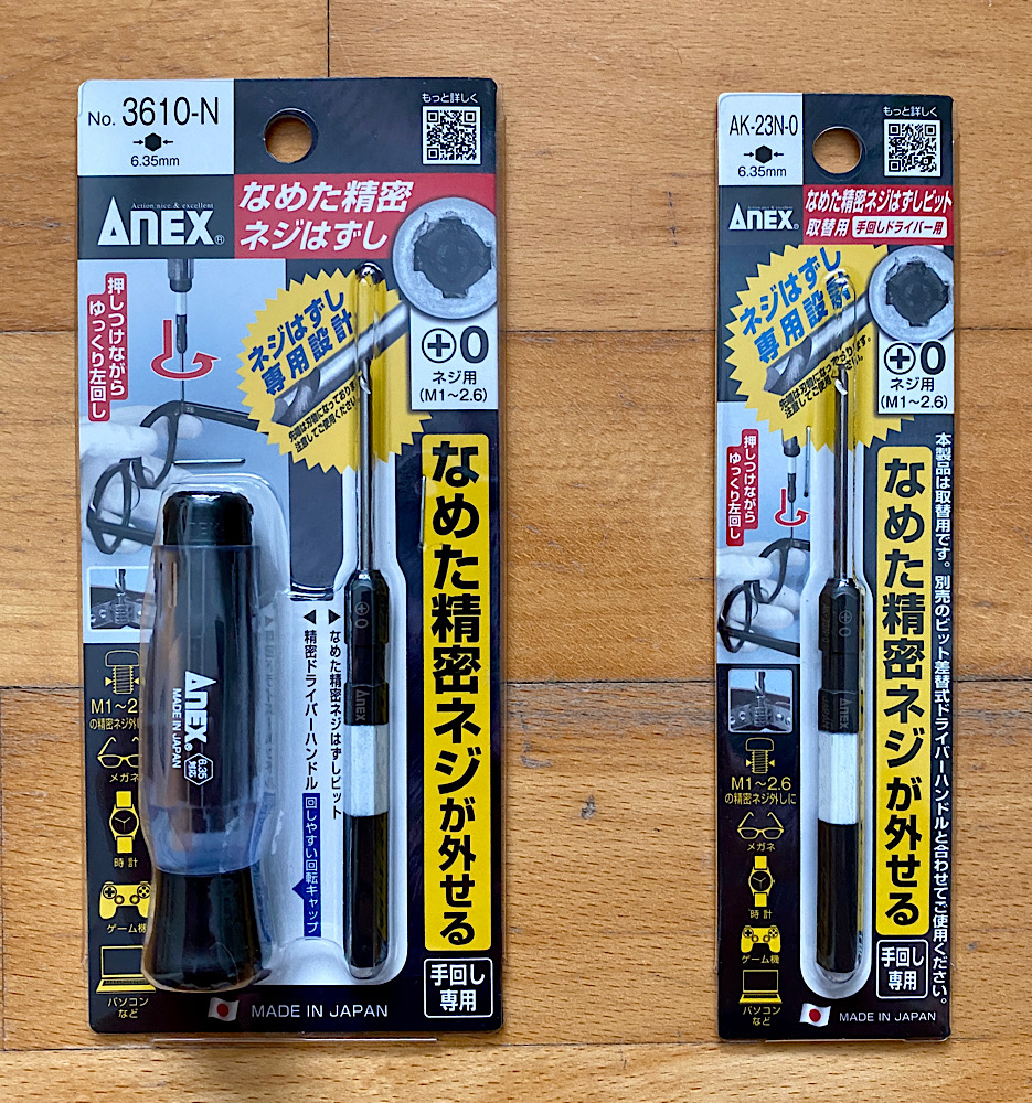

I have that Japanese Engineer piler as well . I bought it from Japanese Amazon.
I'm excited to see how it performs.
Unfortunately, you cannot use it to loosen screws whose screw heads do not protrude, such as in the lens bayonet.
I have been using a similar tool for probably 30-40 years for copier repair before JIS screwdrivers were common. Regular screwdrivers would strip out the head so we used this. We called it Jaws.

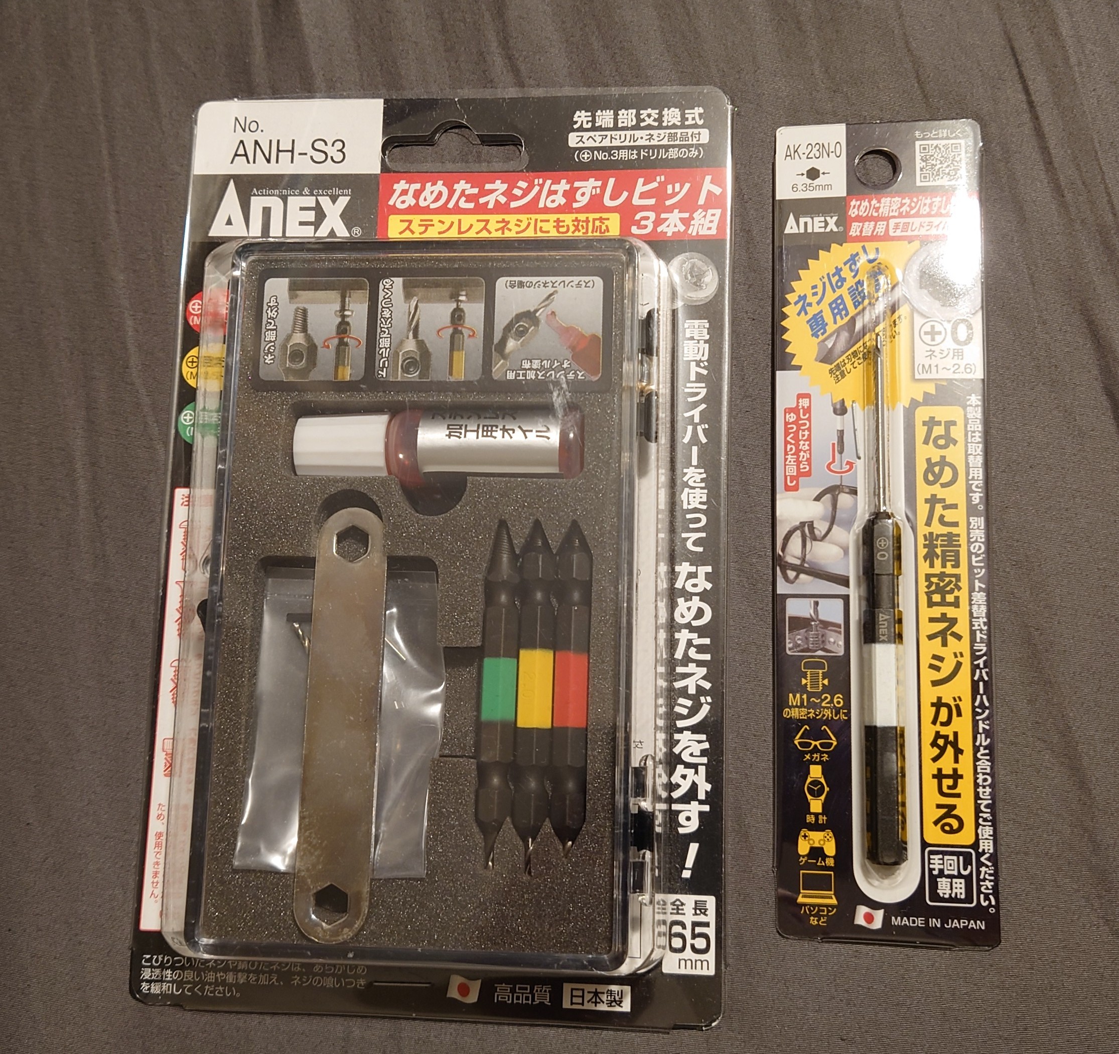

In that case I would use this set:
Especially the white one, and then I reinstall the a screw.
Although the packing said working best with Philips screws, I found it also works well on slotted brass/copper screws.
Thanks! 😃

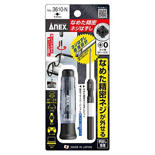

On the right of the picture is the first screw extractor for M1 screws that I see ✌️
I ordered it and also this one, which has a higher torque with the handle:
These useful tools for precision engineering can probably only be found in Japan.
Thanks! 😃
It is a fine drill and so remember to use it with care.

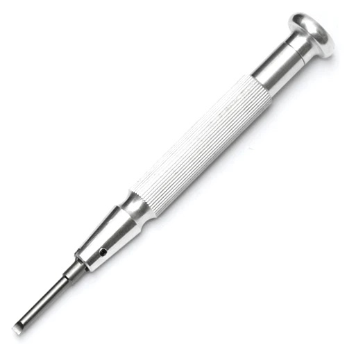

I have plenty of JIS cross tip screwdrivers I have collected over the years, but not a good selection of fine blade tip screwdrivers that are not damaged. The blades on the two smallest size screwdrivers I got in '74 are damaged beyond repair.
I just got these screwdrivers in three sizes from Japan Hobby Tool. Very nice! They are bigger than they look, but the tips are very fine.
I remember I should have similar screwdrivers in the past. It came with a longer handle and there was a hole on the handle which I can also insert a short bar for helping to remove tightened screw.
Here is the manufacturer's information about the screw extractor.
The tool therefore works directly on the damaged screw head; no hole has to be drilled.
Translation is easy using the tools in the browser or Google Translate. The video speaks for itself.
Just arrived.
With and without additional handle:
