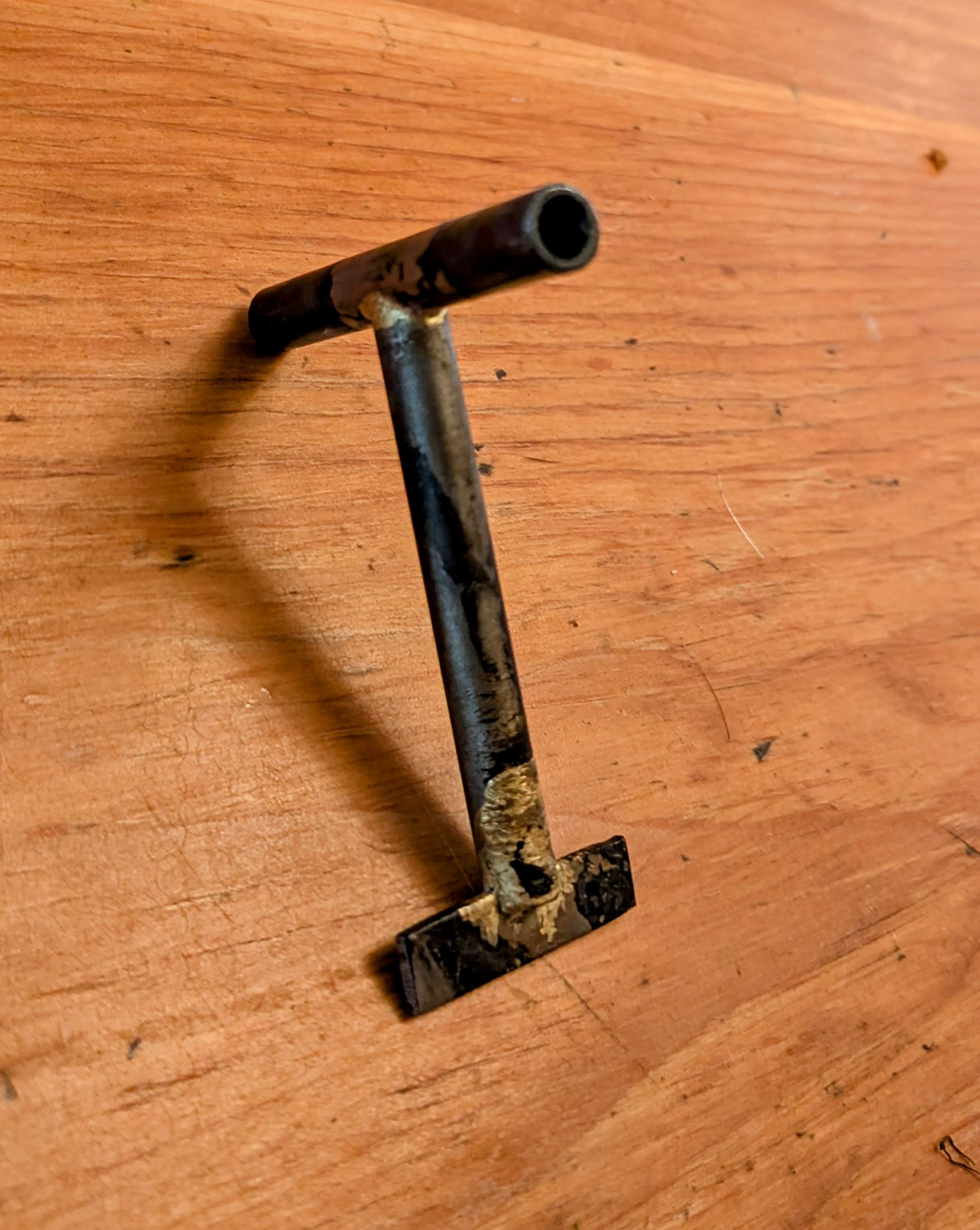

If you can remove the rear lens you could make a much simpler tool. A piece of steel plate of the right length and thickness to fit in the notches, with a handle brazed or locked onto it. Now I remember that this is what I did. A prior attempt with a regular spanner had marred the notches.

I bent a piece of 4mm brass rod into a v shape and filed the ends to fit in the notches in the ring. Not terribly difficult.

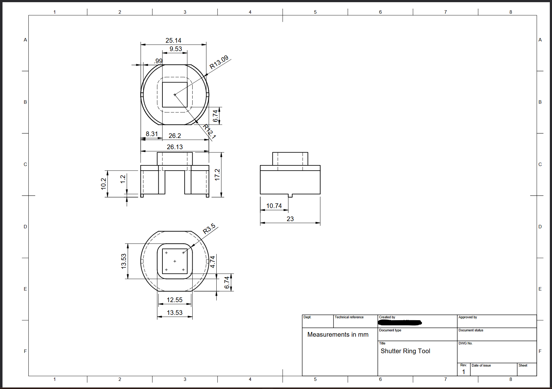

I believe Id get busy with Freecad and design one. Will likely be a fair amount f trial and error prototyping, but it's probably do-able. Of course, for the protruding tangs themselves, those would need to be made of metal.
