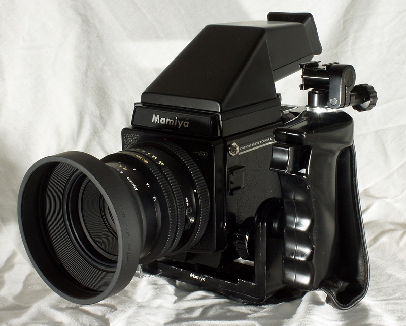

Here is how I had mine set up when using it hand held. What a beast though!
If your's is the Professional SD model Mamiya will still service it at a reasonable rate. But if its an older model servicing can be more difficult.

That hand grip looks really nice.. never had one, that can be a real asset.. does it hurt your wrist after carryig it for awhile? I tend to hang my camera on the neck strap over my head n a shoulder. That takes the weight off it so it virtually is suspended just at the right level when using a chimney or WLF. When using the prism I have to support it but still not a problem after working with this beast for many years.. your arm tends to get stronger with experiance... still a balancing act of a sort to take the weight off it.

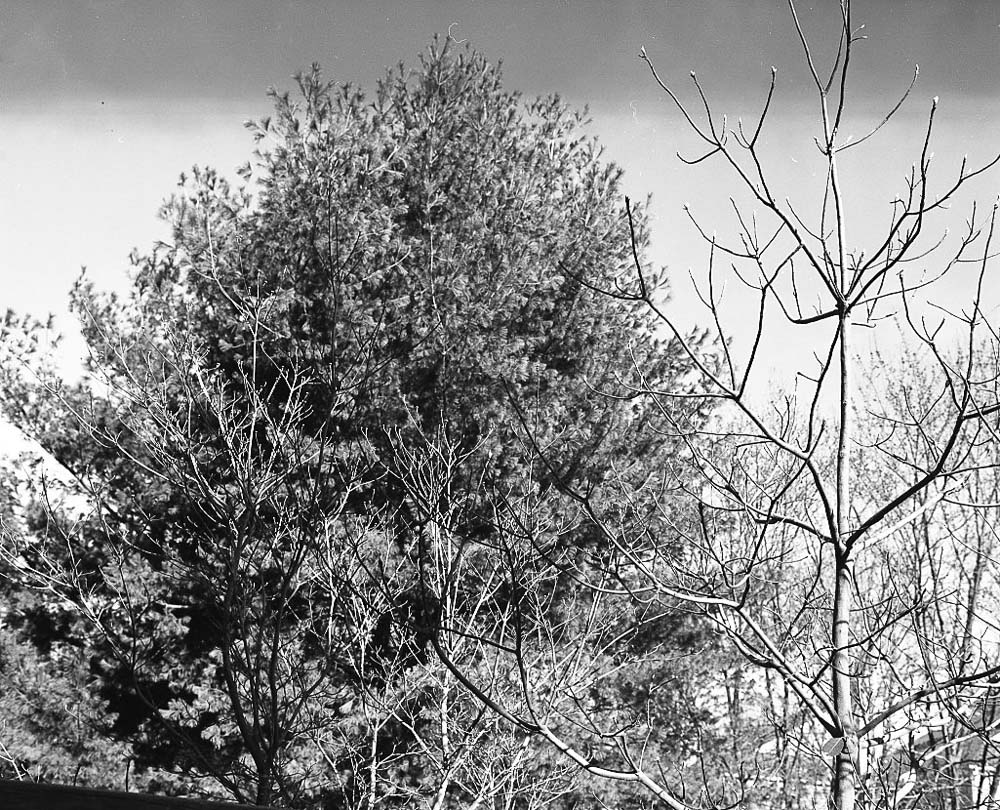

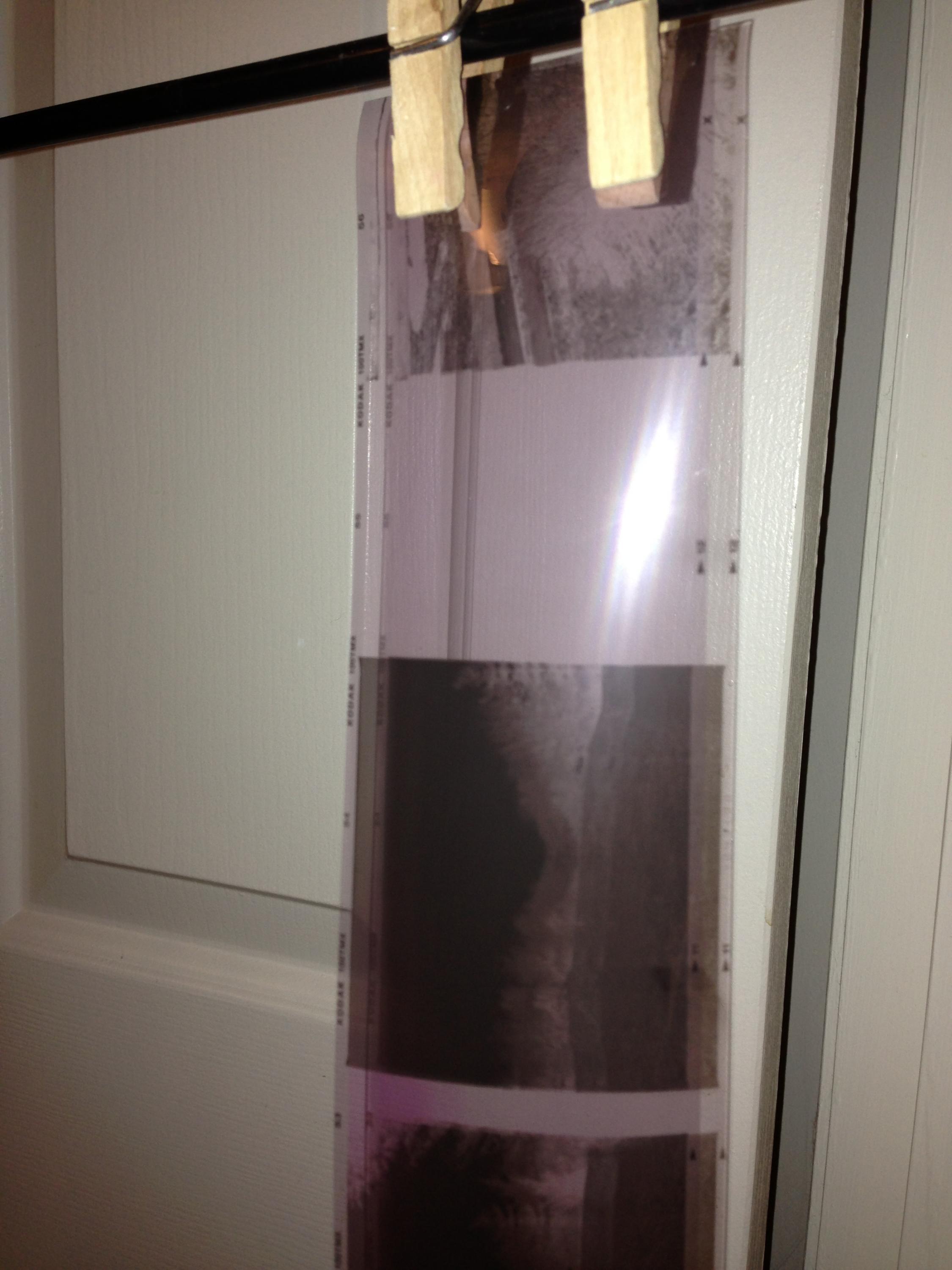

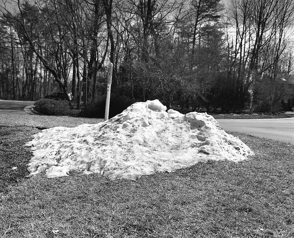

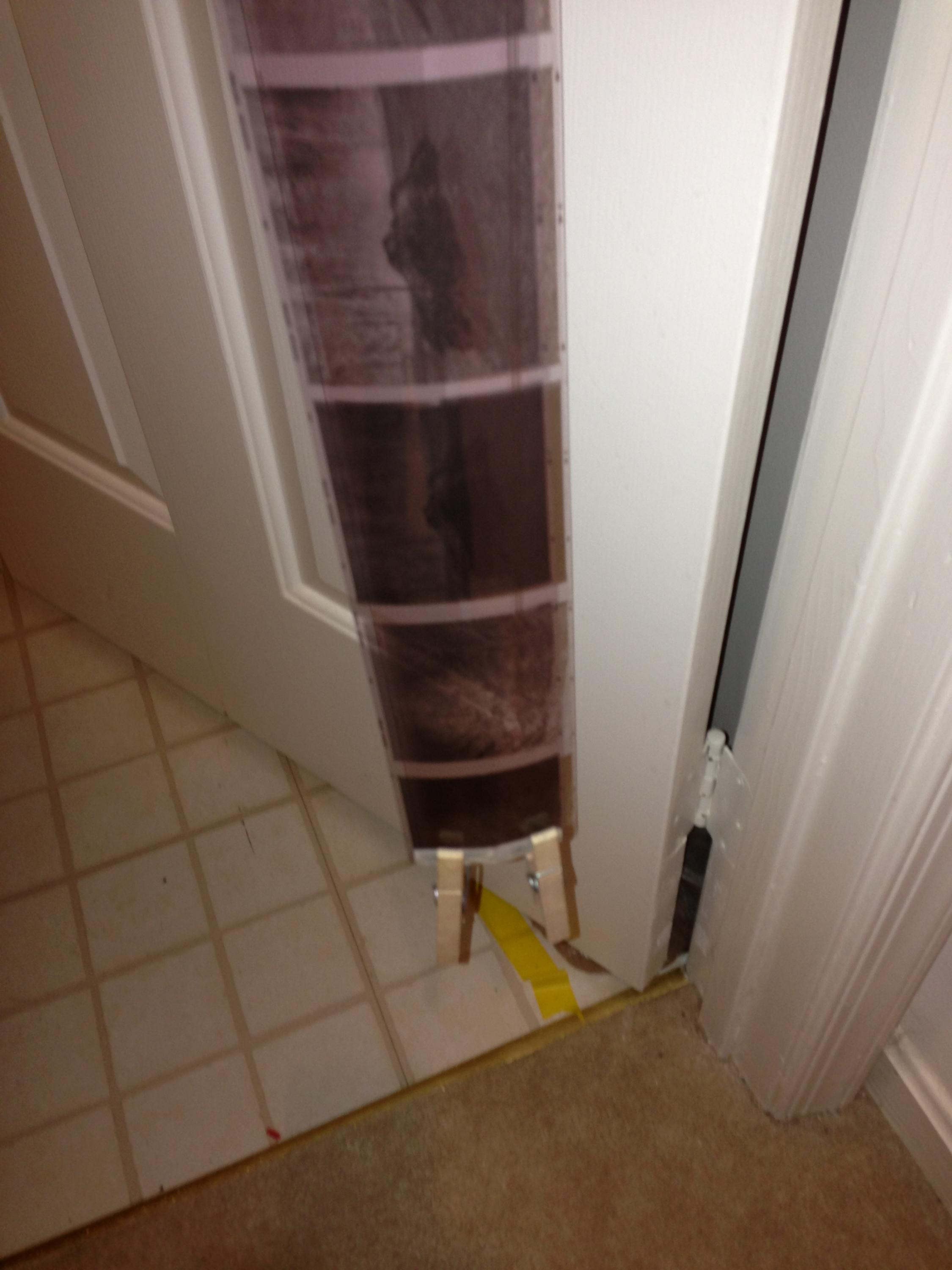

Thanks everyone. I developed the negatives last night and there was some oddity was the images seemed to cut off at the start and end with a gap. I also messed my and only put 450ml of fixer rather than 500ml which I think caused a dark band on the top of the images. Here are two images and a picture of the negatives so you can see what I mean. My guess is I didn't load it quite right. Still the images are incredibly sharp...love it!

MattKing
Apr 24, 2005
54,424
Delta, BC Canada
Re the start:
Did you line up the start mark on the paper backing with the start arrow on the insert?
Re: the dark band at the top:
If indeed it is a problem with fix not reaching part of the negative, you can re-fix and re-wash them.
And it is okay to do it in the light.
And I agree about the negatives!

You should check the capacity of your tank with a reel in place. Just add water and the empty reel, adding just enough water to cover the top of the reel and then measure how much water you used. In all of my tanks 450ml is sufficient.
I have that same adjustable grip as revdoc shows in his post above on my RZ. The thing is all metal so it can add weight to the already massive kit. It is adjustable so it has a setting for a prism and another if you're shooting with a waist level or chimney finder etc.
I'm sure it would eventually give you a cramp but it really helps making the camera manageable with the metered prism. The meter is awesomely accurate and versatile for street shooting so to me its an essential part of the rig.
They are a bit hard to come by so if anyone is looking, make sure the bottom plate is included. This plate is magnetic and is essential for mounting and gets misplaced. I've seen several with this piece missing on that lovely auction site and the sellers usually dont even know it's needed or existed :cool:

Cep,
see how your negs have that slight pink/magentaish hue to them?
That's a sure sign that you haven't quite fixed the film completely.
Delta or Tmax films require due diligence when fixing and generally will exhaust your fixer quicker than with not tabular grain films.
Not saying your fixer is exhausted just you probably could use some longer fixing times.
The odd striping is stumping me but hopefully that issue will sort itself out when you have perfected your film loading technique and get your solution levels correct when processing.
