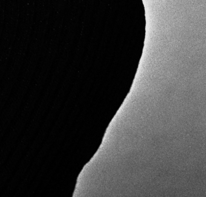

I played around with severely diluted Rodinal many years ago after reading about 'edge effect'
35mm FP4 @ 200, Rodinal 1:400 (0.75mls in 300ml), 20C, 90mins with agitation : 1st 30secs, 1min, 5, 10, 20, 30, 40.
35mm HP5 @ 320, Rodinal 1:400 (0.75mls in 300ml), 20C, 90mins with agitation : 1st 30secs, 1min, 5, 10, 20, 30, 40, 50 (film was underexposed in general)
detail of above (her left arm).
I stopped experimenting at that point.
However I would like to add, when I used Rodinal, I generally used 1:100 (3ml in 300ml) for 20mins with agitation every 2 mins. Examples below.
Nige, so the film was processed in only 0.75ml of Rodinal. I am no chemist but it suggests to me that 3ml or 4 times as much is certainly more than enough and 5-6 mls is taking the idea of a safety margin way beyond what may be required
A supplementary question if I may. When you mention the agitation method and times is that one inversion at each time you mention?
Thanks
pentaxuser
Yes, 0.75ml. Although this was many years ago, I remember using a medicine 'eyedropper' thing to measure the amount (plus I recorded the amount in my film development database so I'm positive that was accurate). I didn't record my agitation method but it would have been 3 inversions with some axial rotation between each (I invert, rotate a bit, invert, rotate.... if that makes sense!). I've read the 6ml min recommendation but always used whatever was required to make the ratio desired in 300ml since I use a Paterson tank and only put in enough liquid for one film if that's all I'm developing (inherit cheapskate).
You can probably see that the FP4 seemed to develop fairly evenly but the HP5 was uneven (although the underexposed studio lighting probably contributed). Just had a look at other frames and I can see a bit of unevenness on a few of the FP4 frames (was only 10 frames as that was a 'short roll' from a bulk roll). All the HP5 frame have some unevenness.
I don't suggest anyone doing this with anything important. I stopped my experimentation after these two rolls!
Thanks, Nige so that's 3 inversions at each time interval based on your memory of a one-off experiment? I can't see much if anything wrong with the pics
