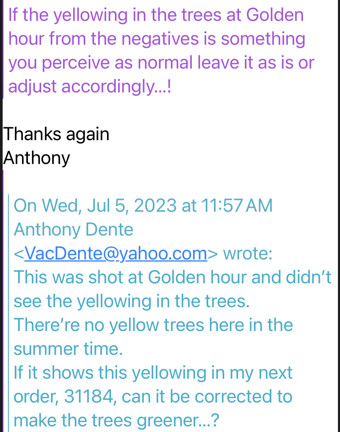

Too much yellow on trees...'

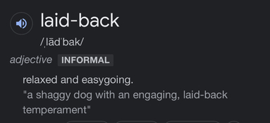

Laid back is opposite of digital hardness…!

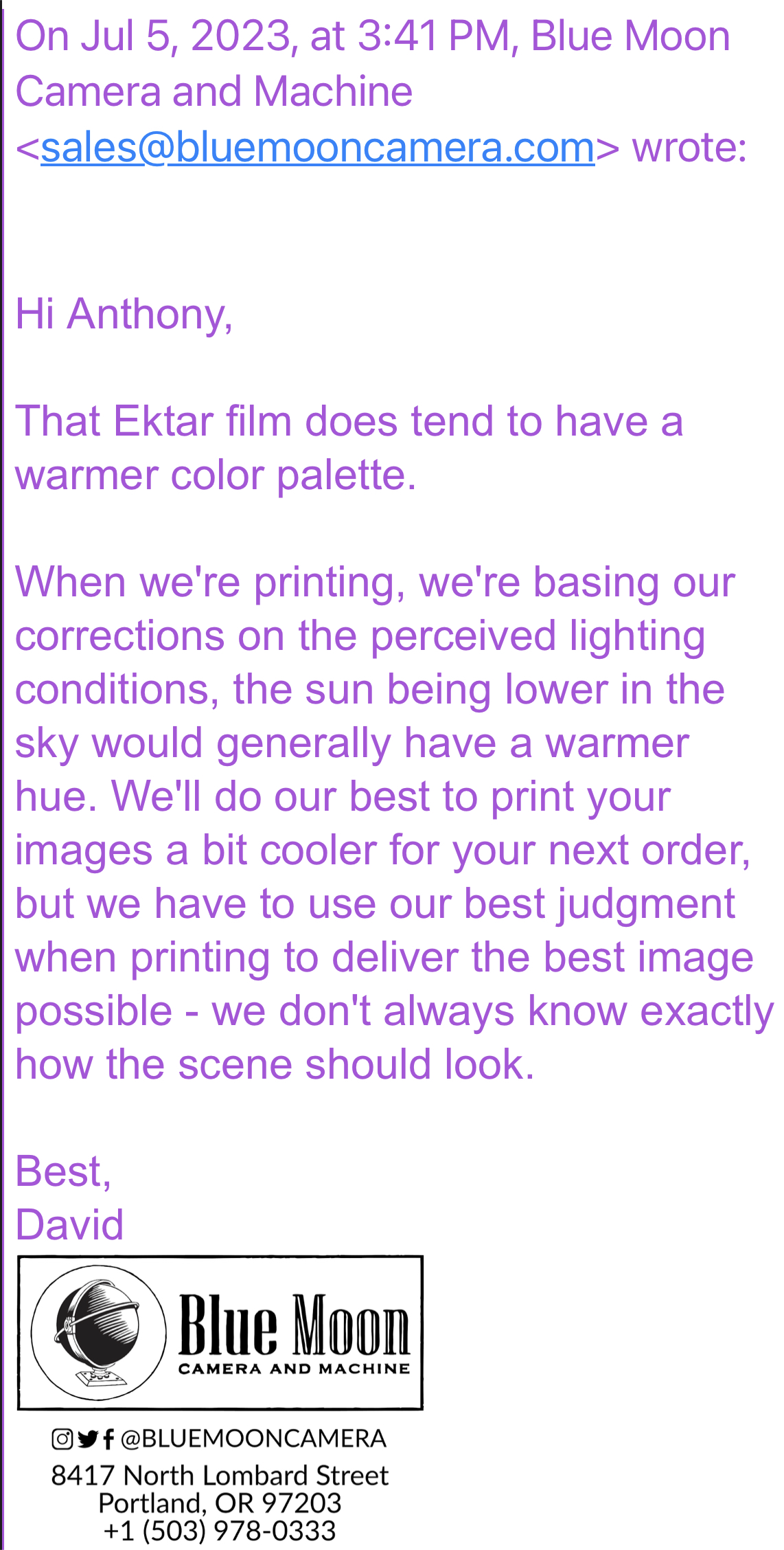

Actually I’m getting optical printing done by Blue Moon Labs using RA4 paper that I compare to the digitally scanned prints from Process One Labs...!
