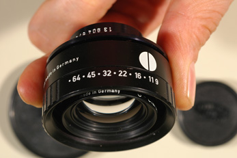

Here is a picture taken from the internet of the barrel that the Tominon 127mm was mounted it... I just happened to find it on a website about enlarging lenses.
In this picture, there is a 150mm F9 G-Claron mounted in the barrel, but mine had the Tominon 127mm f4.7 in it. So I guess that it was an enlarging barrel and just happened to fit a Copal #1 board.

As you also might suspect, things don't just happen. That looks like a Componon Lens barrel, no matter what cells are in it. That should (I think, I don't have my enlarging lens with me) have a M39 thread on it.

Your #1 Schneider barrel is probably left over from a 210 or 240mm G-Claron lens. As you've found out the MP-4 shutter isn't a good solution because of the lack of a diaphragm. For still life's the barrel would actually work very well. MOST of the time we stop down and have enough bellows factor that exposures are in the seconds and minutes so a barrel and lens cap works fine. Also when you are near or at 1:1 the scale on the barrel will actually be correct with no other mathematics. Here's why. Chances are it had a 240mm lens in it to begin with. At 1:1 magnification with the 127 you're at about 240mm anyways. Voila. Just use the scale that's there for the close-ups and make some pics. The quality of macro type work with those little cells is astounding.
