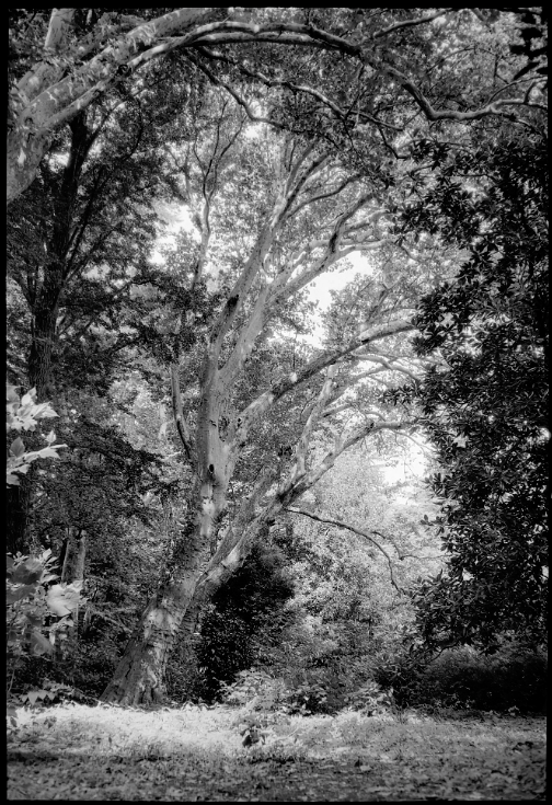

That link has only one photo processed in Tokyo Pyro. I am not sure I see digital processing in that example, but I agree about others. Do you think the Tokyo Pyro example is digitally manipulated too?
That's hard to tell, but what's certain is that whomever chose to edit it this way, opted to set both the white and the black points a little bit away from the actual image density boundaries, making for a rather muted look that has everything to do with a post-processing choice, and nothing with the developer. Frankly, the effect is rather bland to me and an aesthetic I've never really understood, but there's no accounting for taste.
If you set the black & white points at the edges of the image data, you get this:
That still looks fine to me, but the merit here is:
1: Subject matter choice, composition and light (although I'd personally crop it for presentation/printing)
2: Correct exposure of the film used
3: It's medium format, which even presented at a smaller size creates a sense of depth which is helped with the shallow depth of field (see the foreground).
The developer really doesn't do much either way here. It did its job, but there was relatively little it could mess up here anyway.
What I also see is rather poor differentiation in the upper midtones, which could be due to anything, including compensating effects in development. Look at the problematic patch of brightly lit ground cover in front of the tree, and to a lesser extent the foliage in the background. This can also be largely due to the film's spectral response esp. when detail starts to be pushed onto the right-hand side of its HD curve (it's exposed rather liberally, after all).
You can do this with the same film with Xtol, Pyrocat, D23, D76 or Rodinal for that matter.

The second link features a series of IMO ho-hum photos that aren't particularly interesting in any way; they're technically competent captures of urban scenes, except for the apparent problems with uneven development in the first two series (2024-07-26 and 2023-07-30). Pyrogallol developers are often prone to uneven development and require some care in determining an optimal agitation scheme.
opted to set both the white and the black points a little bit away from the actual image density boundaries[...] What I also see is rather poor differentiation in the upper midtones
I agree about the upper midtones, but when I copy and paste the image into Photoshop and look for blown highlights and shadows, I actually see a fair number of clipped pixels at both extremes in the image itself. So I am not sure I agree about the white and black points. I do agree, however, with your remarks about the framing, cropping, going for an aesthetic etc. I think this image is on-trend, although I don't want to read too much into that or the photographer's intentions; it's a pleasing image and I don't think any criticism from me is merited or appropriate especially since nobody asked for it! But back to the topic, I agree that this sample image doesn't show any magic attributable to the developer, and as you pointed out, technically the highlights are actually not showing off a lot of subtlety and nuance where the developer could have influenced the tonality.
Although I'd included that link to a sample photo for completeness (I haven't found a lot of example photos with Tokyo Pyro online), it's actually the photos on the Tokyo Alt Photography website that I thought were particularly arresting. And in some of those, I do think the tonality in the highlights is handled with a lot of grace. Those, too, are scans of prints, which is a much more compelling case for developer performance in my opinion. You can digitally scan a garbage negative and do a lot of magic to get a nice-looking image, but if a print is well executed, there's more to be said about the chemistry.
Wait — I am not sure of that now. I think I was conflating this in my mind with some other websites I'd looked at recently. I retract this. Maybe they're scans of prints, maybe just digital scans of negatives.
This is due to reduced exposure, moving the highlights to a more favorable part of the film curve than they would have landed if the exposure would have favored the shadows more. In fact, a compensating developer (as this would be) is really not that much of a benefit in this regard as it'll smash flat highlight tonality (see example above). So what is really a potential drawback of this developer in this particular case (the white tulip) is avoided by means of judicious exposure.
If I were to put my money on anything, I would say that 0% of the examples linked to are scans of prints and all are scans from negatives. They could be either and I think ultimately it doesn't matter much. Either way, choices have been made in how the negative densities mapped onto the final image as presented. Those choices generally overpower whatever subtle effects the developer has.

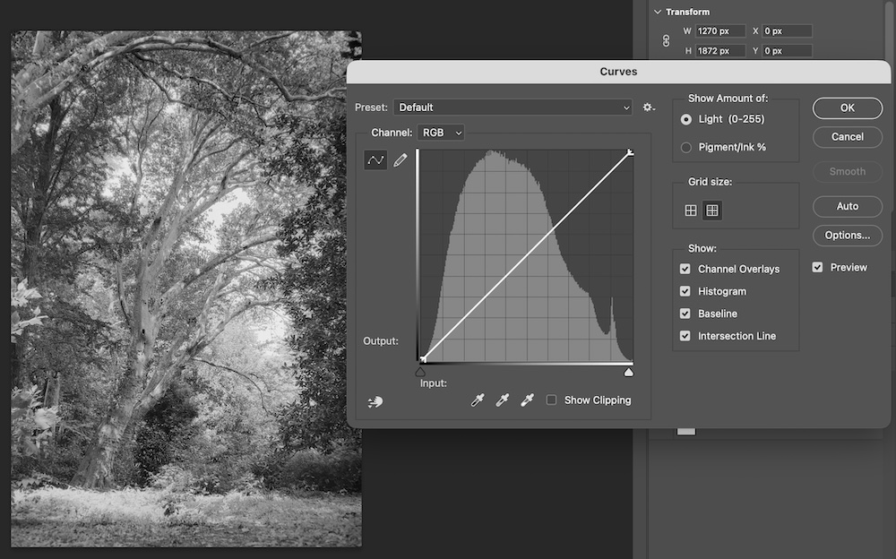

At the risk of going off-topic, I see something quite different in the Ilford sample photo. I wonder what can explain this? I right-click, copy, open Photoshop, new document, paste. Crop, remove the black borders (plus a little margin for safety). Result:
And then, ticking the "Show Clipping" box and nudging the white-point handle to 254, I immediately see clipped pixels. I actually still see clipping at 255. Same thing for the black point. I wonder what explains this difference in renderings between our systems. Default ICC profiles, perhaps? I have often noticed outrageous differences in image rendering in browsers versus image editing apps. I have never investigated to isolate why.
Oh, I don't doubt you're right, but look at those clipped pixels. That's not a really meaningful bunch; it's a handful. Now take an average sample (let's say 5x5 box) of the brightest sky in the background. That comes out at RGB 230 for me, which is a considerable way off of white. Now, there's no law anywhere that says that a part of the sky in an image like this should be pure white. Heck, there's a lot to be said for having it inch back from pure white just a little. But to my eye, the image as it's presented on the Ilford site is a little flat, and that's due to an again in my view artificial compression of the tonal scale, that's not attributable to the actual negative, but purely a choice (or accident) in digital editing.
Also, if you look at the distribution of those pure-white pixels, I have a very strong suspicion they do not represent actual image values, but are the result of sharpening applied to the digital file.
Note also that a dramatic contrast enhancement of the highlights (basically pulling the upper midtones down to dark grey) leaves no differentiation in the highlights. There's just no image information there. The histogram is just squished a little esp. on the highlight side. I see no clear reason for this.
I concur with all of that; but your histogram shows significant flat areas at the black and white ends, which mine doesn't. I don't know how to explain that.
Must be something to do with how Photoshop constructs histograms. There might be a setting in the preferences somewhere that controls this; it seems like it normalizes image data before building the histogram. I've long ago stopped using Photoshop so I can't comment any further, but this is what I'd expect.
I've taken your screenshot and put it into my GIMP and the highlight measurement is the same, so I think we're looking at the same image data. If there were a difference in ICC profile interpretation, this would translate into the screenshot as well. Given that the images look pretty much the same, that can't be it and it must be a mathematical artifact related to histogram construction.
