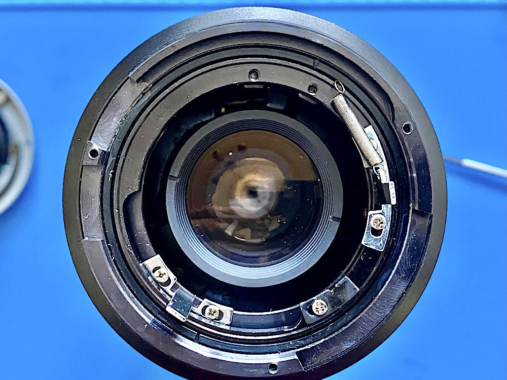

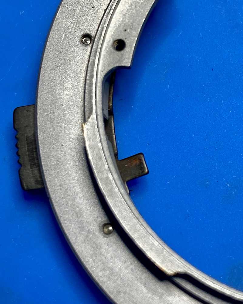

Removing the bayonet ring

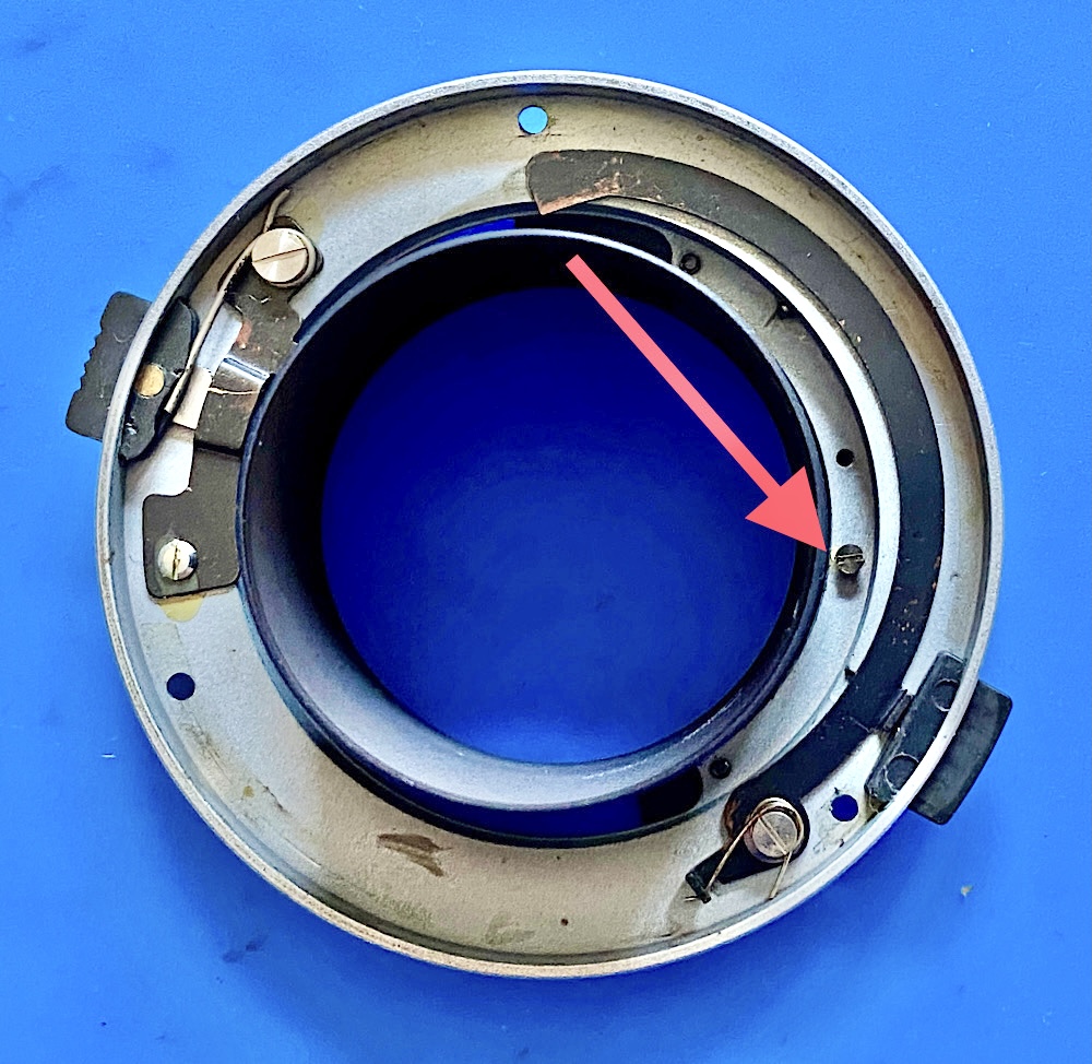

After loosening the three bayonet ring screws, this spring connects the ring and tube.
It needs to be unhooked.
Under the bayonet ring
Bayonet ring removed, the arrow points to the spring retaining screw.

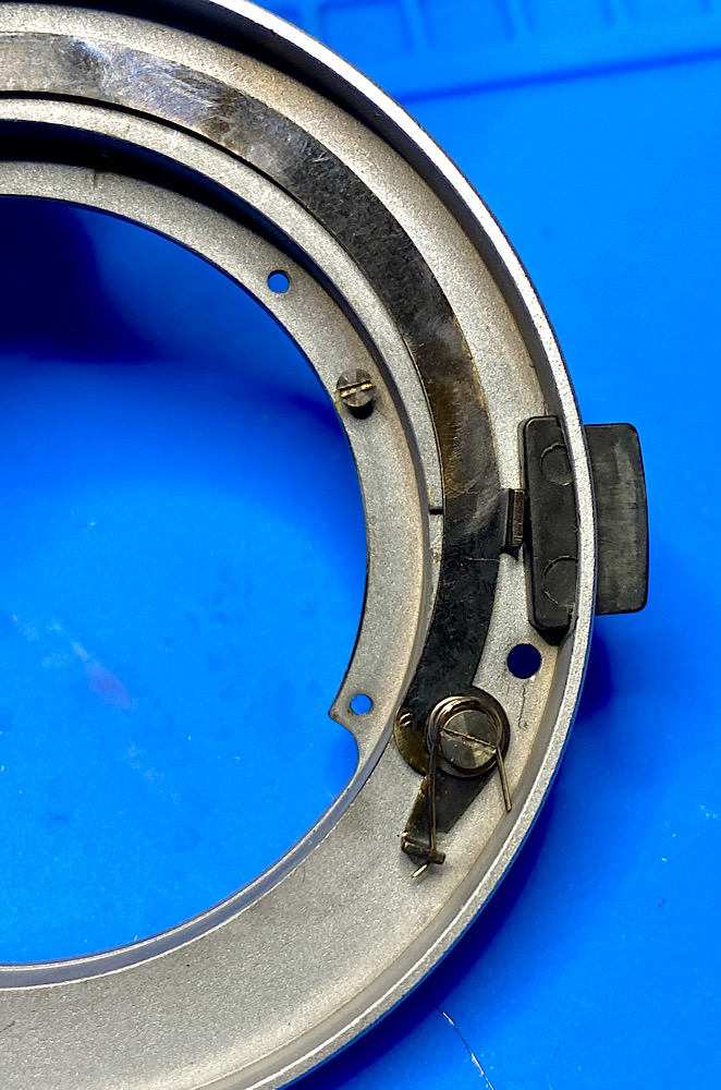

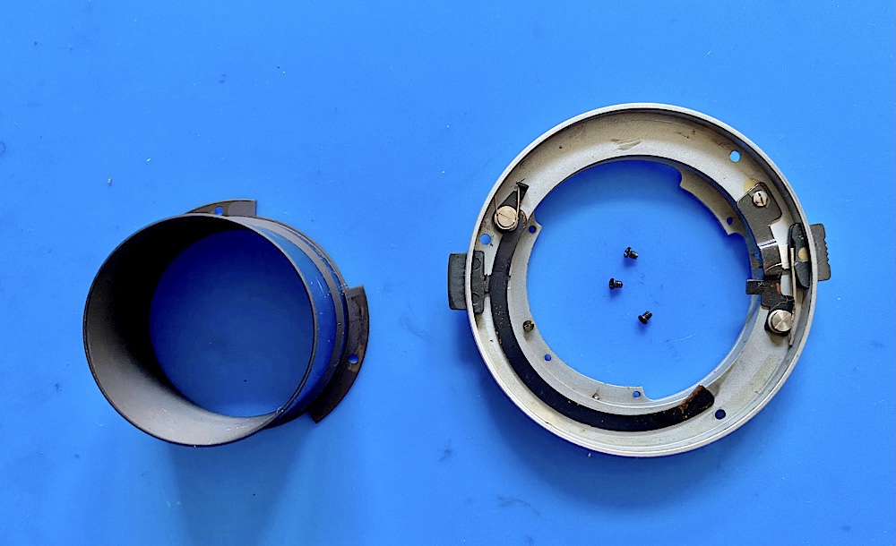

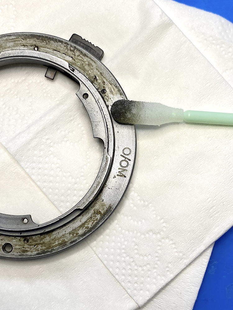

In order to be able to clean the ring more effectively, I remove the hood to the rear lens.
Zippo lighter fluid cleans things up.
Minor areas of rust ...
... which the Dremel Stylo with an attached stainless steel round brush takes care of.
Where the Dremel can't reach, the files take over.
Slightly rusted areas can still be seen deeper in the tube.
I don't want to dismantle the lens any further.
So I apply some Ballistol Universal Oil to dissolve the corrosion and protect the areas.

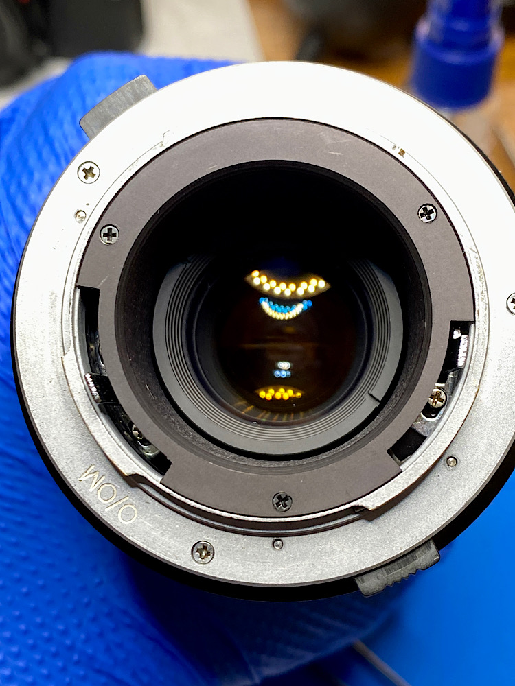

That's all folks - assembly!
After having tried unsuccessfully to attach the spring to the bayonet ring with a probe and tweezers, I came up with the simple solution:
Simply hold the ring over the tube and pick up the spring with the small retaining screw.
The hood pushes the spring to the side.
Now the tension of the spring is correct and the aperture blades close completely.
After mounting the hood, there is a problem when I press the stop button on the lens to set the smallest aperture.
I use the probe to lift the spring a little and now it fits.

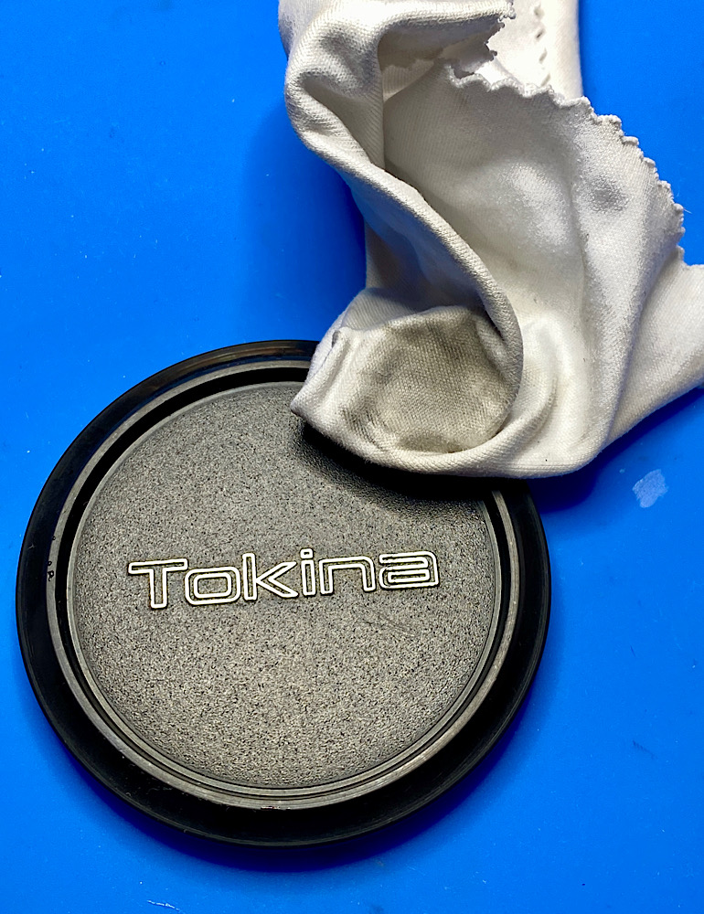

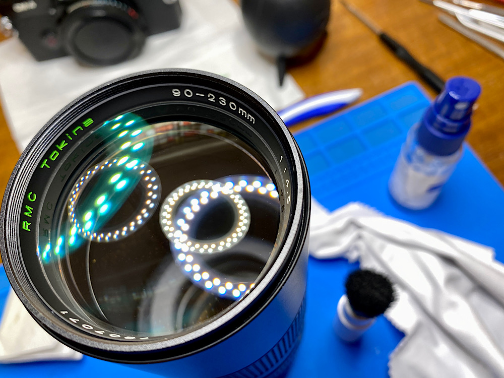

Cleaning the front and back lenses.
Aqua Purificata removes the dirt from the front cover.
Clean
Everything works, the focus adjustment is correct.

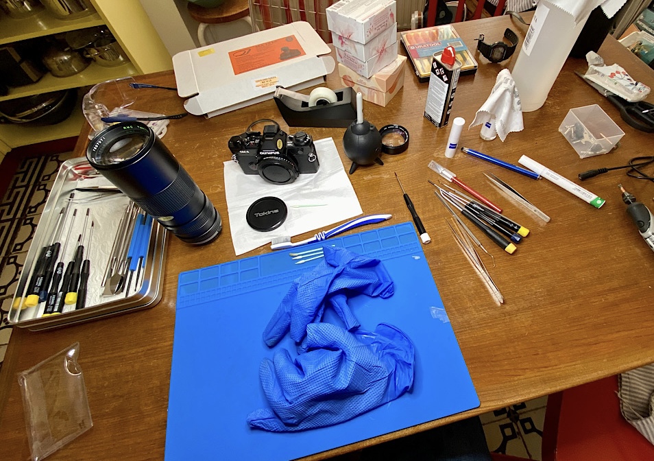

The table always fills up quickly 😉
