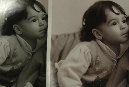

I think it depends on the paper/dev combo used as well. A cold-tone developer should help in restraining the tone shift, even when toning is complete.
I tone using Paterson selenium 1+4 to completion (about 10-15 minutes)
ILFORD MG neutral and cold show almost no changes IMHO. The "greenish tone" is gone, and the cold tone becomes a tad bluish. Shadows deepen a little.
AGFA MCC/MCP paper shows more tone shift when developed in Ethol LPD 1+3 than 1+12. The tone is deep-purple and "creeps" from the shadows up. (see attachment)
ILFORD MG-WT shows a very similar behavior to the AGFAs
Ian Grant said:
Toning for permanence in Selenium will be barely noticeable, toning for effect of course will, the differance is the dilution and times involved.
Most manufacturers will give instructions for both.
