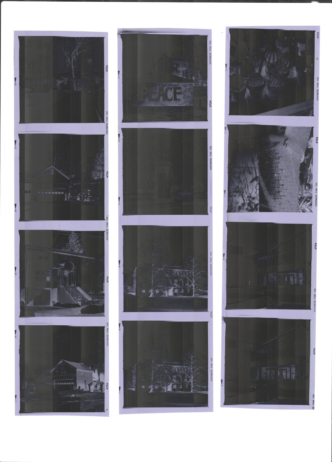

Well... developed the test roll from the Hassie. I have comet-like leaks on two frames, not too far from one another, and all of the exposures are sort of smeared at the tops and bottoms and the frames have a visually mild "trapezoidal" quality to them. I haven't witnessed this before when I was using the Hassie back in 2019. I vaguely recall seeing something similar to this effect many years ago when viewing over some of my grandmother's old 127 negatives, where the exposed frames do not look perfectly squared out.
I included a scanned example showing the shape of the frames. Because I am using a flatbed scanner there is no light over the bed to illuminate the strips so that the images could be viewed so I do apologize for this. I would have liked to have shown the two frames that have the comet-like trails in them but I can later make a contact sheet. Before I scanned these in I thought my eyes were playing tricks on me while I was cutting up the strips. I'm thinking the leaks may have extended past being comet-like and has spread itself around a good segment of the outer area of the film square to give such a distortion.
New plan: First I will buy a light trap seal kit and do the sealing myself and see if this fixes the problem. If the sealing kit helps the situation then I can relax a little and hold off on repairs for the other film back and for the servicing of the body. This would give me time to save up some extra cash for this. If the sealing kit doesn't solve the problem then I will promptly draft up a letter to the repair shop and ask questions about their services. Depending on cost I might be able to only send out one piece of the equipment at a time. Send one film back then later the other then look into getting the body looked over, CLA'ed, etc. I don't mind it taking some time. I do have my Rolleicord so it isn't the end of the world.
I will have to get in touch with the maker of that sealing kit because there is apparently an extra foam piece that is not shown in the preview image on his product page. I recently viewed a Youtube video of someone showing how to clean out and replace the seals and there is an extra thinnish long piece of sticky foam that goes onto the inside channel, dark slide end, of the plate that comes off from the magazine. From looking at that video it looks like that extra foam piece is needed.
On a good note: I am really enjoying the D23 negatives. I also saved 100% on car insurance because I don't have a car.
I will be saving some samples of those black specks that I have been getting after developing and put them to the side. After souping this last negative the specks just stayed at the bottom of the graduate while I was using the new strainer. I had to use a q-tip and swab the bottom of the graduate to get at them and place them on some tissue to dry out. I bought a strainer for nothing, lol. Funny how using the mix for the very first roll and nothing happens and then after that it does. Doesn't affect the film at all so that's a good thing. I think it is the chemicals that I got. Maybe they weren't all that hot. I am waiting for an order from Artcraft so things should be better.

@What About Bob -- it looks like your light seal is fine, since there is no edge fogging of the film. When light leaks in through the darkslide slot, it fogs the edge of the film and "sprays" across to the other side. I have no idea what's going on with your film (namely, the odd shape).
I'm clueless. I will have to do up a contact sheet later on and post that example up to show the comet effect. I haven't been to bed yet. I'm thinking too much about this. Between this and the black specks I'm totally clueless.

Bob, are you loading the film UNDER the silver clamping bar?

Hmmm, this is a weird one. As Brian mentioned, are you sure the film is *under* the silver clamp? It's on the same side as the twin notches, and they should be a bit more sharply defined than they are on your negatives, which means the film may have not been in the proper plane in that area--which would happen if it were riding above the clamp, very likely.
Now, that bit on the upper right corner of your frames that's been cut off appears to be because something is blocking light from hitting the film there. (The rest of the image area on those frames looks fine, mostly; the fogging in the lower left corners of many is a bit puzzling.) I would think a possible cause for the upper right, if you loaded the film correctly, is that your light seal has broken at the fold, and a bit of it has pivoted and slid inwards into the image area, and is what caused the obstruction--I had exactly the same thing happen once on an old back I purchased (but it was even worse), and once I replaced the light seal, it was fine. (A break in the light seal could also explain the comet effect you mention.) It *is* a bit puzzling that it's at the top of the image rather than the side opposite the notches (where the light trap is). Check the bottom right corner of the image area on your back, and see if something is jammed up under the roller or something--could be a bit of the light seal, it also could be a bit of the tape used to seal a roll of film after shooting it that's come loose, maybe. (I've seen that before, too.)
Replacing the light seals is super easy. It'll take you 15 minutes to do the first time, less than half of that afterward. I buy mine from Dick Werner (blackbird711 on eBay), as he makes a good product, it's reasonably priced, and his directions are superb and copiously illustrated. When I lived in London, I used to buy his kits when I came back for a visit in the US, and replace the light seals for my second-hand dealer and his customers over there for a number of years. (Given your comments, you might find the 45 bucks for his repair manual quite a good investment, too.)
I think at this point, you should (1) check your back as I mentioned above and make sure there's nothing trapped where the frame is being cut off (lower right corner as you look at the camera mating plate on the back), (2) ensure that you are loading the film properly and that it stays under the silver clamp on the crank side of the insert when you put it into the back, and (3) replace your light seal, which should be done regularly anyway. I would think doing those three things would *likely* solve the problems that are currently affecting your images. Really, once you have a play with the inside of a back you'll see that the mechanical bits aren't that complicated either--but right now, you shouldn't have to fool with those at all, as your frame spacing is pretty much perfect. Overlapping frames (particularly 1 and 2) or irregularly spaced frames would be a symptom of a mechanical problem, and I don't see any in evidence there.
I would be fairly certain that if you do the three things I mentioned above, your problems *should* be solved. Let us know!

The irregular negative shape is an indication that the film back itself is out of alignment. It needs to be placed in the Hasselblad tool jig [by a Hasselblad trained repair man] and adjusted and realigned to factory specification. I have needed that done to several film backs that I had inspected just after I purchased them.

@BrianShaw and @rulnacco - The film went under the side clamp before inserting the holder into the back.
You mentioned about overlapping frames. My Rolleicord does this once in a while. I bought it off of eBay in 2019. It was CLA'ed. Just don't know when.
I will go over those three things you mentioned. Tomorrow I will get a set of precision screwdrivers, plastic and metal angled tweezers, and some extras.
Does that seal kit that Dick sell have that third sticky foam piece? I didn't notice this extra piece shown in the product image on his page. This is the piece in question:
I was thinking of buying two of those kits but the second film back that I have has more issues going on with it. The side winder hesitates at times and counter doesn't ever get to #1. The inside recessed gear inside of the film shell that accepts the insert's spindle nubbie from the take-up spool when putting the insert in; that part is turnning counter-clockwise. There is a tiny black spike thing in the shell that goes halfway into the insert. I thought that nay have been to reset the counter but it may be for something else. I want to get to know all of this stuff.
I will get back with everyone about this. When I get the screwdrivers I will remove the plate and at least see if there are any obstructions of any kind. My thinking is that the foam is going to be on the crumbly side. Thinking along the line of those old 8-track cartridges where the foam underneath the tape disintegrates eventually..
Thanks guys

@Sirius Glass - Oh. This changes things then. If the backs need to be sent out I may as well hold off on buying the light trap seals and just have whoever does an alignment service redo the seals as well.
Thanks for letting me know this.

I would *still* replace the seals yourself--first. Why? Because it's extremely easy to do it yourself--and it's way cheaper than having someone else do it. And if it *does* fix your problem, you don't need to go through the expense of having more work done to the back. It does need to be done occasionally, and eventually, you'll want to do that simple bit of maintenance yourself--saves money and time. So why not learn how to do it, when it is quite simple?
If the back *is* out of alignment, your next difficulty is finding a repair place that actually has the proper tools to fix it. Those jigs ain't cheap or common at all, and I'd expect that a lot of repair places don't have them. (David Odess, who surely did have one, passed away not so long ago, so other than Hasselblad itself, I'm not sure just who would have one.) So again, I'd try the *easy and cheap* fix first--and, if that doesn't work, go on to the more complex and expensive repair. Basic troubleshooting, really.
Dick's kit doesn't have that piece of sticky foam/felt--but I've never replaced it on any of my backs, and I've never had any problems from it. I'm not saying you absolutely should ignore it, but it's probably one of the less likely sources of problems if you don't replace it. I'd just give it a bit of a brush to clear off any gunk, and be done with it. If it does bother you, then just buy someone else's kit that includes it.
Your second back does sound as if it needs a bit more work--but it's likely to be simply a little CLA, with the emphasis on the L--lubrication. The oil and grease does dry up/migrate out of place/attract gunk over time. If your counter isn't resetting properly, it *could* be a broken/displaced spring, but I'd be more inclined to think it just needs a bit of cleaning and oiling.
If you were close by me (I'm in Mississippi), I'd tell you to just bring it by and let me have a look at it, and I'd show you how it all fits together and functions--and in probably less than a half hour, we'd likely have it running perfectly again. (As Dick points out, with his repair manual, you can correct *most* things yourself--and save tons of money in the process. Unfortunately, re-aligning a back, if that's actually necessary, is *not* one of those things.)
