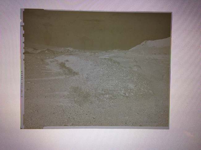

The photo is of freshly-processed T-Max 400 4x5 sheet film. It has a very high, bluish-tinged base fog that will likely be difficult to print though.
I'm just trying out this film. However, my film speed and development tests did not exhibit this bluish base fog. I did not expect this at all.
I'm wondering what happened and if there is any way to remove the tinge/fog. Note: this is not the normal pink tinge that is common on many of these films, and with which I am familiar.
Here are the details:
The film is relatively fresh and has been stored together with boxes of 320Tri-X purchased at the same time. The film was shot back-to-back in holders with the 320Tri-X. Both films were stored alike and processed together. I'm not sure of the actual expiration date, since I don't have the film box at hand, but I am fairly sure it is not outdated.
The negative I posted below was actually processed together in the same trays of chemistry with sheets of 320Tri-X (my standard film) that came out just fine and just as expected. This effectively rules out processing problems. Other sheets of TMY processed separately also exhibit this bluish fog.
Developer was PMK after a 3-minute pre-soak. I used a citric-acid stop bath at the recommended dilution. The negatives were fixed in Ilford Rapid Fix 1+4 in a two bath regime for 8 minutes total; 4 minutes in each bath. The fixer was freshly-mixed and this was the first batch through it (5 sheets only). The film was washed for 30+ minutes with running water in an archival film washer (together with Tri-X sheets that are just fine). (I don't use a wash aid with pyro negatives, as it removes the stain.)
I've searched here but come up with little information on this problem. Again, storage was at room temperature (no extreme heat, etc.) together with other films that exhibit no defects whatsoever.
The photo below is a quick iPhone photo of the wet neg plastered on my computer screen over a blank Word document. The blue tinge doesn't show that well, but in real life, it is definite.
Any ideas?

Try re-fixing - TMax films need a lot more fixing than 320 Tri-X.

Thanks Matt, I'll try a longer fix, but suspect that it won't help much. Eight minutes in film-strength Rapid Fix should be enough. The film was clear in two... I fix 320Tri-X for significantly less time.

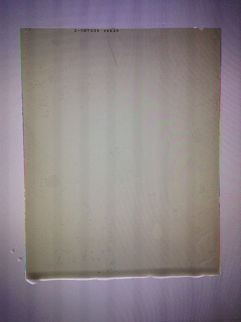

Update: Another 10 minutes in fresh fix did not help. I'm trying an extended soak in distilled water with PhotoFlo now.

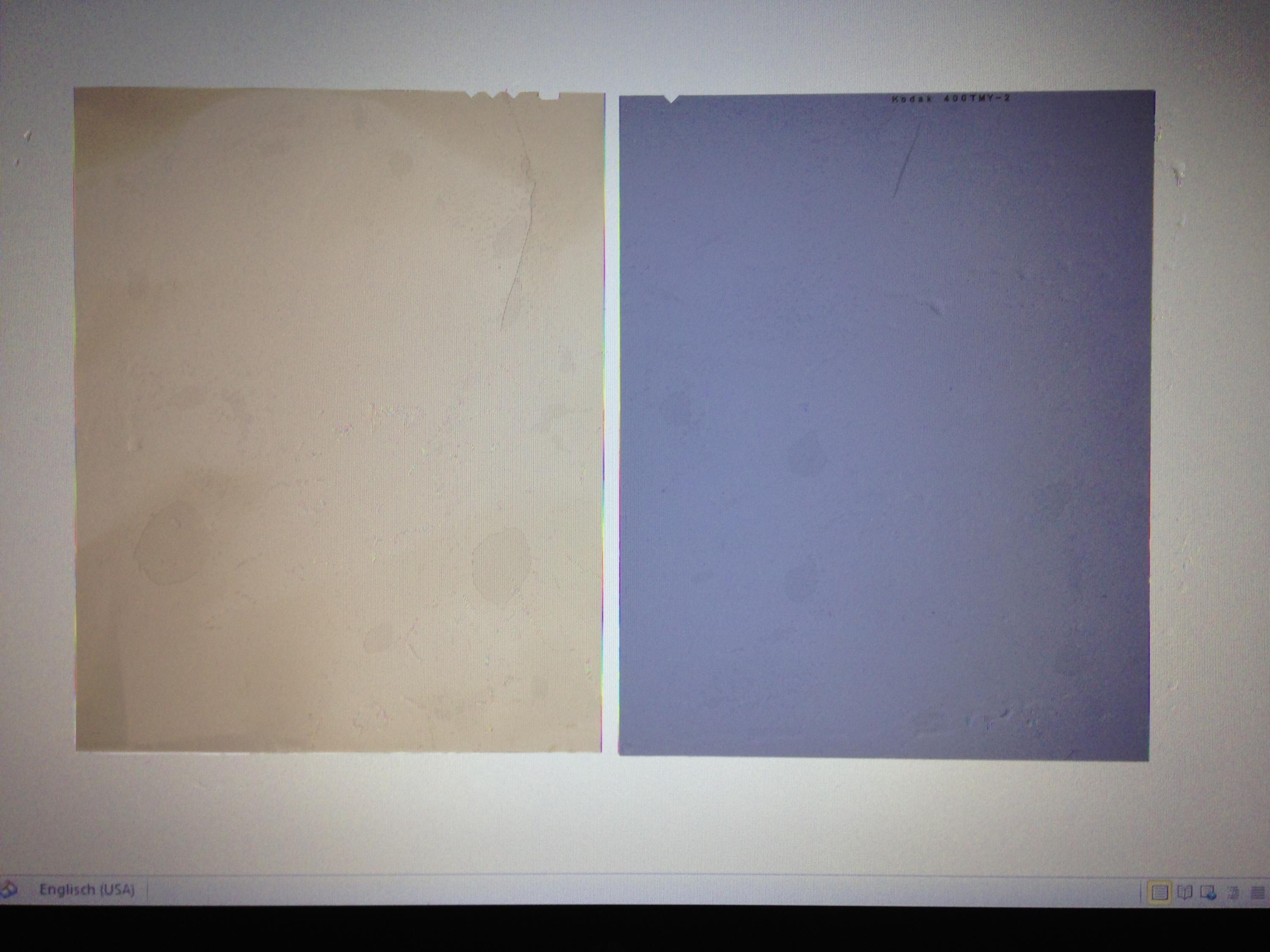

Me neither, and not with my tests, as I mentioned. That's why this has me stumped. I'll try a plain water rinse after the developer for the next batch and see if, for some crazy reason, the citric acid stop is the culprit. That's the only variable that has changed since my tests. I'll update in about half an hour.
Doremus
Okay, here's the update: Plain water rinse instead of the citric acid stop didn't help.
I mixed up fresh fix (Ilford Rapid Fix 1+4) and fixed an unexposed sheet of the suspect TMY. I also fixed a scrap sheet of Tri-X that I had lying around. It had seen a lot of light, so some of the fog remains, but, in the photo below (again, with my cruddy iPhone camera against the computer screen) you can see the difference in density. The TMY is definitely darker and bluer. Interestingly (or distressingly in this case...) the TMY fog does not seem to exhibit much grain when viewed through a 10x loupe (really, none that I can see). It looks much more like resudual dye of some kind. However, a drop of rehalogenating bleach (ferri and pot bromide) leaves a marked clear spot...
I did clip tests on my fresh fixer. It clears Tri-X in just over 30 seconds and TMY (to as good as it gets, that is) in under one minute. It seems to be good; no sulfur smell, just a bit of acetic acid odor. Nevertheless, I'm going to pick up a bottle of fresh fix to test against just in case. That won't happen till Wednesday now.
I've never seen so much fog even in very old films, and this TMY is fairly new. If outdated at all, it would only be for a short time; less than a year.
I'm still interested in salvaging these if possible. Any more suggestions?
In the photo, the Tri-X is on the left, the suspect TMY on the right.
Thanks in advance.

Try using some acid fix or a sulfite solution just on the acid side so you smell sulfur dioxide. If this does not work, and you have some handy, try some blix.
If the acid fix or sulfite clear the film it is retained dye, if the blix clears it the film has retained some antihalataion material for some reason, and I will look into it.

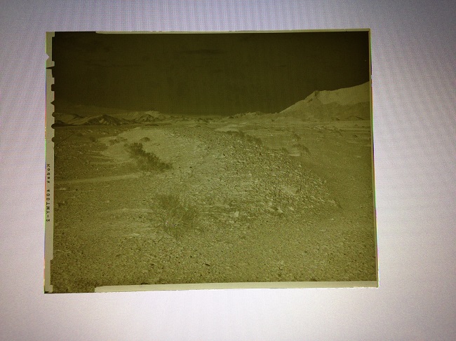

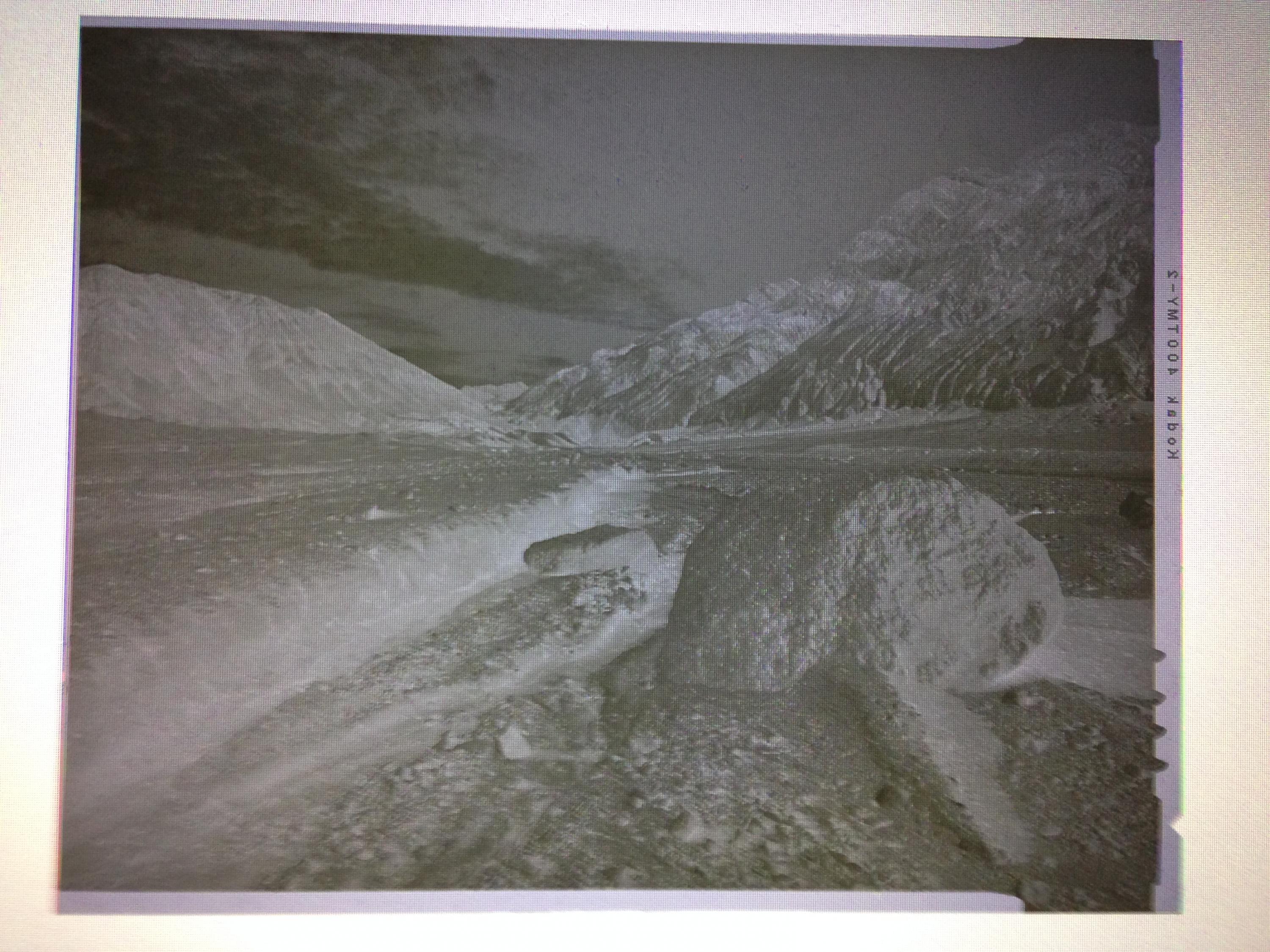

Update - Problem Solved
Apologies for not getting back sooner. Here's the update and the good news.
I developed the rest of the batch (~20 negs) with new stop and fix. The most acidic fix I could find here in Vienna was the Tetenal Superfix (pH 5.2). Short version: no difference, all the TMY negs had a marked increased blue base density. Tri-X negs developed together in the same developer were just fine.
Since PE recommended blix, which I don't have, I decided to try a bleach/redevelop with a standard rehalogenating bleach of K-ferricyanide and KBr. Photos of the results are below (again, iPhone photos against my laptop screen). In summary, the bleached negative still exhibited the increased blue base density (first photo) along with a pronounced stain image from the PMK (the photo shows a bit more image than was really apparent to the naked eye). However, after redevelopment (second photo), the blue cast had disappeared and the negative looked normal for a PMK neg bleached and redeveloped (I use this technique occasionally to increase contrast).
Thinking that it may have been the alkaline environment of the developer that got rid of the stain, I mixed a weak Sodium Metaborate (Kodalk) solution using the B part of the PMK mix and immersed my blank test negative (see photo above, the clear neg was quite blue). Almost immediately, the dye started to disperse into the alkaline solution, resulting in a very magenta cast to the solution and eventually in a clear negative (photos 3 and 4).
I have since tried other alkaline solutions with equal success, but slightly varying speeds of clearing the dye. Sodium bicarbonate is the slowest, a weak sodium hydroxide solution is faster and the resulting color of the solution is markedly bluer and less magenta. (Note: I only had household chemicals to work with, baking soda and drain cleaner, no sodium sulfite, which might have also cleared the negs).
So, it appears that an alkaline bath does the job for removing the dye. I'm not sure why the dye did not come out during the initial development though, since the very same developer did the job after fixing and bleaching...
I am in the process of treating all the affected negatives as described above. All the solutions that I've mentioned are in use and doing the job just fine. The dye (which I now suspect is a sensitizing dye) continues to disperse in the wash water.
I still have no idea what the cause of this was and what the mechanism is that fixed the problem. I would love to hear an analysis from the experts. Nevertheless, I'm happy I found a way to salvage the negatives and look forward to printing the best of them this summer. And, I'm confident I can use the rest of the box of TMY, even if the same problem crops up.

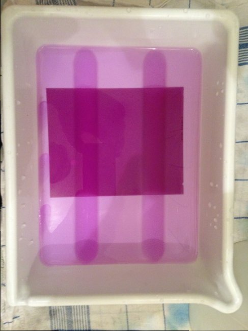

I'm resurrecting my old thread with an update:
I have in the last year developed several more batches of TMY in 4x5. Every single time I have the same results: excessive retained dye of some kind which significantly obscures the image with a dark blue hue. TXP developed in the same chemicals (and even together in the same batch) comes out just fine. The extra dye seems to be made soluble after fixation by bathing the negatives in an alkaline solution.
I now have a routine to deal with this. I return the negatives to the developer for a couple of minutes after fixing and rinsing, then another rinse and into a weak bath of sodium metaborate (about 5g in 500ml) with agitation for 4-6 minutes. The resulting negatives are fine; the metaborate solution turns bright pink/purple (see the photos from the first time above).
I still have no idea whatsoever why this is happening and what changes I could make in my processing to prevent it.
For reference my workflow is:
1. water pre-soak in tap water for 2-3 minutes. (The pre-soak water is always dark blue with dissolved anti-halation dye after soaking.)
2. develop in PMK anywhere from 9-15 minutes. (The developer looks normal after use; i.e., dark brown.)
3. stop in either a citric acid or acetic acid stop, half-strength. (The stop doesn't change color except for some browning from dev. carry-over)
4. two-bath fix in Ilford Rapid Fixer diluted 1+4, 3 min./bath (at this point, the TMY negs are dark blue, my TXP negs look great...)
5. The stained negs get a 1-minute rinse and then get returned to the developer; the stain starts to lighten. (TXP goes to the wash).
6. The stained negs get another rinse and into the metaborate solution. Staining disappears within 6 minutes. The negs then get rinsed and into the wash.
I never heard a peep from Kodak; I'm hoping the community here can help me figure out what the problem is. I thought it might disappear with a different batch of film, but it hasn't.
Any ideas?

FWIW, returning the negs to the developer was just to get them quickly into an alkaline environment. I've used spent developer, sodium metaborate, sodium hydroxide and even bicarbonate of soda; all work fine to remove the stain with the more alkaline solutions being faster.
The stain visible on the negative is dark blue, but lightens to magenta as it soaks out. The solution turns a brilliant magenta after a few negatives. It looks similar to the anti-halation dye. However, my pre-soak is completely dark with anti-halation dye so I can't imagine that more is being retained in the negative through the entire process, even if the film were inadvertently double-coated with anti-halation backing. Coupling dyes come to mind, but I'm not sure. And, like I said, TXP processed in exactly the same way comes out just fine.
After "dye removal" in the alkaline bath, the TMY negatives are just fine too. I'm just stymied about the dye retention and would really like to avoid the extra step.
If no one else has observed anything like this at all, it must be isolated to me, my boxes of film or something specific to my processing. I just can't figure out which or how. The fact that an alkaline environment releases the dye must be important, but my knowledge of how anti-halation and coupling dyes work and/or could go wrong is nil. I'm hoping one of the chemists here might have an insight.
