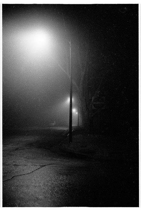

I just shot a roll of night fog shots on TMY. I have Rodinal, D76, and Diafine developers. Can anyone give me times for development in any of those chemicals? I'd really like to use Rodinal if I could. Checked the Massive Dev Chart, too, just so you know. Nothing on TMax 400 at 1600 for Rodinal.
Edit: I just saw that the time for Rodinal 1:80 was 16 minutes for ISO 400. Would 32 minutes be a good starting point for ISO 1600? I know that I'm most likely going to get some *large* grain with this...I want to see how it affects the film.

Went 32 minutes. Could have used a bit more. I think that the next time I do this I'm going with 36 minutes. I went with Rodinal 1:100 and three inversions every other minute. I'll post the results I got when the negatives dry.

To estimate a good development time for a situation like this, it's important to know the character of the scene: low light but low contrast, low light and high contrast, that sort of thing. Importance of shadow detail vs highlight, etc.
I'd have guessed the time you used would have been good for holding important highights.
The nature of Rodinal is to be about a stop slower at the deepest shadows than D-76 1+1. "Pushing" in Rodinal will always make the deepest shadows empty, which may or may not be good. D-76 1+1 will give you a stop more shadow speed. XTOL, even more.
When I want to simplify a composition, by increasing the contrast of the midtones against the shadows, I go with Rodinal. If the shadows are important to the story, Xtol or D-76 1+1.

I know you don't have it on hand, but my best results for TMYat EI 1600 have been with XTOL 1+3 for between 19 and 20 minutes at 68 deg. F. XTOL gives slightly better shadow detail than D-76 and Diafine isn't good for much of a push with this film. Rodinal is best used with slow and medium speed films and is not a very good developer for push processing.

Another good choice would have been Microphen. I've seen surprisingly good results from this from one of the photo.net B&W film moderators, Lex Jenkins. You can do a search for him there.

Rodinal with decreased agitation can really get you places with TXT in particular. Of course, the question is again the lighting situation. Merciful's does not _look_ like a particularly contrasty shot. I might be wrong, I'm just saying what it looks like.
I've taken TXT out to 3200 in what I would call contrasty situations - walking around the street at night - with reduced agitation and am impressed with the results.

She has a link to the resulting photo. This is my _personal_ opinion (she and others are happy with it), but I think the very high contrast scene and absolute absence of significant shadow detail just aren't to my taste. I would personally not use this combination.

THe next shots will be done on TXT. I was just curious as to how this would work so I did it.
To tell you the truth, I think I didn't quite get it developed long enough. I was guessing. There ARE no times for TMY in Rodinal 1:100 on the Massive Dev Chart and I could find nothing in a Google search to give me much more of a clue. I took the 16 minutes for 1:80 that the MDC had and doubled it...I think I should have doubled and added four or so more minutes. This is just my hypothesis, though.
I may take two cameras out and do both TMY and TXT in the same conditions tonight. It may shed some light on whether or not I got quite the right times.
So that you can all see the photo without going to RFF, I've attached it.

More development would not have give more shadow density. That's what Rodinal does: raises the midtones and highlights, but not the shadows.
TMY is MEASUREABLY better for this than Tri X.
D-76 1+1 is better than Rodinal, at any dilution, for a two stop push.
XTOL 1+1 is better than D-76 for a push, OR MICROPHEN OR ANYTHING ELSE.
This is a really simple thing to do with contemporary materials.

1.) Rodinal, compared to D-76 straight, is about 1/2 stop slower in the lowest shadows. From the middle shadows and higher, the curves match, and Rodinal extends a straightline beyond the D76 shoulder.
2.) D-76, diluted 1:1, for clever photochemistry reasons, INCREASES the shadow speed by another half stop over straight D-76. It also is a bit sharper than D-76 straight. These are the reasons it has been the Photojournalists Soup of Preference for decades.
3. ) So far, either version of D76 pushes film better than Rodinal. With D76 1+1 you're a stop ahead already ! Developers like Acufine and Microphen are '50s era phenidone developers that, while similar to D76, because of phenidone's neat qualities, adds a third to half a stop over plain, and diluted, is a little faster than D76 1+1. But it lacks some of D-76's elegance ( in 35mm ) and has not been as widely loved. Loved well by some, but not by everybody.
4.) XTOL is a phenidone/ascorbate developer ( callinng mr gainer ! ) that finally beats D 76 in all respects ( OK, some folks don't like it with old tech films, but I do ! ) It is even more efficient than Microphen, and elegant like D-76. SO, 1+1, it gives more shadow speed than D-76, Microphen, or anything else. And it IS at its best with TMY.
5.) EI 1600 is ducksoup for XTOL 1+1 and TMY. Compared to Tri X (which I have loved well for years ) TMY has less granularity ( an objective quality ), higher resolution ( also objective ) and a higher MTF ( also objective ). The kicker, for me, is that pushed Tri X has a shoulder which tends to block high values. TMY does not. This simplifies both printing and scanning immensely. Check the Kodak publications to verify I'm not inventing this.
6. Kodak has published every conceivable time and speed for XTOL and every film.
Good, clear, objective qualities for XTOL when it comes to pushing film. Second best, D-76 1+1. And not bad at all.
