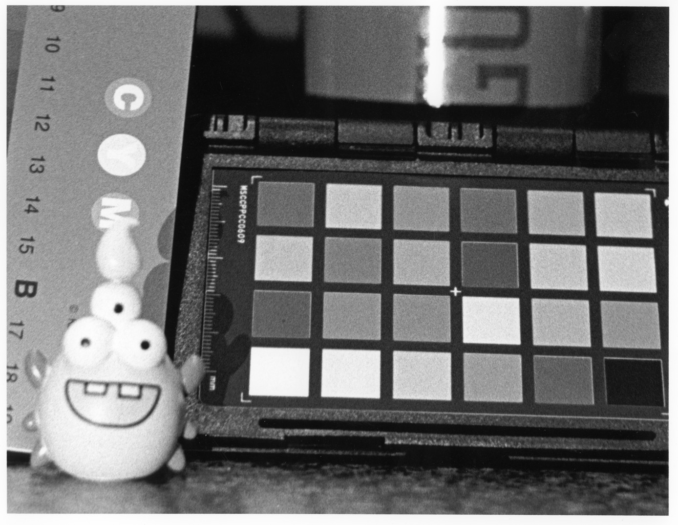

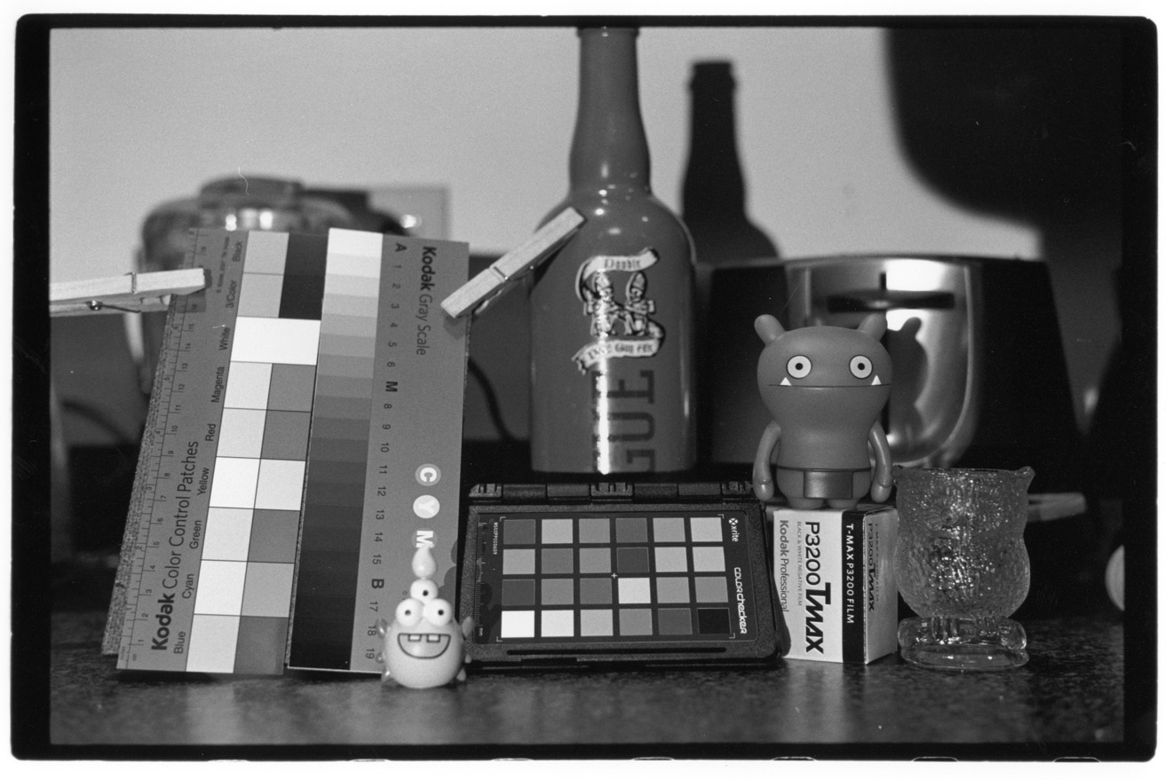

I finally got around to comparing T-MAX 400 with Tri-X. I shot some color charts, a gray scale chart, and some other trinkets. I developed in XTOL 1:1.
TMY was noticeably sharper on the finer details and a bit less grainy. I think Tri-X's large details look a bit sharper - the black print on the Kodak chart for example. A bit more contrast in the midtones? However, with a modest enlargement, it becomes clear that they aren't as sharp.
While TMY did have a bit finer grain, it doesn't make Tri-X look like a grain fest or anything. In the 8x10 print, Tri-X looked grainier mostly in the solid tone of the background wall.
The tonality of both were fine. The TMY looked slightly underdeveloped (my first time), but it printed just fine - shorter printing time than the TX, but the print exposures look pretty much the same. Oh yeah, and TX looks to be more sensitive to red compared to TMY. At least in this test.
TMZ shot in this same situation at 800 was significantly grainier. The difference between TMZ and the other two was far larger than the difference between TX and TMY. It was also interesting to see that TMZ was more or less as sharp as the TX when it came to small details.
I will say my prints aren't *exactly* matched, and that surely influences the outcome. For example, the last couple dark tones in the Tri-X picture look more compressed than in the TMY picture. I guess this is partially due to the toe in Tri-X, though could be influenced by my printing. And if I need to tweak my dev time of TMY up a little bit, that would give a bit more contrast in the midtones.
I'm kind of confused why people make such a big deal out of the differences of these two films. I didn't find TMY particularly hard to shoot or process. And if no one had told me, I'd probably have a very difficult time looking at either print (without looking at the fine detail up close) and saying which one was TMY or TX.

Whoops, yeah the files were originally labelled. TMY on the left, Tri-X on the right. Though that does kind of prove a point. :D
The headline is TMY-2...

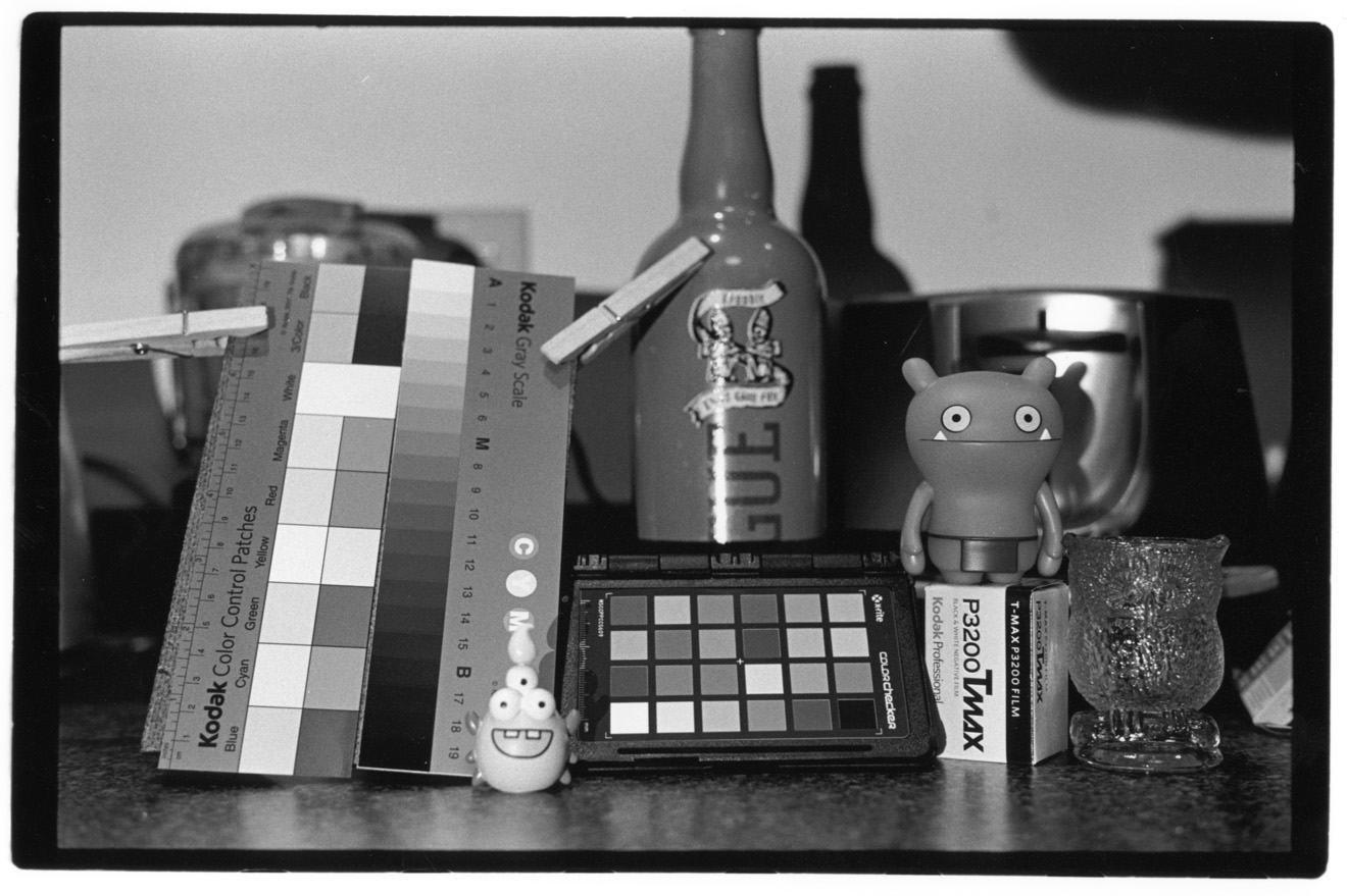

The glass cup on the right is sharper and more realistic looking in the TX image. Same for the Kodak color palette on the left.
The "xrite" text on the lower-center color palette is sharper in the TMY2 image. That said, looking at the text on the bottle in the background, does the TMY2 image have a deeper depth of field than the TX image?
I noticed while adjusting the negative scans of these images, playing around with the shadow contrast changed the impression of sharpness on the glass owl. For whatever reason (printing, developing, toe of the TX), the TX shot has steeper contrast in the shadows.
I have it written down that both shots were at f/4. It's possible that the shots are focused at slightly different points. That being said, when I look at the 4000 dpi scans, the depth of field and center of focus seems to be consistent between the two shots. The TX shot *may* be focused slightly closer. I can't make up my mind about that though.

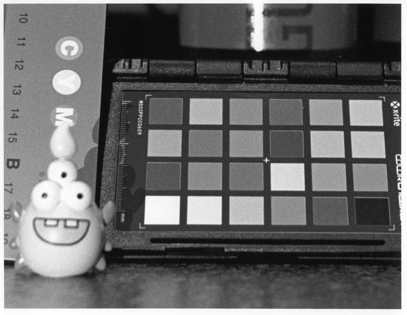

I'm getting the feeling that TX looks sharper on larger features, even thought it's really not. The text on the Xrite chart is definitely sharper in the TMY 8x10 print. I also made crop enlargements - TMY is way sharper at this level.
Again TMY then TX.
I have negative scans of these negatives, but have not posted them here since they are neg scans.
Impossible to tell on resolution anyway. The camera position for the two shots is different, as is the focus. You may very well have the center of focus on the same part of the same object in the scene, but the differing camera positions change everything else. Only way to make a meaningful comparison is to have everything set up exactly the same. That means the props don't move, the camera doesn't move, the focus doesn't move, and the lighting doesn't change.
Well, the props didn't change nor did the lighting. Not moving the camera is difficult in this case - it was a Leica M, so the bottom has to come off to reload it. I left the bottom attached to the tripod, but inevitably after shooting 6 rolls this way, the framing shifted bit by bit.
