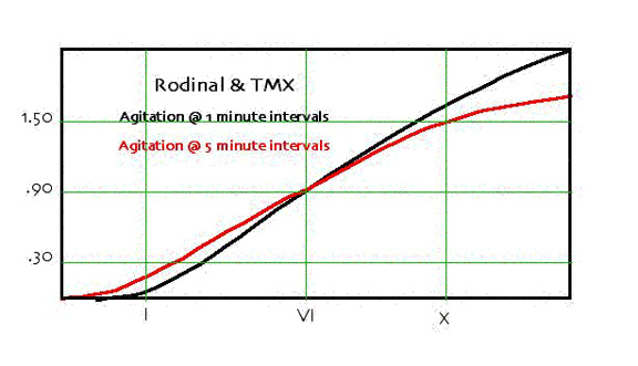

Citret's work is beautiful. His technique is halfway to minimal agitation. He is already achieving the shoulder induction from reduced development (by lowering the concentration of Rodinal). He is probably also reducing the amount of agitation relative to the total development time, which for decades led us to believe that the effect was caused by dilution.
Reducing the agitation further and increasing the development time would allow us to give normal exposure, while maintaining the highlight compression. Rodinal is a good developer for this because it normally builds an equally strong midtone and highlight contrast. TMX is also a good film for this.
This graph shows the effect of reducing the agitation of Rodinal with TMX,
compared to the normal curve. We are actually pushing the shadows and pulling the highlights, and allowing the curve to pivot in the midtones.
Lorenz and White talked about this in The New Zone System Manual in the '70s, about the same time Adams was discussing dilute HC-110 to reduce highlight density without sacrificing shadow density. Nothing is new except our understanding of old technique.
