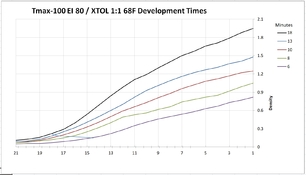

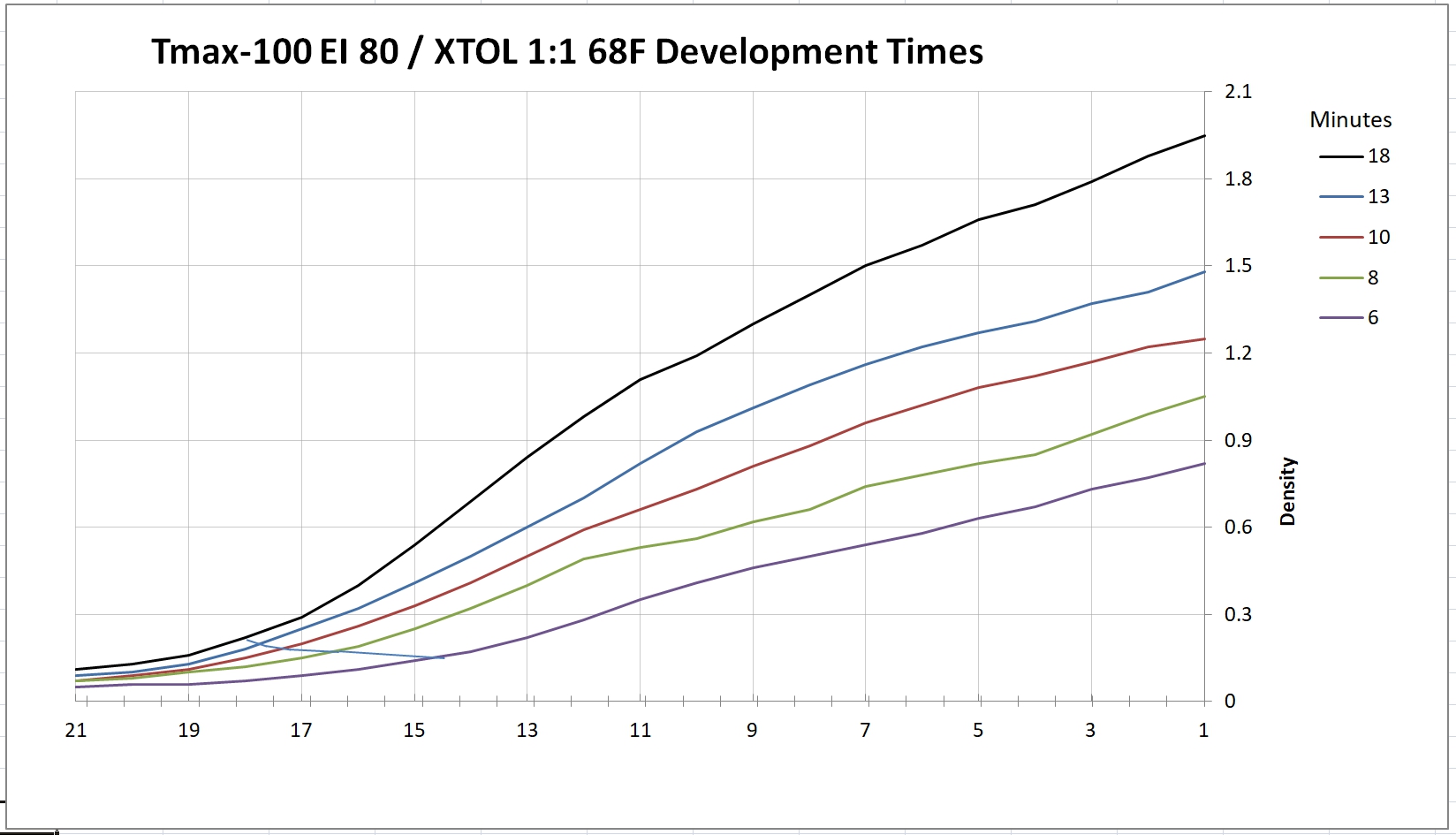

Chuck, some data from the peanut gallery, for what it's worth. I tested TMax 100 a year ago, in Kodak XTOL 1:1 at 68F, Stearman SP-445. I shot a Stouffer 4x5 21-step tablet, overlaying the negatives in the holder, exposing for Zone X on a blank white sheet of bond paper in full sun. EI 80. Development included agitation for the first 30 seconds, and 3 inversions every 30 seconds thereafter.
The FB+F figures are 0.05, 0.07, 0.08, 0.09,and 0.11 for 6,8,10,13 and 18 minute curves. I measured step densities on the negatives using a Tobias TBX densitometer. Though my test setup is definitely 'home brewed', the 13 minute time for N development has worked well for me.

During the course of this thread I realized how far from 'rigorous' my test procedure was.
At first I was surprised that the N time I came up with was so different than Kodak's (f4016_tmax_100-2018.pdf). But the 13minute N figure works for me. That's about as assertive as I can get about sharing my results.
I think that your approach - exposing your test negative in outdoor, indirect lighting - could lead to different times that my procedure gave. Never mind glare, metering, thermometers etc.

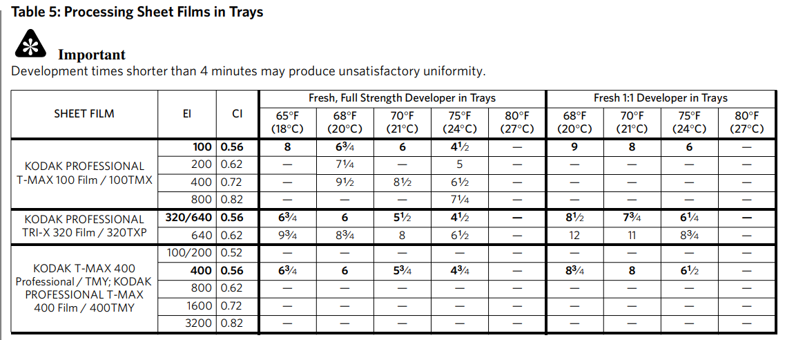

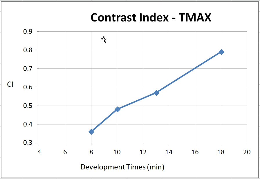

This is from Kodak's Xtol datasheet. I may give you a good ballpark idea.
Kodak includes CI values. While "pushing for speed" is different than for contrast, you can work out the approximate CI needed for N+1, which, depending on how you calculate N, is about 0.68. It falls between their EI 200 and EI 400 times.
