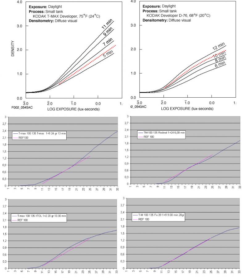

If you KNOW what you want the film to do, you can find a developer to do it for you. Attached, 2 curves from Kodak, and 4 from Foto Import. Have fun. (the dotted red lines approximate EKC's suggestions).

That's interesting, thanks for posting. Except I don't know exactly how to read the curves.
