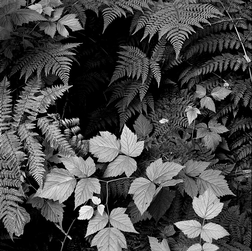

The T-Max negative for this looks very weak indeed:
Yeah this combination makes the tmax look relatively thin but it is good for scanning. Next time try the Tmax 100 at 50 and use Microdol-X 1:0. You may have to optically print to see whats in the denser negs but that combination for Bright Light has been a favorite of mine.
With Aloha
Instagram ChristiaanPhleger
Matt, I had seen that image before, and it really impressed me: both its tone and the tonal vision while composing, were superbly achieved. And those low values are so clean and contrasty: a joy. Good to know the film can look like that...
Chris, that's interesting... As film's so fine grained, I'd imagine stock can't pruduce its usual sharpness loss, so that's indeed something to try...
