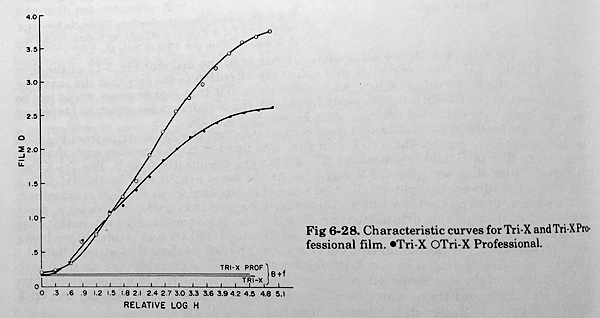

Thought this might be of interest, from the Henry book.
Henry pg. 194, "Kodak Tri-X Pan film has a short toe and a fairly short straight line portion before the shoulder is reached. Kodak Tri-X Pan Professional film has a long toe and a long straight line portion before the shoulder is reached."
The numbers in 6-28 are from outdoor grey card exposures - and on pg. 197, based off real world imagery tests, Henry states "In every instance clearly there was more shadow detail visible with Tri-X Pan and somewhat more highlight detail with Tri-X Pan than with Tri-X Pan Professional." Further down pg. 197, "Clearly, Tri-X Pan film should be superior to Tri-X Pan Professional film where significant flare may occur and where detectable delineation of zones as high as possible is desired. These conditions are those existing in outdoor scenic photography." He also discusses Super-XX's characteristics on pg. 195 & it isn't a hugely wayward line you'd need to draw between Super-XX and the tone curve characteristics of the TMax films.

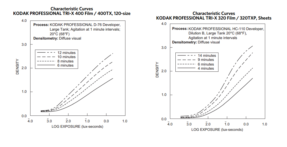

First we see in those curves is that developments from Henry book are not matching because CI is quite different, same developer ?
I don't understand that side by side, compared to the curves in present TX and TXP datasheets that I'm posting:
TX400 sports a remarkable toe that clearly is a mid size toe.
TXP sports an extra long toe, but developer is different for its graph, HC-110, which is the approach I use to get similar effect on HP5. A classic portrait recipe is TXP at EI 80 with HC-110 1:31 5min, but some LF studio shutters substitutd TXP by HP5 because of TXP high price.
So to me TX400 can be considered mid toe, with regular D-76 developer, not short toe at all, this would be Neopan, for example.
Oh my. Yes, different versions of Tri-X have somewhat different renderings of the bottom of the curve, the toe. But this is relative, and in either case the straight line does not extend nearly as deep into the shadows as either species of TMax, let alone now discontinued "straight line" films like Super-XX. HP5 is more similar to TX320 in this respect, though quite dissimilar in other respects. Plus X Pan sheet film was once favored for high-key studio portraiture due to is exceptionally long toe and ability to finely distinguish the upper zones of tonality at the expense of the lower.
As far as I can tell, it was all D-76 developed to "a CI of about 0.56".
First two things to bear in mind: it was all done on 120 - if you have hours to waste, you could compare the relative b+f for 120 TXP, sheet TXT (the contemporaneous sheet product) and current sheet TXP; secondly, I think Henry's x-axis is more compressed than Kodak's - squeeze the x-axis of the Kodak curves & see how they look compared to Henry's.

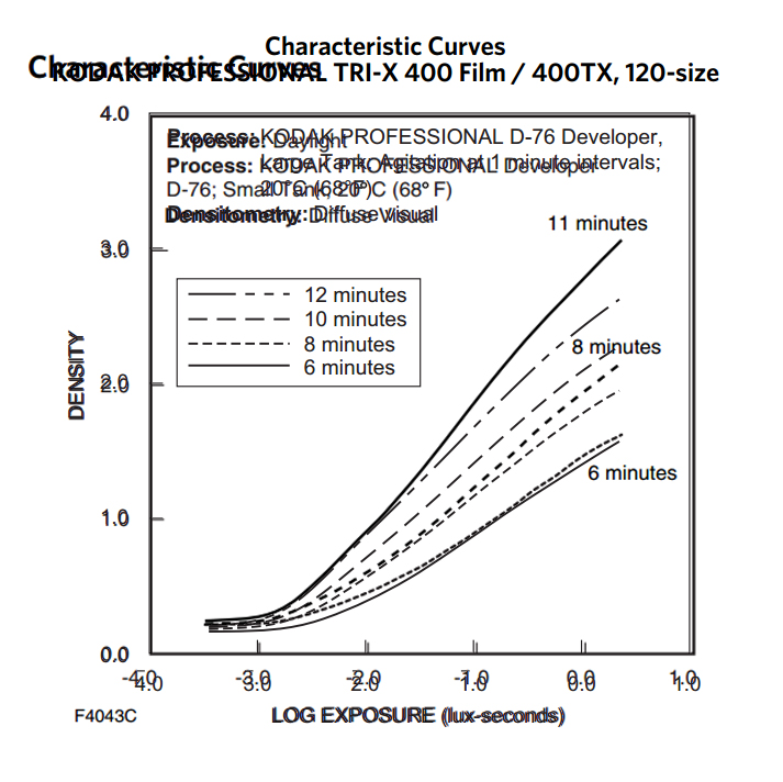

There's a TXP in D-76 graph bottom left on pg.9 of f4017 - they give plots for 0.5, 0.6, 0.7, 0.8 C.I.'s (or something similarly comparable). Extract both 0.6 curves for TX and TXP, superimpose/ overlay them and the significantly sharper toe of TX becomes much more apparent - on a quick visual inspection, it looked to me to be about a stop of difference in the point that the straight line definitively kicks off the toe (not a huge surprise, given the usual rating recommendation for TXP). While you are doing this, extract the 0.5 curve for TXP and see if (by matching the point the straight line leaves the toe) you can match it (more or less) to the 0.6 TX curve...
Once you're done with all this, go and pull the 0.6 curve for TMY-2 in D-76 (the 8 min curve in f4043) and superimpose it on the TX 0.6 curve - you'll discover something very interesting about the toes of both films...

If superimposing TX400 curves on TMY what we see is that TX400 vs TMY have similar toe at high contrast buy developing low contrast TX400 has more toe and TMY is more linear there, much less that I was thinking, still there is some difference.
In fact both films have more similar curves that usually is though.
