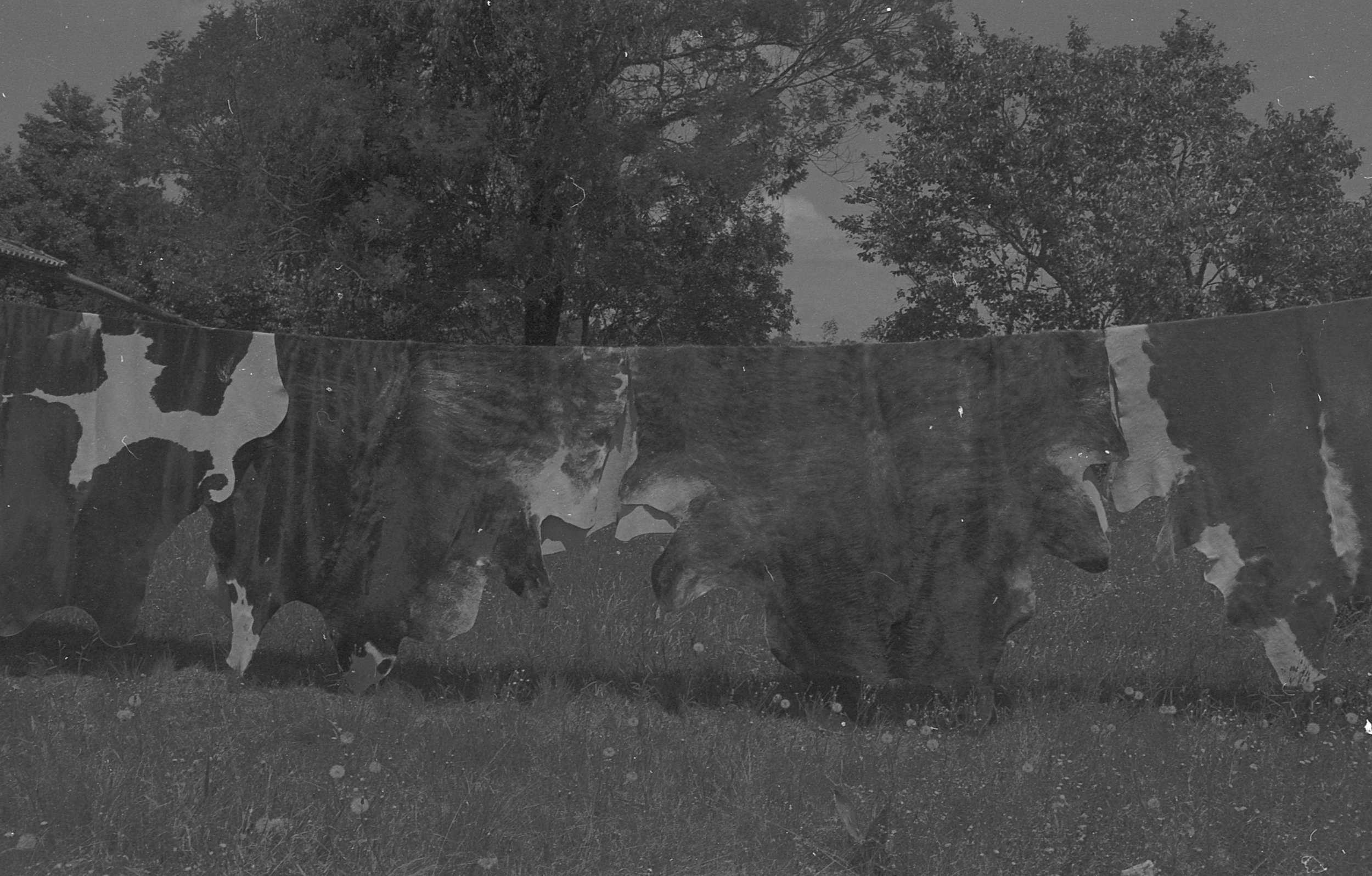

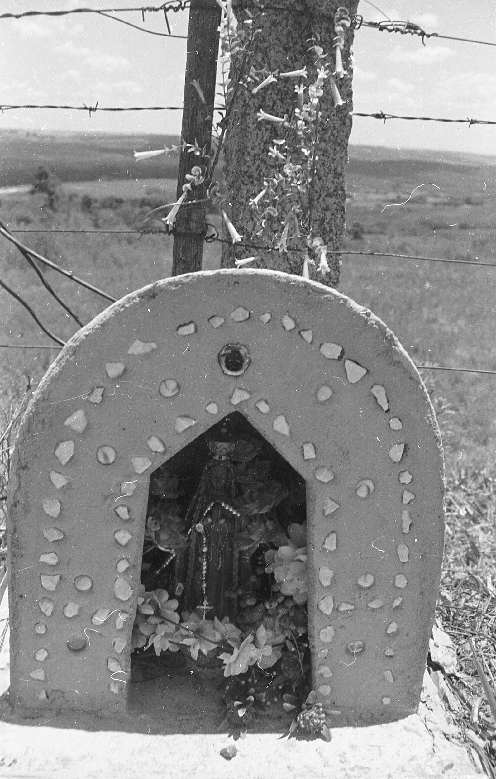

Hey guys, sorry to dig up the thread, but I want to make a last post so this thread can be somewhat more useful.
I developed a second roll of Tmax400 with the exact same formula and ingridents I used before for the caffenol mix. This time I developed for ~18m with agitation for 10s every minute. The negatives still came somewhat underdeveloped. Really not that much difference from the first one execept for the 5 extra minutes in the developer. I wanna point out that I'm somewhat new to film photography, specially b&w film. The only other film I have to compare with is a Tri-X 400 pushed to 1600. Compared to the Tri-X I have way less grain and contrast with the negatives. But I guess this is somewhat normal? After all, the Tri-X is pushed 2 stops of it box-speed.
In fact I think I suffered from something I've heard about, it's called uneven development. Some frames seems just about right while other are clearly underexposed. Does anyone now why? I'm thinking it might have something to do with getting the film in the reel for development.
Still, I finally had a friend scan me the negatives on his Epson V500. He only scanned in medium quality and did no clean up on the negatives. They clearly show I need to improve my handling with them. As expected the underveloped frames have all the tones compressed in a narrow range, in contrast with the pushed film which clearly has a "bimodal" tone curve.
On a last note: the results weren't exactly what I expected, but Caffenol works for sure. Guess I just need some fine-tuning. Still, I might end up going after some "professinal" developer since I'm about to get a bunch of different films that I won't really have much "space" to keep fine tuning the time & mix for Caffenol. After all, I've only started developing to save money (and it is fun). Don't wanna strand to far from my objective, taking photos.
I appreciate all the help given, in special Jnantz.
You're comparing a (mostly) 'old-style' cubic grain film pushed 2 stops (Tri-X) with a 'high-tech' tabular grain style film exposed at box speed AND developed in a very low-contrast developer (your TMY-2 in caffenol). So yes, it is very logical that you see both less grain and less contrast. All according to plan!
Uneven development never manifests itself as differences between individual frames. Development affects the film regardless of where the frame edges were during exposure. If some frames are underexposed, then odds are...you underexposed them! Welcome to film photography - you will have to learn to meter consistently in order to get consistent exposures.
When scanning, the resulting files directly from the scanning software virtually always benefit from optimization. It's just like printing in the darkroom (you'll find if you get to that stage): a straight grade-2 print very often does not make the final print in its full glory. Conversely, it's also not easy to tell if your processing (i.e. development) is 'good'. It's good if it yields the images you want, of course. When scanning, especially if you run scanner software in an automatic mode or have someone else do the scanning for you, you simply have no idea if (1) all image information present in the negative has actually gotten its way into the scan or (2) which contrast adjustments may or may not have been applied to the image. In any case, the first image you posted above shows that you at least have one negative with decent shadow detail, detail in the highlights and evidently an amount of contrast that the scanner used could handle well. In short: it works, so all seems quite OK from a distance. The proof of the pudding is in the actual wet printing of your negatives under an enlarger, I'd say - but I'm aware that not everyone wants to take their hobby into that direction.

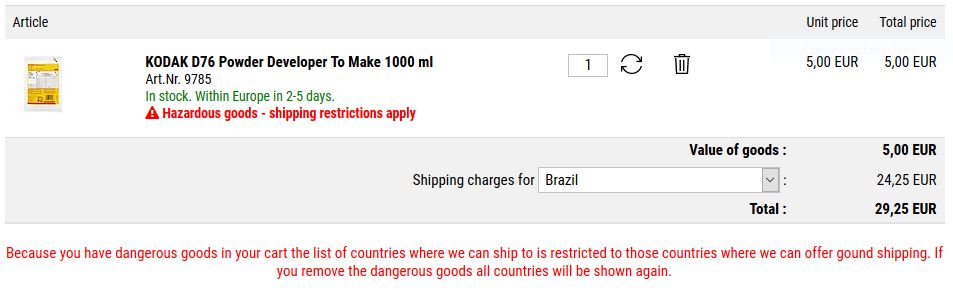

Out of curiosity, I went to the fotoimpex.de site and placed a 1-litre pack of D-76 in the "basket", then asked for the price. Sure enough, it is expensive, mostly because Brazil is among the countries that consider D-76 powder to be "dangerous goods":cry: and require ground shipping.
But, 29.25€ is much less than the 90 US$ that you mention. And, if I were in your shoes, I'd try to balance the more-or-less fixed shipping charges with a comparable value for the goods themselves, i.e. buy a 1-litre of HC-110 concentrate; Results similar (if not identical) to D-76, the concentrate lasts literally for years, and some photographers who actually print nice b/w photos have been happy with HC-110 for decades.
Still less than your 90US$, and enough developer to develop approx 100 35-mm films using dilution B, more if you use a higher dilution ratio.
