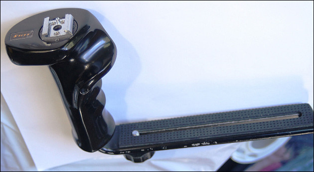

I have the Mamiya bracket mentioned above and never use it. The leverage just isn't right and the camera feels more difficult to hold at all, almost impossible to hold still.

I'm just the opposite. Instead of the Mamiya bracket, I use one of those even heavier duty Suntar flash brackets. Like this one, but with a square TLR mounting plate:
This allows me to securely handle the C330s TLR, while at the same time keeping my sweaty grubby paws off the brand new camera body. I also use it for hand-holding a 4x5 Crown Graphic with attached Graflite.
Because I'm a believer in using outdoor fill-flash, I will often mount a Sunpak 120J bare bulb unit to the flash mount shoe. Although it increases weight and bulk, it also serves to better balance the package.
While gripping with my left hand, my right hand then remains free for using an incident meter, opening/closing the TLR viewfinder, winding frames, focusing, and shutter release.
