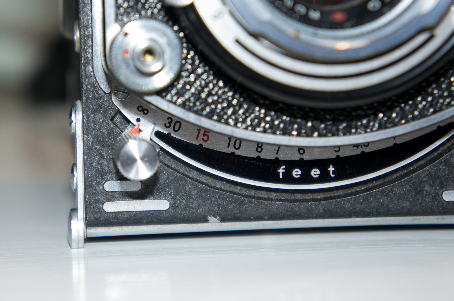

what is the red needle on the focus lever for? is it a coincidence that infinity comes into focus on the screen when the red needle is over the infinity mark?

That I cannot answer. Check the owner's manual, probably available on Butkus. I did not realize that this camera used a linear focus knob--never saw one before.

Maybe it was adjusted to be infrared only rig? I know nothing about infrared photography. But would how the camera is now (intentional or not) be right for infrared film - able to be focused normally on the screen? Or would this be backwards?

No, it's just out of adjustment. Take off the front panel and adjust the viewing lens for infinity. It's that simple.

So my logic is fuzzy?
When the focus screen is sharp at infinity the red infrared mark is on infinity .
The mark is fixed making it constant through the range of focus? So the difference should translate to all distances?
What am I missing?

Yes the mark maintains for all IR distances. Look at a 35mm camera lens. Don't ask it to make sense, because it doesn't to me either. But you're just trying to get your VL and TL to jive for regular film right now.
It's the index used for focussing when infrared film is used. If it indicates focus for visible light, something is wrong... Which index lines up where when you are verifying focus with groundglass at the filmplane?

That is what I'm saying infinity is sharp on focus screen when red IR mark on lever is at infinity. Infinity on film plane sharp on regular mark. So loaded with the right IR film... theoretically I should be able to use focus screen to focus right?

Wrong. Infinity must be sharp on the screen and at the filmplane for visible light when the regular mark is at infinity.
The focus on the screen must coincide with the focus at the filmplane. This is the entire point of a TLR. The way the camera is now, you will not get proper focus for visble or IR light.
