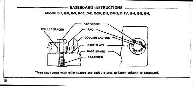

Monophoto's D is apparently modified. The bottom of the column casting, what people seem to be calling the flange here (because it looks like one) should be solid, with no screw holes. By design, it sits on a thiner metal base plate that keeps it from digging into the mounting surface. At three places around the perimeter of the baseplate, 120 degrees apart, are bolt holes beside turned-up edges on the base plate. Thick metal pads with bolt holes rest on the tops of those turned-up edges and bridge the gap between the plate and the column casting, resting also on top of the "flange" part of that casting. A roller spacer holds the column casting centered between the cap screws, and the three cap screws pass freely through (from top to bottom) the square metal pads, then the roller spacers, then the metal base plate, then through holes in the counter/baseboard. They then thread into T-nuts (or you could use fender washers and nuts) on the bottom of the counter/baseboard. This allows the cap screws to bear down on the metal pads, and create a leverage force that pins the column casting (flange) to the baseboard. The metal baseplate also has ridges that help keep the column centered.
See the attached drawing for reference. Sorry for the poor quality. It's a scan of a poor .pdf of a bad jpg of a bad photocopy of the maintenance manual. I found it somewhere online, but can't remember where. I was looking for alignment instructions for my D5 when I found it, so some patience and creative googling might bring it up for you. If I come across it again, I'll post the url.
Lee

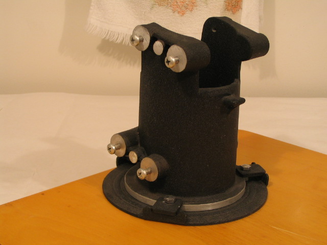

The casting mounted between the rails has a circular part on the bottom, about 5" in diameter. The mating part screwed to the baseboard is about 7 1/2" in diameter. Here are a couple of pictures, of the base, and of how I mounted it to the wall.
All in all, I would recommend you mount it to the wall. Sturdy as a rock.
