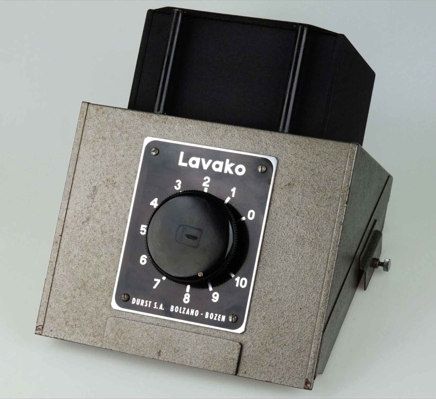

I know about Ilford 500, it's probably a similar solution to Agfa Color head + Durst Lavako adapter, which is now for sale on Ebay. I thought about it (agfa+lavako), but it's a really old model with hard to find lamp.
I have some LED floodlights at home (30W and 50W), so I'll try removing the condesors first and measuring the intensity and uniformity of light.
.I read here or maybe elsewhere that the Durst Lacoli, which is located instead of the condenser, does not give completely uniform results for 5x7 negatives and a diffuse source larger than the negative is optimal.

Yeah, Lacoli in the lower position, Lacotra (powe supply) above. I don't like fluorescent light sources, so I didn't even think about Lacoli, especially for the money they sometimes come up for.

Those ancient slip-in Lacoli cold lights - if you can even find one that hasn't been stomped underfoot by a Brontosaurus - are way undersized and underpowered for serious work.

Well, I have a cold light conversion atop one my of own 138 chassis, and like it a great deal; but that's a different story - a 12X12 inch Aristo V54 high-output blue-green model. It's timed with a Zone VI compensating timer, basically a light integrator probe plus a beeper.
The Brontosaur stomped sub-5x7 Lacoli is somewhere up on the loft in a big box of surplus components I never have used, including the entire original condenser head. I sold off all the condensers themselves long ago - looked like none of them had ever been used by anyone.

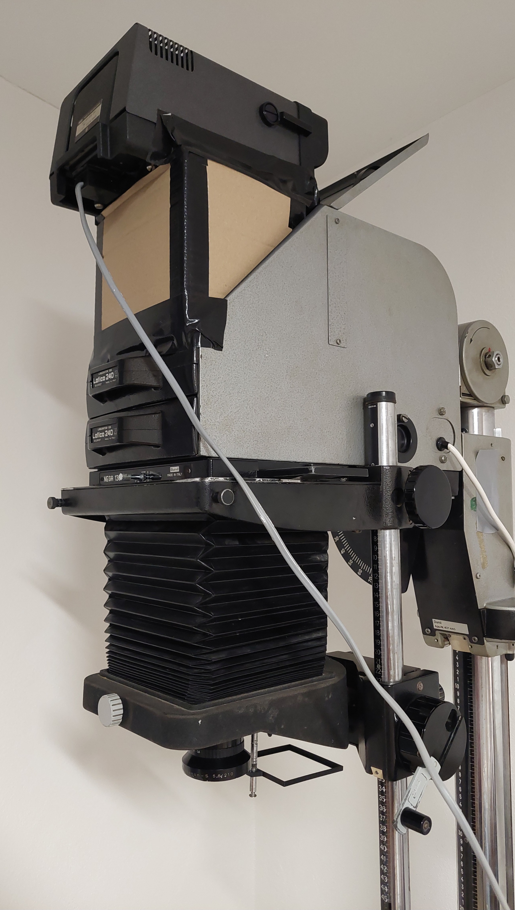

I was in the darkroom today and tried something. I saw an Ilford 500H head on a Durst 138, but with the information that it is only usable up to a 4x5 negative size. I tried to put a Meopta Color 4 color head, designed for 6x9, on the condensers using cardboard.
What surprised me was that it cover 5x7 neg very evenly, with a loss in the corners of about 0.2 stop. There is not enough light for a 40x50cm enlargement, there is only one 100w halogen, but still......I wanted a purely diffuse light source, but maybe a more powerful head for 4x5 would be an intermediate step (a lot cheaper than CLS 301).
Nice! Yes, this approach works; since you have a reasonable distance between the diffusor/color mixer in the color head and the condenser array, you can still get OK coverage. Be sure to test it with prints on high contrast grade, or a (near-)neutral grey filtration on color paper. The proof of the pudding is after all in the testing.

Sure, it was just a test. The "window" of the lamp box, from which the light then reflects off the mirror into the condensers, is very similar in size to the bottom of the mixing chamber of the color head.
I was thinking about the Agfa head, but it's a very old model. The Durst Lavako that came with it also allows for height adjustment.
