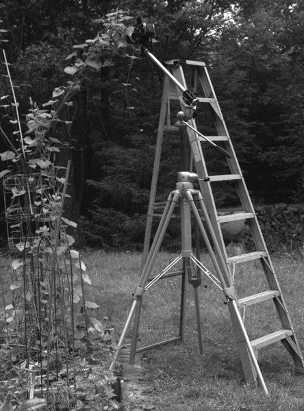

The flower was photographed using the set up in the B&W shot. Mostly I used MLU, but can't say whether it was used on this particular shot or not.
