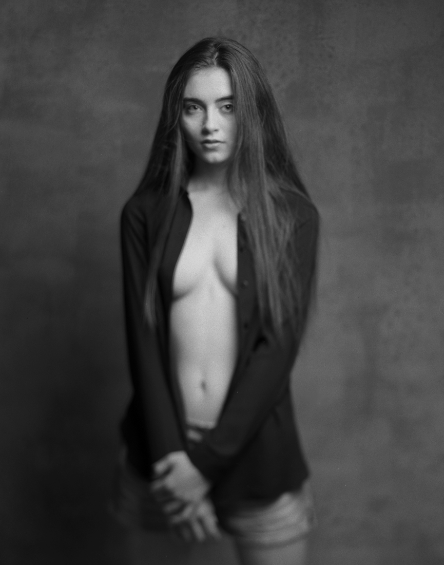

Hello,
I am primarily a people photographer so this post specifically relates to portraits.
I have been shooting large format for about 6 months alongside 35mm/120 and digital. I have Wista 45RF with a Schneider 180mm lens, I am very pleased with the set up and too a degree the results I am getting.
I would like to know how to get consistently that "Paolo Roversi" Tilt & Shift look as per my image below, which was a bit of a fluke. I have been a little slap dash and have not really written the cameras settings down so I have no real data.
I have shoot this Saturday and would love to try and achieve this look, I will also be writing the settings down as well. I was hoping someone could give me a few tips where to start. All movements will be set to default.
The Wista does rise, swing, tilt & shift from the front, it does do rear movements but they are quite limited.
One question I do have is that A. do I focus with all movements at default, then make movement alteration and shoot or B. Should I focus with all movements at default, make movement alteration refocus and then shoot ???
Any good tips would be great fully appreciated.
Thanks
Brian

Possible suggestions, given the reference image.
- start with camera in neutral positions
- camera height approximately nose (of the subject) high, maybe a bit higher
- camera bed angled slightly downward toward subject
- slight front fall (opposite of rise)
- slight front tilt, toward the subject, of the front standard
I don't see a need for shift movement.
This will take some experimentation. If you have an assistant, he/she can pose while you dial in the movements. Then you can bring the subject into the set and work with him/her for the aesthetic you want to achieve.
Huub

And to reply your question: always refocus after making movements, even when it is just to be sure the focus is where you want it.
And that is quite a nice picture.
I suppose that at a point you will understand which kind/amount of movement gives the look you like in your pictures, and you will stick to it. So in my opinion you don't even need to focus with movements at default, there's no real need for it. Nor there is need to reset movements and then re-apply movements at every other picture. Just keep them as they are and go ahead.
The picture is nice and the model is absolutely lovely (I wish I also had one), however if I were you I would have focused the eyes and not the hairline. Just my opinion/taste of course.

I took a look at some of the photographers images you are trying to emulate. What I found was a strong use of creative lighting and a lower than normal camera position. I didn't see the swing/tilt effects you are referring to. Mind you I couldn't see his webpage as he is one of the few who still use Flash and that particular plugin is blocked on my device.
I have used the swing/tilt to good effect on landscapes and "things" such as playground equipment. If it were me I would concentrate on the lighting and posing and do any swing/tilt effects in PS. That way you have a really sharp negative/positive that you can use "straight" if you want.
I do agree, the eyes would have been better to focus, but I was struggling with focus in general I think it was 1st or 2nd time using the camera

A lot of large format studio cameras offer a bit of swing, mostly, I suspect, to keep both eyes in focus.
Large format just takes practice. Keep it up! She is a beautiful model who is posed and lit well. You created a captivating image! You definitely need to reshoot her and get the eyes in focus. You will be glad that you did.
I'm going to be contrarian about this.
I think that the plane of focus actually works well - it is an exception to my normal rule favouring the eyes.
In this case, it adds a dreamlike character to the image - not dissimilar to a soft focus result.
But I certainly wouldn't hesitate to experiment more with working with the model and the idea.

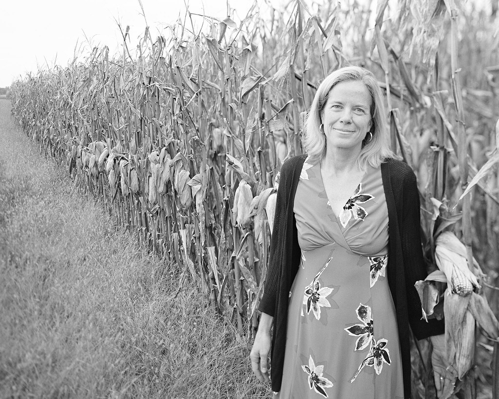

A small amount of front swing was used to get more of the background in focus. Very slight downward tilt of the camera bed, camera bed leveled, slight front drop, vertical film plane. I don't recall any front tilt, looking at the image I don't think I used any. Aperture was something like f/16 or f/22, exposure was at box speed, incident metered at the subject's chin with the dome facing the camera.
The effect in the image below is not at all what is shown in the above images, it is used as an example of using movements for a portrait. Selective focus is used in all of these images in the thread, so far. The photographers in each case are selecting different aspects of the subject on which to focus.
