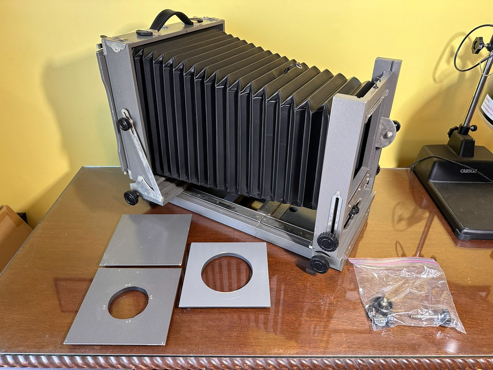

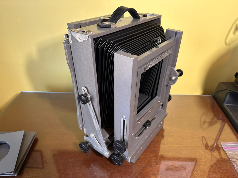

I’m new to this forum, so apologies if this topic has been discussed previously. Just getting started with 8x10, and will using my recently purchased grey Ansco for a project that will include exterior and interior shots. For the former, I have a Kodak Commercial Ektar 12 in. f6.3. But I’m trying to decide how wide I should go for interiors? And how wide could I go given the limitations of an old view camera without removable bellows.
I’d prefer to lean towards lower cost, initially, so am thinking of vintage lenses like the Wollensak Series IIIa 6 1/4 in. f12.5 EX WA 8x10. Is that going to be too wide given my bellows limit? I expect I’ll need room for some camera movements depending on the space involved, so guess the Kodak Wide-Angle Ektars may not be ideal?
And at least at the beginning, I’m planning to stick with contact printing.

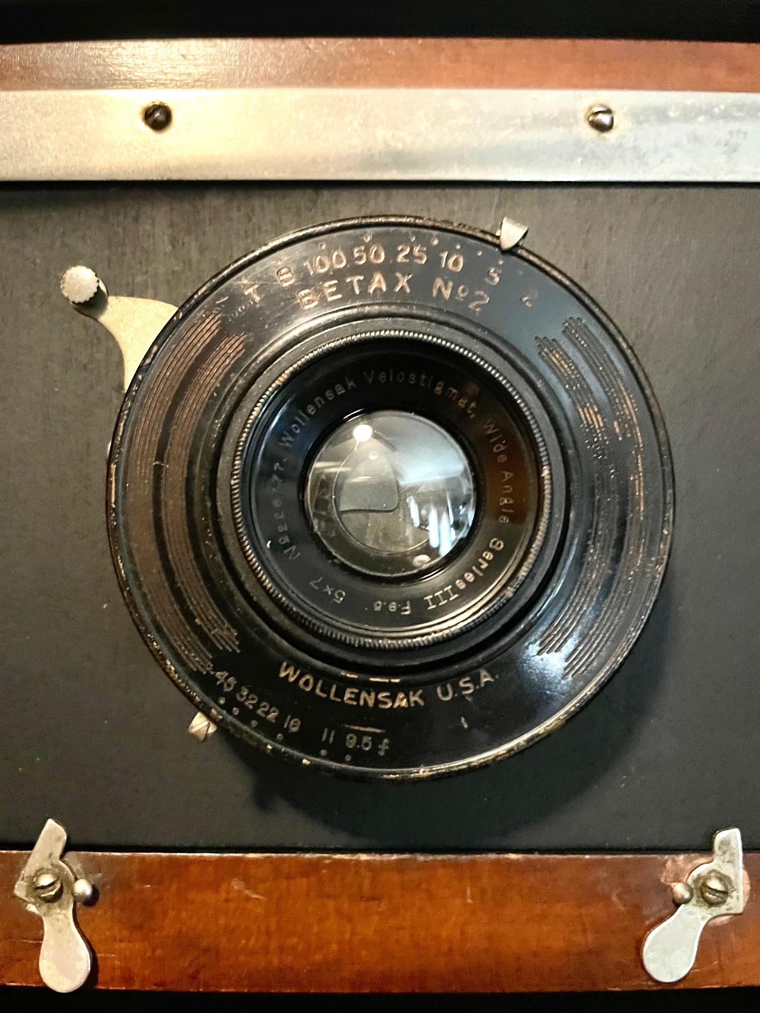

I have the 5x7 version of the Series IIIa lens (Wollensak Velostigmat Wide-Angle Series III F/9.5 (121mm) lens) and can say, at least for that lens, there is practically no chance of movements without hitting the lower definition portion of the image circle.
My front standard is pressed tightly to the rear standard at infinity and anything below f22 starts to show image degradation toward the edges of the frame.
That being said, it is a very sharp lens when stopped down to f22 and is not terribly bad with flare when shaded properly.
I am shooting a similar style Gunlach Korona field camera, so I would expect roughly the same experience with the 8x10 lens, but I have no first hand experience to confirm that suspicion.
IMHO, it's a really amazing lens when you stop to think it was marketed as early as 1909 and if you can buy one for a reasonable price, well worth adding to the arsenal.
Edit: you should also know you need a GOOD ground glass magnifier to focus this lens. You cannot focus sharply without one...

The velostigmat wide angle f9.5 is still listed as a 90 degree field of view.
I own a yellow dot f12.5 version. (all it means really is most recent version and a "cold-weather" balsam/glue) I haven't used it in an alley or building foyer yet. I think the most common complaint with these lenses is a lack of significant movements and light fall-off. I haven't used mine enough yet to bump into these issues. " A large circle of illumination..." sounds really good but doesn't necessarily equate to a large circle of acceptable sharpness.

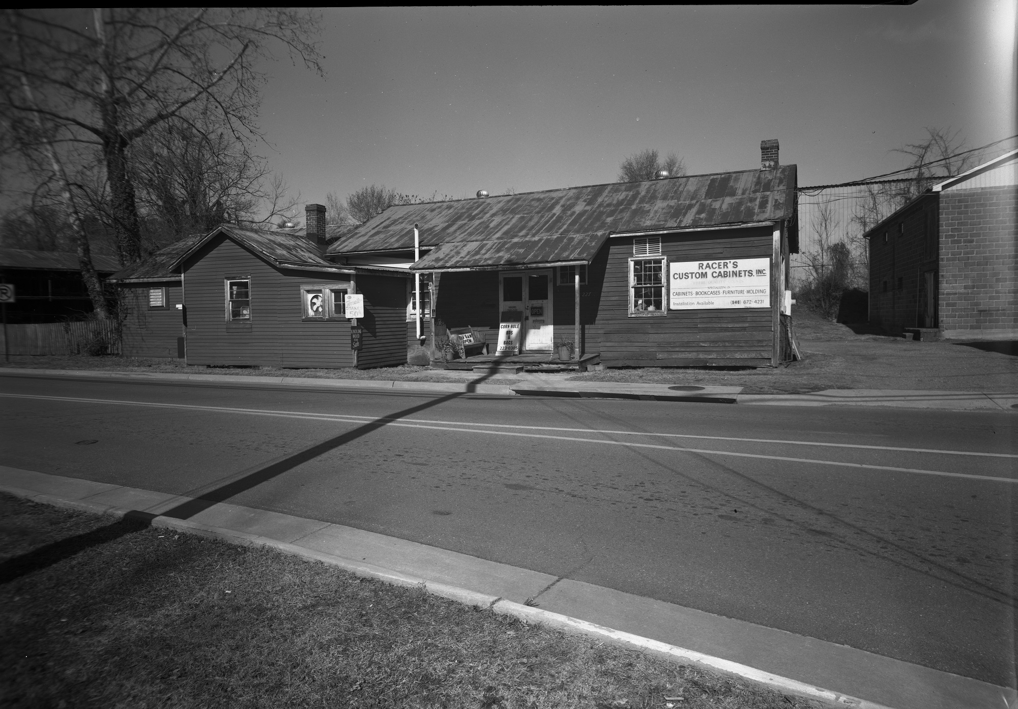

This shot illustrates light fall-off with a mild front lens swing (forgive the light leak from an old film holder on the right). Shot this before I really understood the limits of the lens; found out!
As the advertising literature seems to emphasize, it was made for banquet and large group shots made indoors with no concern for camera movements.
In this image, do you swing a bit towards the sign? Another problem I have while still "learning" this lens/focal length is letting way too much foreground into the frame. In your example, you would have been standing in the street to minimize it, but I have a frame where I could lose a full third of my image and be happy. I had no excuse. I thought it was ok on the ground glass but it looks pretty bad on the light table.
Yes, I was trying to place the lens board more parallel to the front of the building for sake of focus. It was my first outing with the lens, so naively I tried to treat it like a lens that had enough coverage to make some swings and tilts. In retrospect, with the f-stop I used, the movement was not required or even photographically possible; live and learn.
It IS hard to judge just how wide the resulting image will actually turn out with this lens. I too was taken aback at how much foreground showed-up, but wrote it off on inexperience. Add to this the inherent difficulty of using an older, dim ground glass and I only tend to see about 1/4 of the image at any one time with my head under the dark cloth, so I have to "bob and weave" my head to try to a idea of full ground glass coverage.

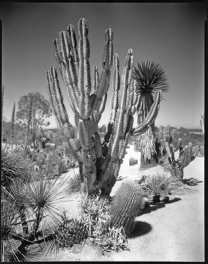

I have the 6.25" f:9.5 Wolly Velostigmat WA Series III that I've been using on an 8x10 Deardorff. It's surprisingly small and sharp for an old lens and was a relative deal compared to other wide lenses for 8x10.
Definitely some fall-off in the corners but I'm still able to use some movements. I've still got about 5cm of bellows available when the lens is focused at infinity. It's also nice that I can fit 43mm screw-in filters on it.
It does give a much wider view than I anticipated. I had to get really close to this 12-ft cactus and use some front rise to fill the frame. This was shot at f11 with an orange filter on Delta 100.

This is great information, thank you! And I love this photo.
