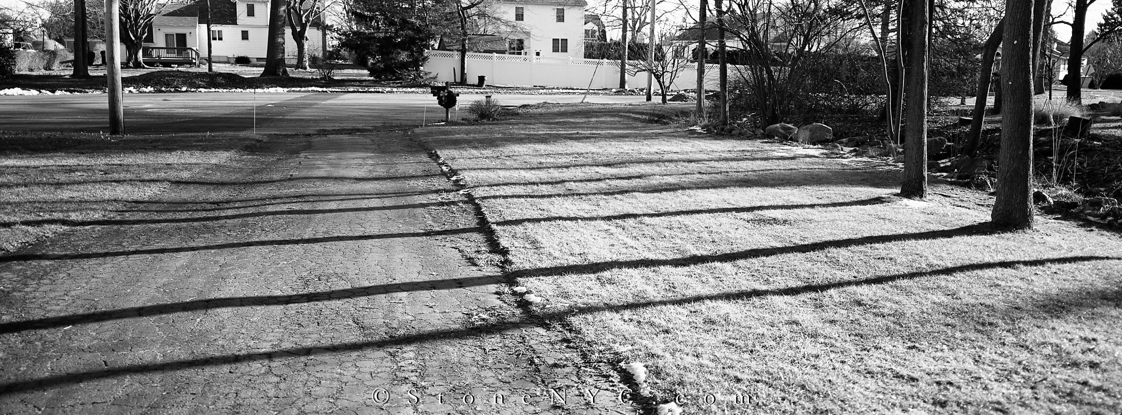

I normally use C-41 developer, 10min (I actually use 8:30 in Jobo at high speed), 20°C, box speed, normal Kodak agitation. C-41 developer is easy to find and the process works fine without resorting to special agitation schemes.
From an old Photo Techniques "Mastering Black-and-White Photography Volume 1".
