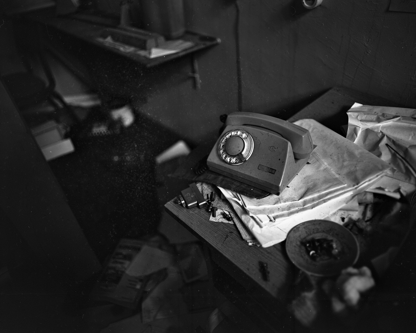

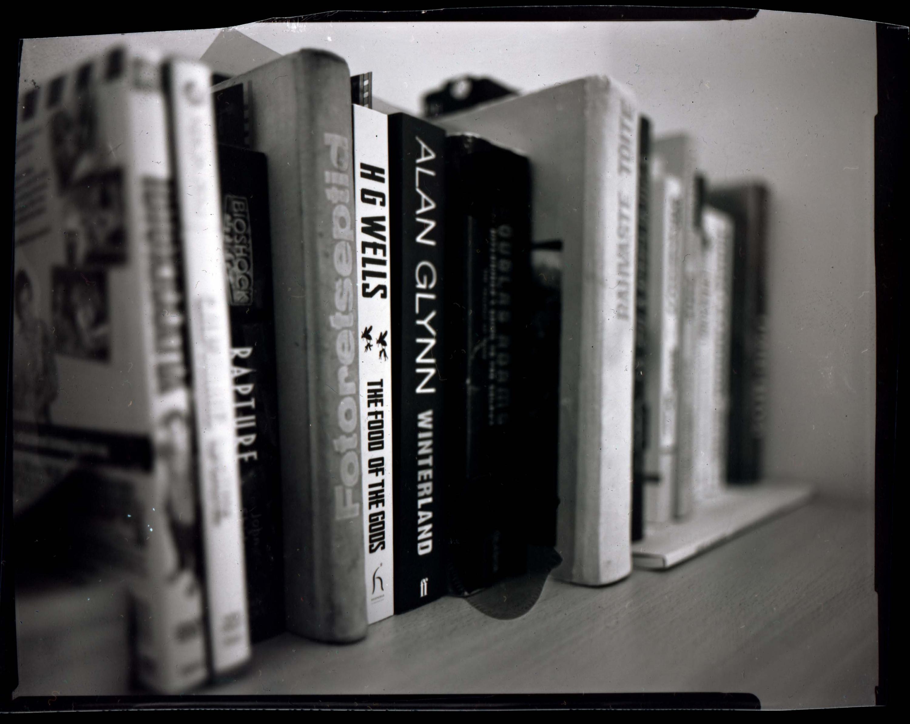

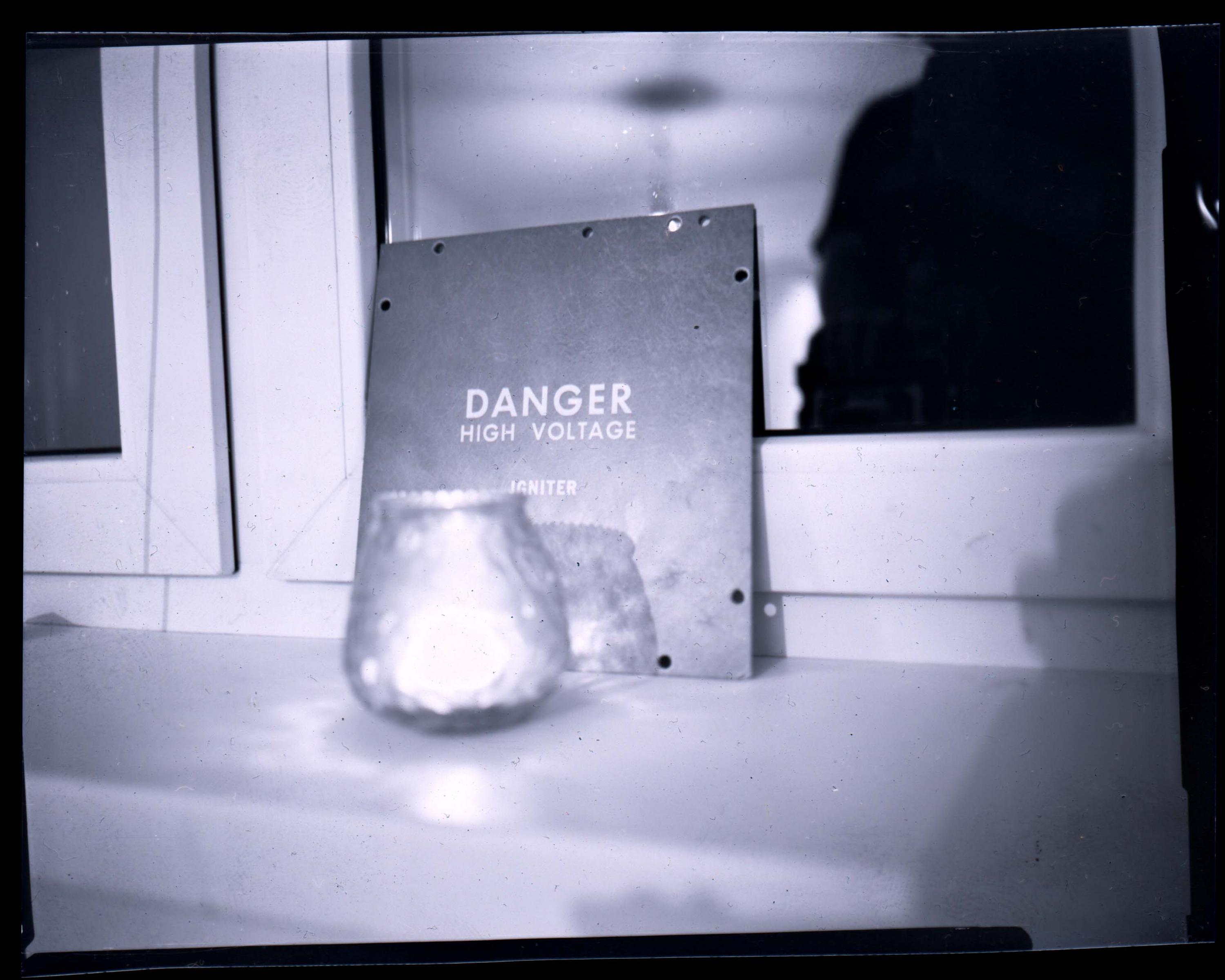

It is both thin as in the base is very thin and thin as it is underdeveloped - I still need to adjust the time. But on the bright side - those blotched negatives scan very well as reflective media!
Crown Graphic, Rodenstock Grandagon-N 75mm, Tech Pan, Rodinal 1+200, developing method described above. Some weird contamination spot on negative.
Same as above, this time without contamination. Notice how the red candle completely blows out and the red danger sign is quite bright also.

What do you use to scan them and still get the frame lines in?

Some ordinary Canon printer-scanner-copier I had gathering dust here, A4 sized. Just tossed them on the glass and pressed scan. If I can maintain the same contrast but get the density right, I would be so happy.

At what DPI? Just curious really, I have an Epson V750 and I'm only able to get an acceptable scan in the holders which cover the edges.

The scanner maxed out at 600DPI. No holders, just slammed against the glass :tongue:

OH!!! That's why haha, my scans are 3200 or 2400, never scan as small as 1200 or 600 ever.
I guess for internet that's more than enough.

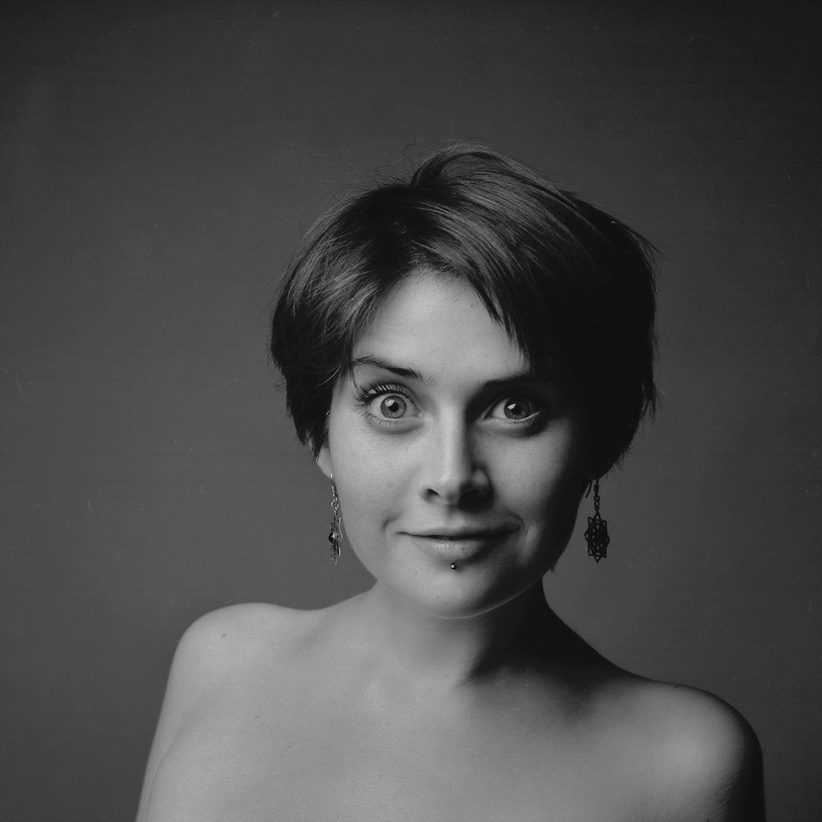

I used TecPan as my all time favorite for photographing women... (and they seemed to love me for using it.. actually they thought it was my doing which it wasn't - it was the film..)
TechPan 120 film 100iso (!!) - 6 min in Neofin Doku..
miss them both.

Cute, great eyes too :smile:
EI 100? And only 6 minutes hmmm, so it pushed. 2 stops and doesn't look pushed at all.

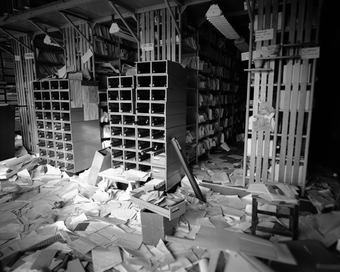

I am satisfied to put it short. Developing method described above, Rodenstock Grandagon-N 75mm shot wide open, Graflex Crown Graphic.

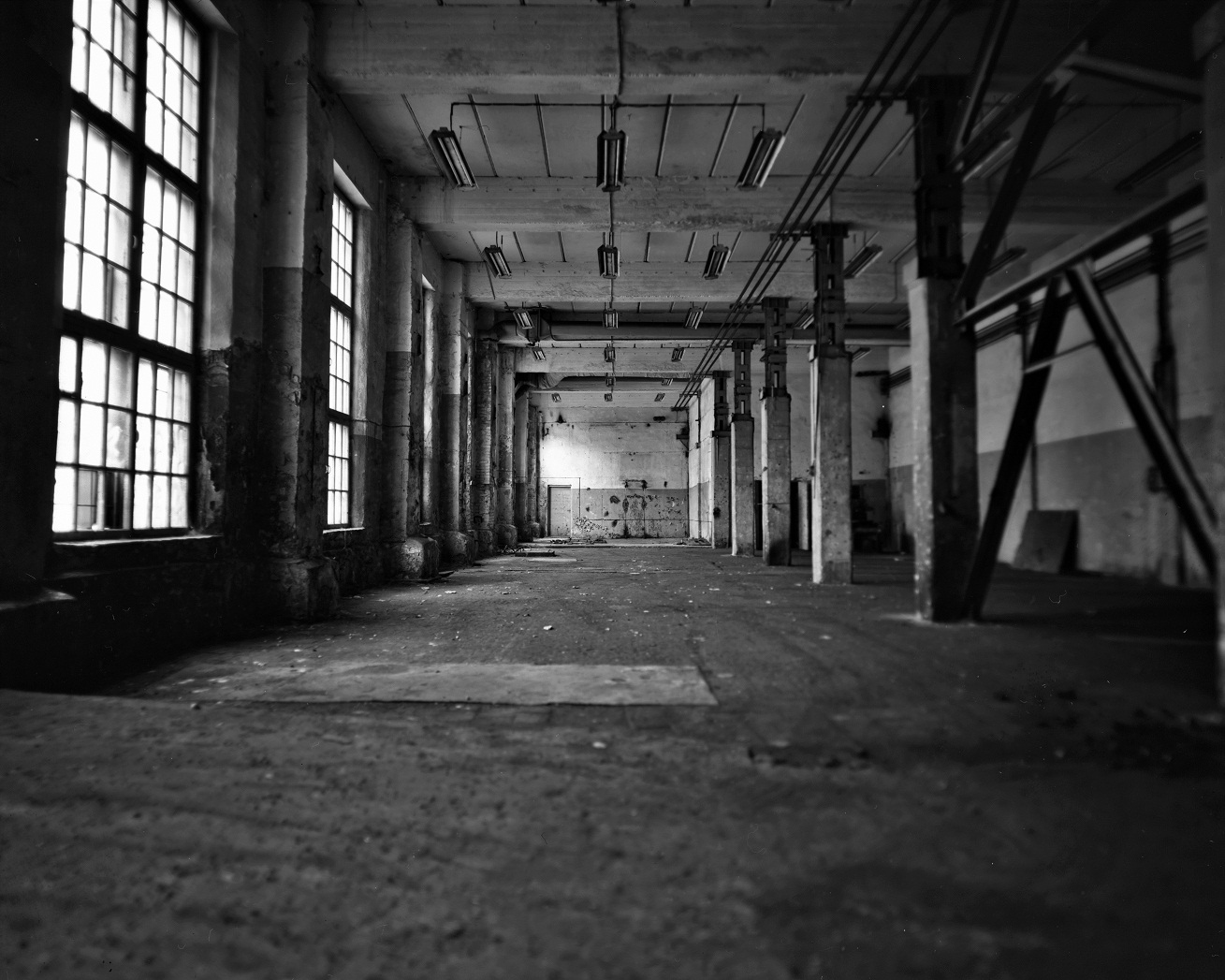

Two more:
It is a tricky film to use, really tricky. But once gotten right, it is totally worth the hassle. I made some glossy digital prints out of scans and they just pop to life. I'll do some actual enlargements do and see how they print traditionally.
