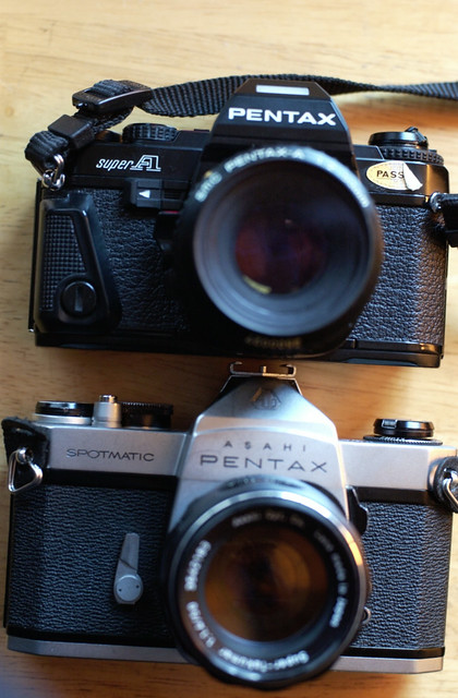

Also, if you're looking for a black version, the Super A is that camera. Had one for a while. Re: the frame counter issue - seems to happen to a few of them. Friend of mine in Canada has a Super Prog with a stuck frame counter as well. Anyway, a Super A with a 1st generation Spottie.
-J
