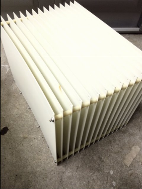

OK, got some rather poor but hopefully helpful pictures.
This is my washer. It can take 11x14 paper and paper goes in between the slots you see. The whole slot thing goes into the tank and be submerged in water once the tank fills.
Please see IMG_0340. That is how it looks when insert is taken out. Note a horizontal tubing at top of the image. That tubing has holes along the length. Water comes in from the tube attached to this thing as you can see on very right of the image. Water squirts out toward the print through these holes.
Once the water fills, it flows to left of the image where there is a drain hole. There used to be a tube attached to this thing where end of that tube rested at the bottom of left side. So the idea was, water from top left flows across the tank and drains at the bottom left. Which then is piped to the drain pipe on left top by siphoning action.
IMG_0341 is from drain side. Please remember, longer tube was attached to this stub so it rested at bottom of the tank.
IMG_0342 is the insert. This is just a stack of plastic kept apart by certain distance by spacers. There is a long tube going across as you can sort of see. The texture of these plastic sheet is NOT smooth to prevent prints from sticking. This whole thing goes into the tank. Water squaring out of that tube in the first image travels along the length of the sheet. Those holes are alined with the spacing between sheets.
IMG_0344 is how two parts looks for size comparison.

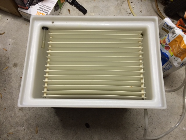

tkamiya
Oct 3, 2009
4,284
Central Flor
This is how two pieces fit together. Supply side is on your right. Drain side is on your left. Again, an extension was attached to the drain before, so water will go across from top right to bottom left.
Now, take a look at the drain pipe and note, there is a small hole on the pipe. That hole is an air vent. It kind of sort of helps water flow better on the outlet side.
To be honest, the drain side does not work all that well. Occasionally, flow rate is too high or the pipe gets air lock and over flows. Hole on the lip is another drain hole. But that doesn't help much either. So water flows out of entire top side of the tank.

This thing came with some heavy plastic rods. What those do are to prevent paper from floating up. It goes perpendicular to the print and rests on top of the slats.
