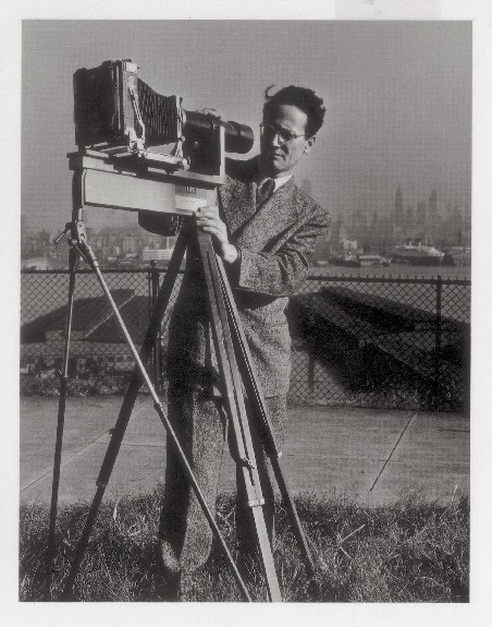

Are you familiar with Andreas Feininger's long-focus lens work and his unique camera. Might give you some ideas:

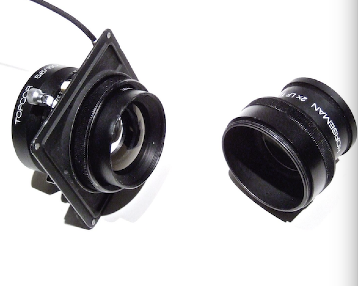

The Horseman 2x converter is an inexpensive way to make a compact 300mm lens from just about any common 150mm lens.
Never seen that one before. He was a genius of some sort. Very unique photographer.
Most of his early long lens work was on large format, so probably not relevant for OP.
I'm not, unless he's the guy who did shots of Midtown Manhattan from Weehawken in the 1940s and '50s.
But I started building something like that 12 years ago for a 1200mm brass cannon/lens I got about 20 years ago. Unfortunately kids got in the way. But that is very similar to the idea, which is why I keep coming back to it.

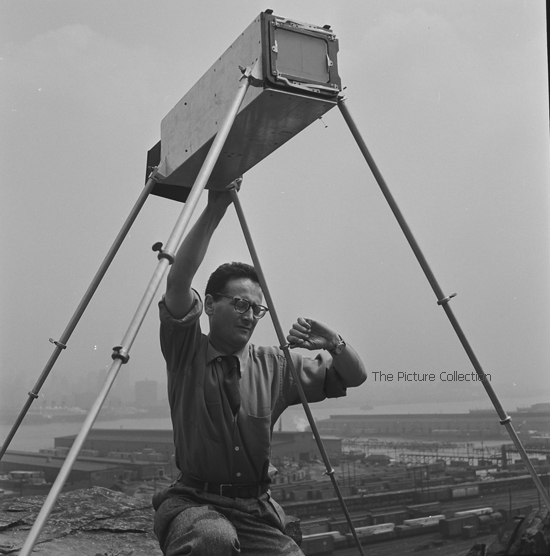

Feininger describes his construction of the camera pictured in post #6 as two boxes that slide in side each other for focusing. They are lined with velvet to make them light tight. He seems most proud of the 'tripod' legs used for stabilization; the key to getting sharp images with a long focus camera. Similar to what the OP has described, he attached the back end of a camera to the box in order to hold the film.
Sunday on Coney Island, July 1949--40" lens
I think that is the same guy that gave me the original idea. I had a plywood sliding box camera with internal corrugation and flocking, and a 4x5 back. I made it to use two tripods, front and back. The lens is marked E. Liesegang Elberfeld, and is about 8" in diameter and probably 14" long.
These are some, probably earlier, iterations of the same idea:
The main takeaway should be the “tripod”, originally a tripod with front legs.
You are not going to be shooting that long a lens without substantial support.
