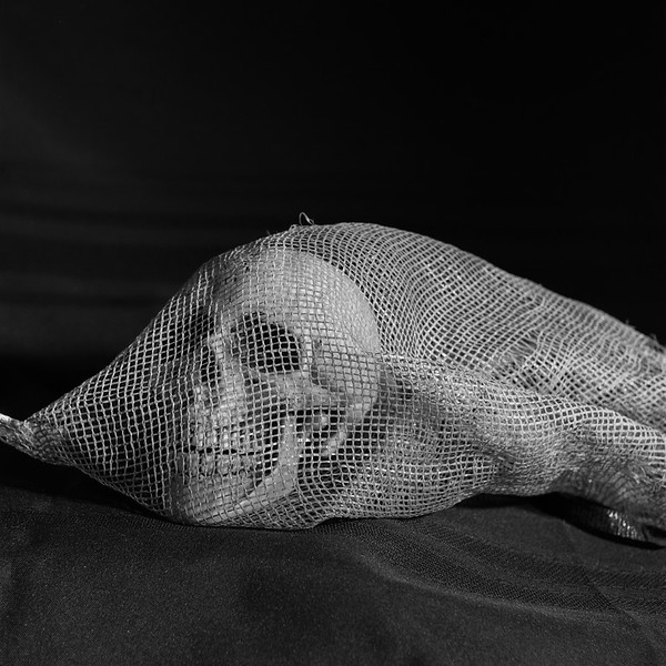

I ended up picking up the 0.5m version of the Ikoprox, as well as hunting down a deceptively uncommon 35.5-49mm step up ring on eBay.
Initial results are very good! This photo was taken with the Ikoprox and a yellow filter on FP4+, developed in Pyrocat HDC, and cropped in a bit to print an 8x10. Shallow depth of field (on purpose), but very sharp. I'm warming up to this camera quickly. Now I have my eye on the 1m version of the Ikoprox as well.

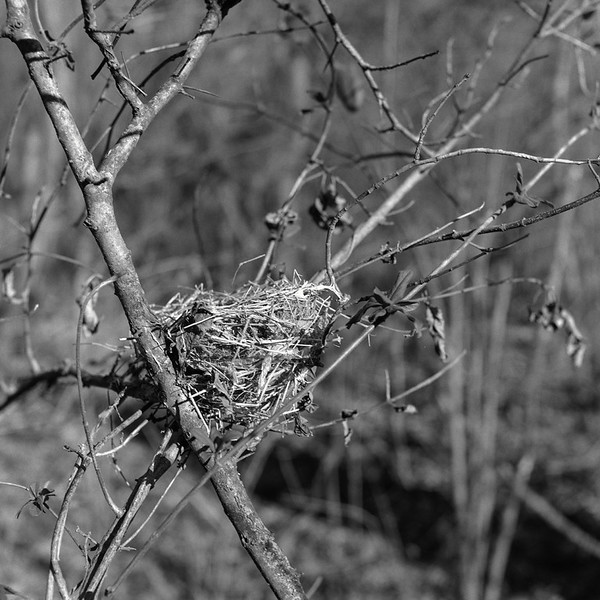

Like @BHuij's Zeiss Ikoflex, my new-to-me Rolleicord V focuses to only about a meter without help. I just got a Rollinar 1 kit, and I think it's going to work out very well. With the Rollinar 1, I can focus in the range of 39 1/2 down to 17 3/4 inches. I love the ease of the bayonet mounts (Bay 1) compared to screwing filters on my 135 camera lenses. And the Parallax correction provided by a combination of the Rolleicord's tilting viewing screen and the correction provided by the Rolleinar viewing lens is pretty slick. A lot more fun than trying to figure out how to frame closer objects with the Mamiya C220.
This bird's nest is a little smaller than my fist. And the front of the skull is about 24-inches from the film plane. So far, I have not tried to get down to the minimum focusing distance of the Rollinar 1.
