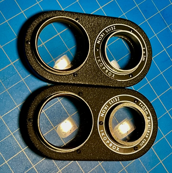

Ikoprox ! Nice, I have never seen those before. These would fit the OPs camera?

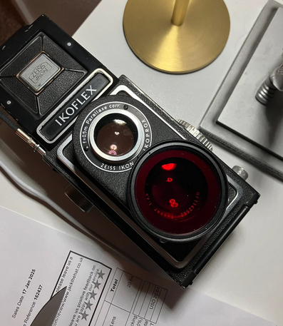

I ended up picking up the 0.5m version of the Ikoprox, as well as hunting down a deceptively uncommon 35.5-49mm step up ring on eBay.
Initial results are very good! This photo was taken with the Ikoprox and a yellow filter on FP4+, developed in Pyrocat HDC, and cropped in a bit to print an 8x10. Shallow depth of field (on purpose), but very sharp. I'm warming up to this camera quickly. Now I have my eye on the 1m version of the Ikoprox as well.
