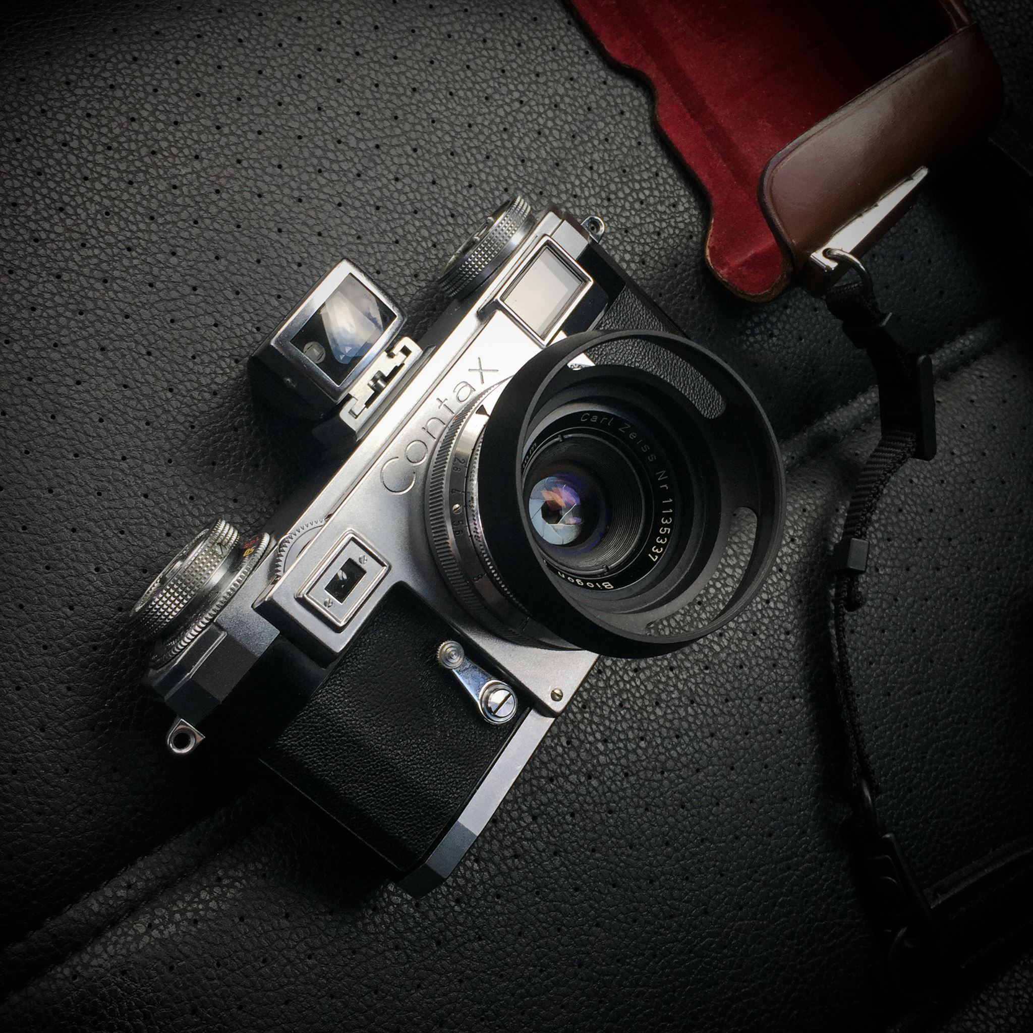

I have a lovely Contax IIa camera with both the post war Sonnar 50 1.5 and the 2.0 as well as a 35 2.8 Biogon. I love the 15 Sonnar but I don't think its as good as the Nikkor-S rangefinder mount 50 1.4 which I have used extensively. I use the 35 Biogon the most and its a fine lens. All of the vintage Zeiss lenses are very contrasty. They have a signature tonality which I like but needs proper film development to control. I am looking for a 21 4.5 Biogon at this point. Please enjoy your camera and lenses!
