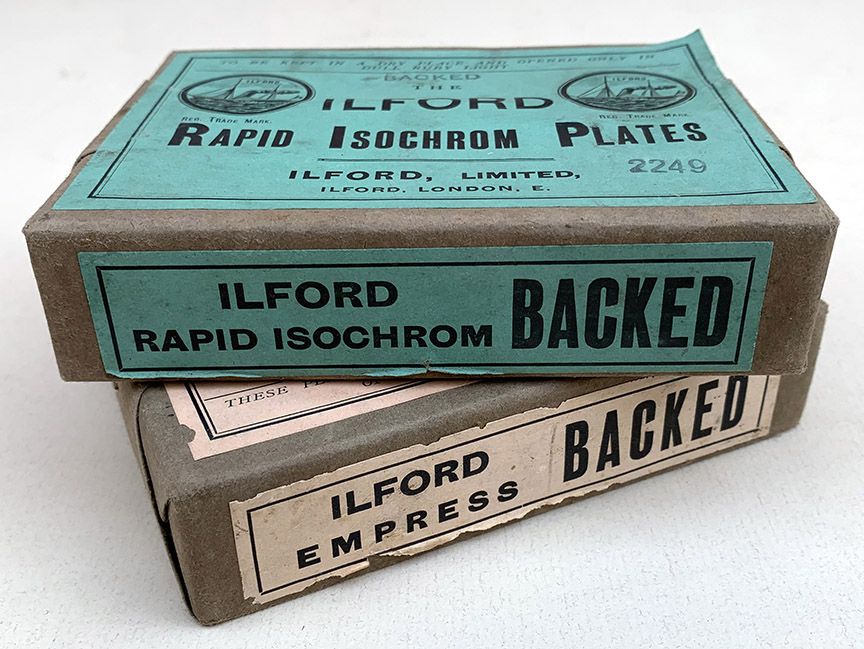

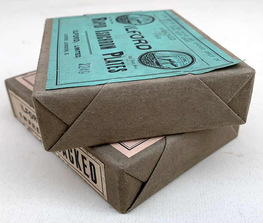

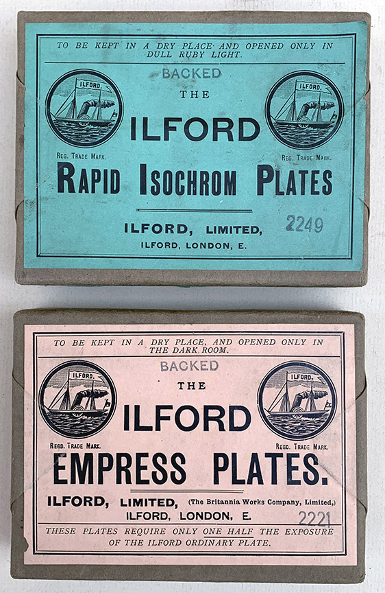

I think these might be close to 100yrs old... I can't find an exact listing on the WWW...Aha... Because the banner on the sidewheeler doesn't say "Ilford Limited" they appear to be pre-1908...
