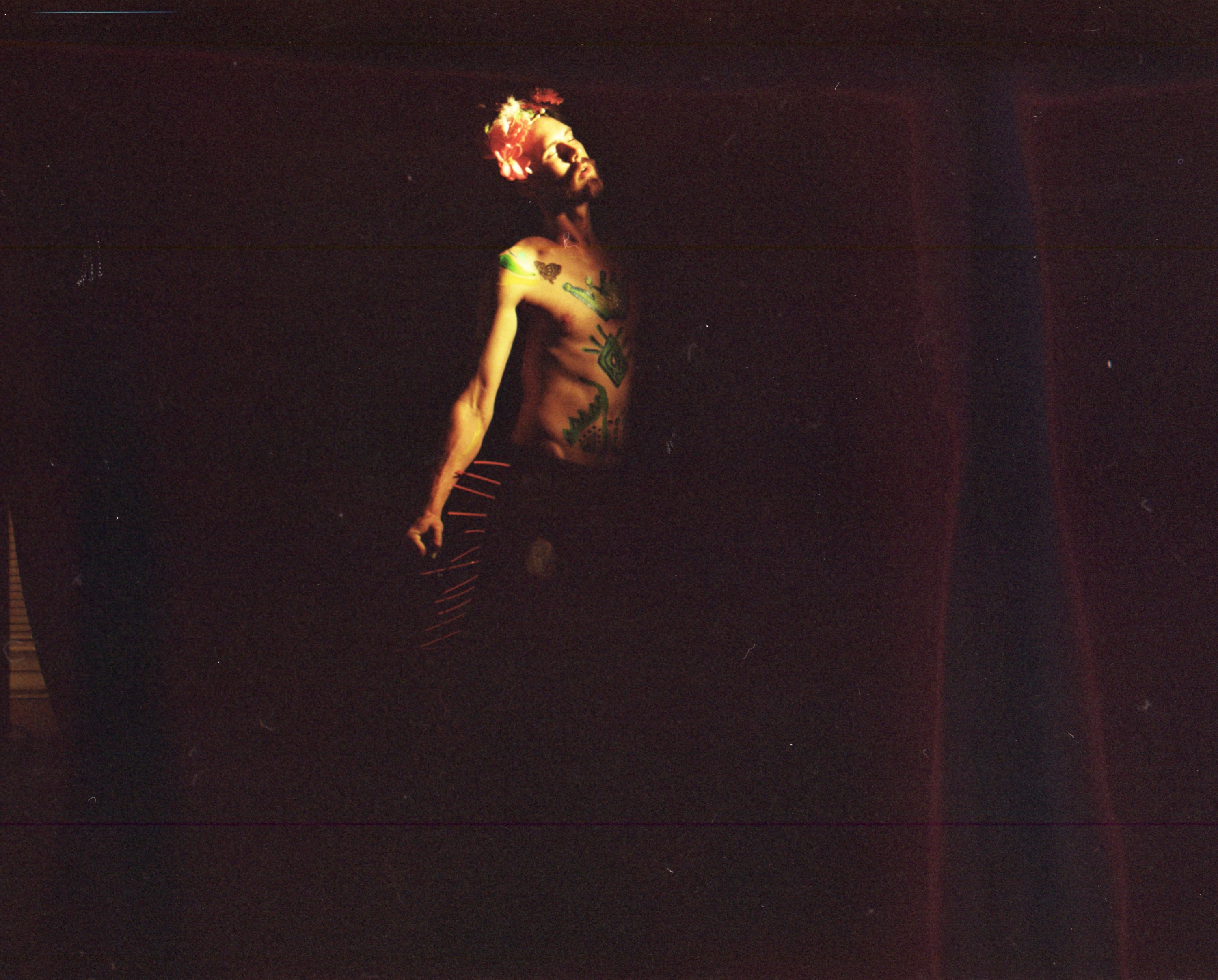

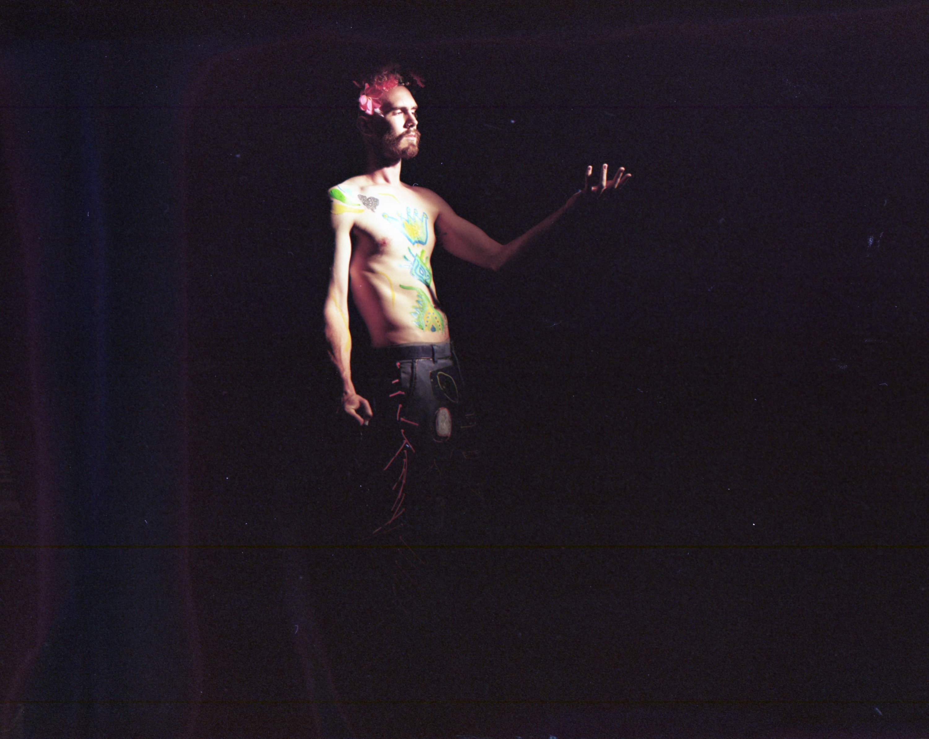

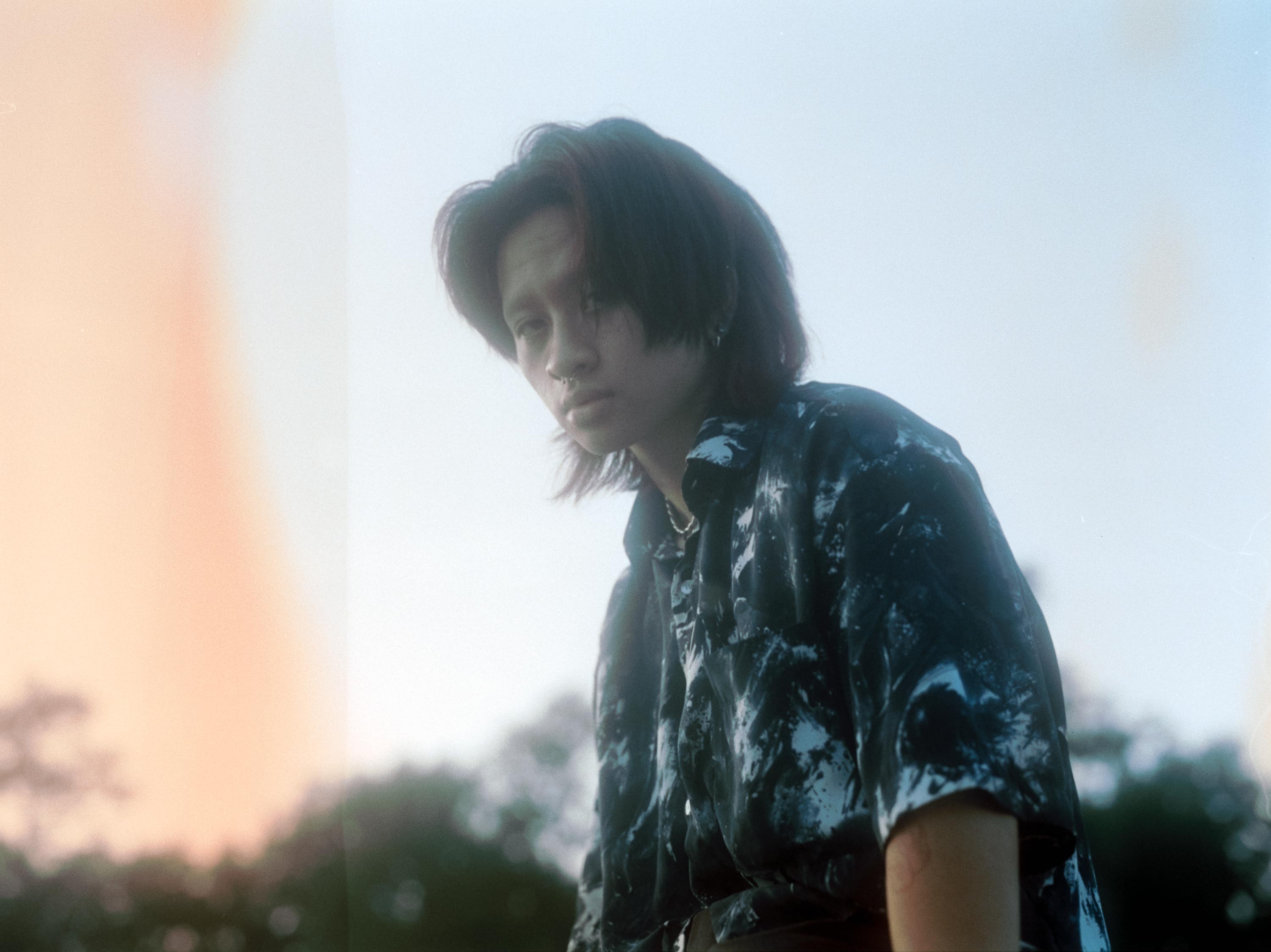

This is killing me. Why do i keep getting these streaks on my film?
199,361
2,790,363
99,885
sylvestercooper
Oct 28, 2021
27
Houston, Texas
For context I am using the Cinestill cs41 Color kit and a jobo 1500 series reel tank. Not every time but often I will get these long streaks on the sides of my negatives and am confused if it is the stabilizer or the dev tank? I mix all my chemicals with distilled water.

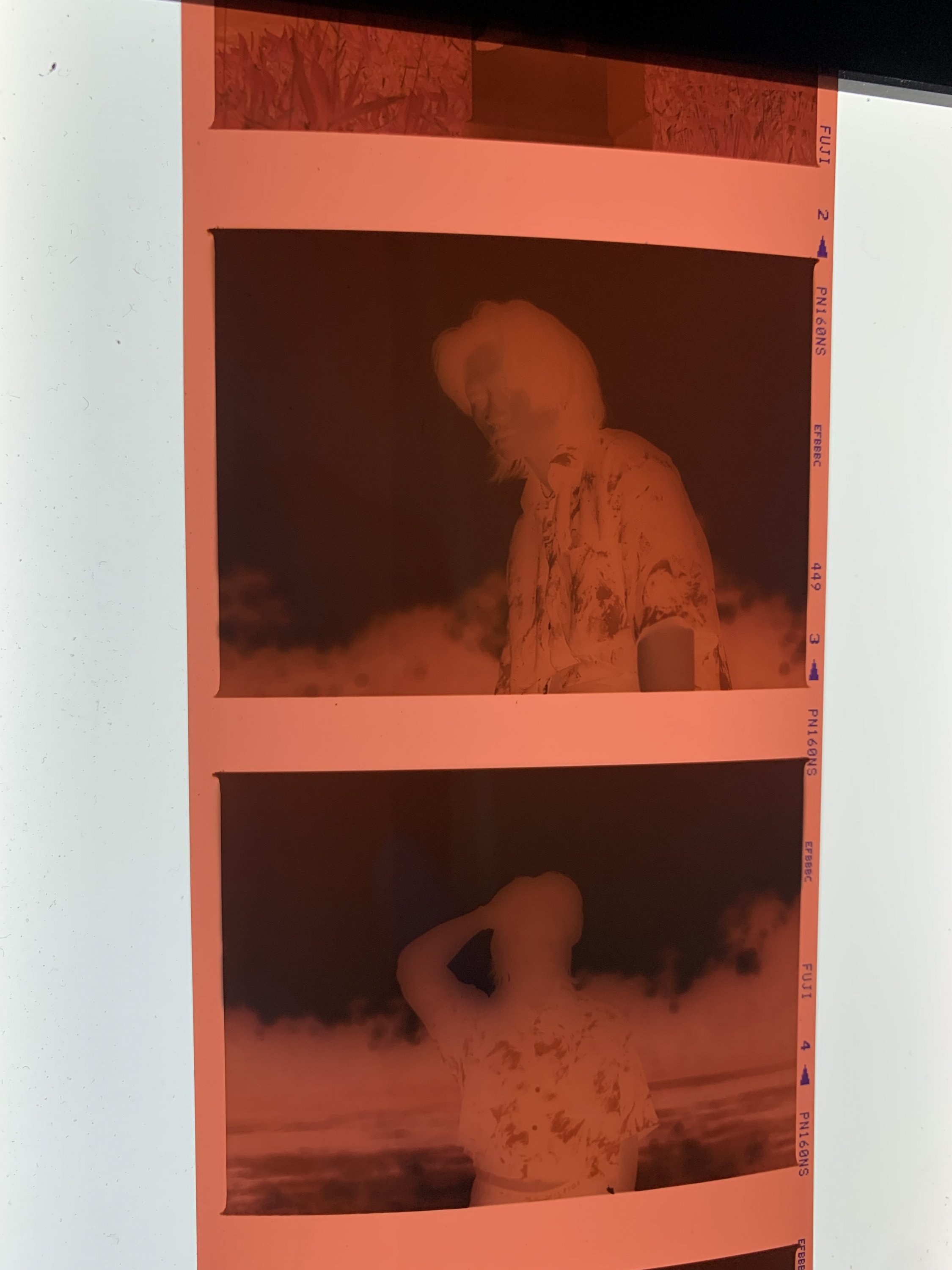

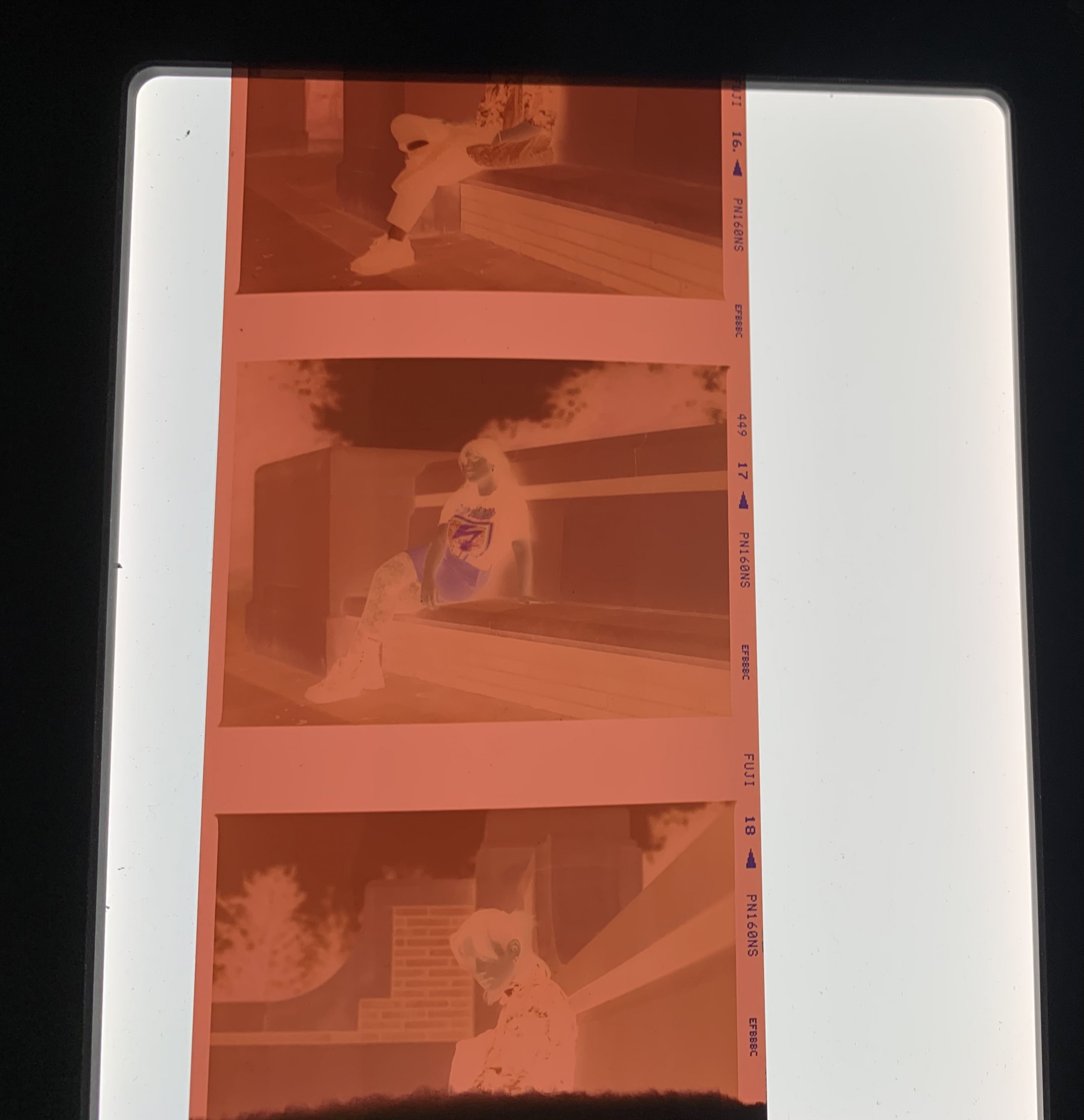

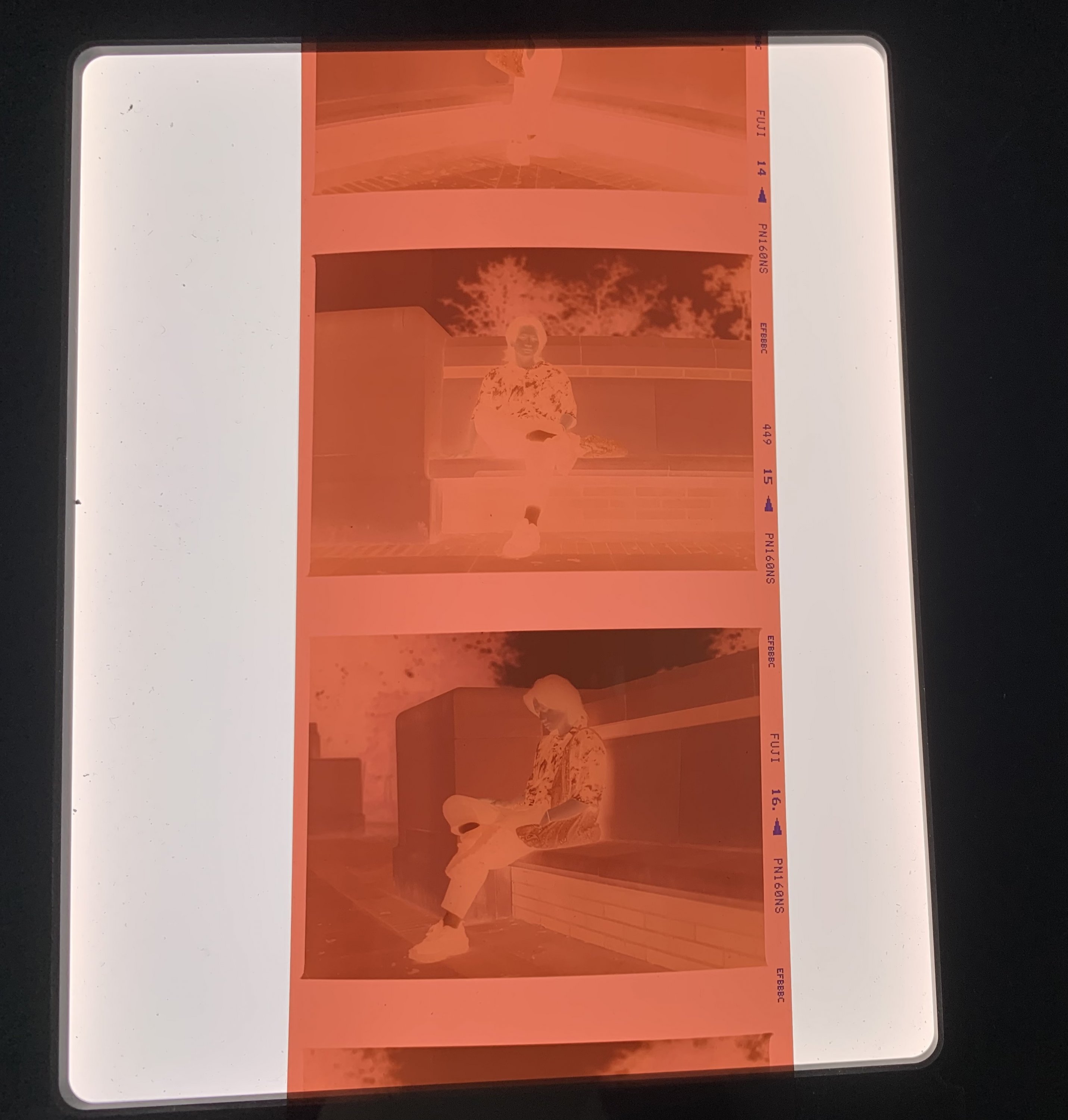

@reelquickfilmlab How quickly do you go from a vertical position to fill the tank to the horizontal rotation position? Your problem might be due to too much delay there. If you let the tank sit for 10 seconds or so before you mount it into the roller base, you're in trouble.
Hm, ok, that doesn't help all that much to be honest. I should have been clearer: can you post a photo (not a scan) of a piece of the film, backlit, that shows the entire width of the film and several affected frames?
It almost seems like you also (on top of the fluid problem) have some dichroic fog going on.

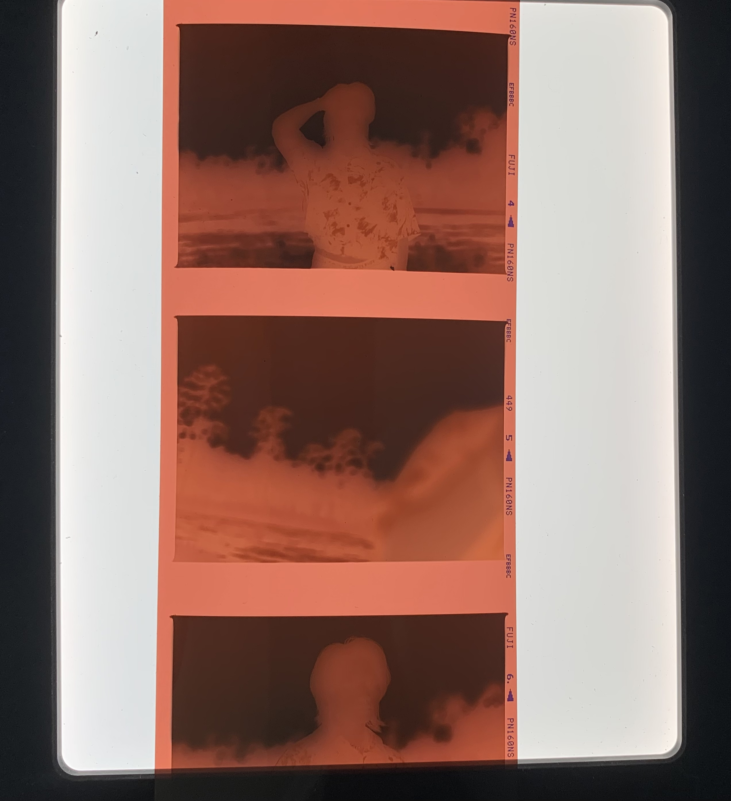

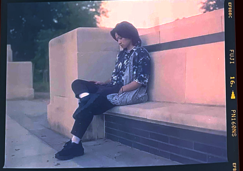

Hope these help

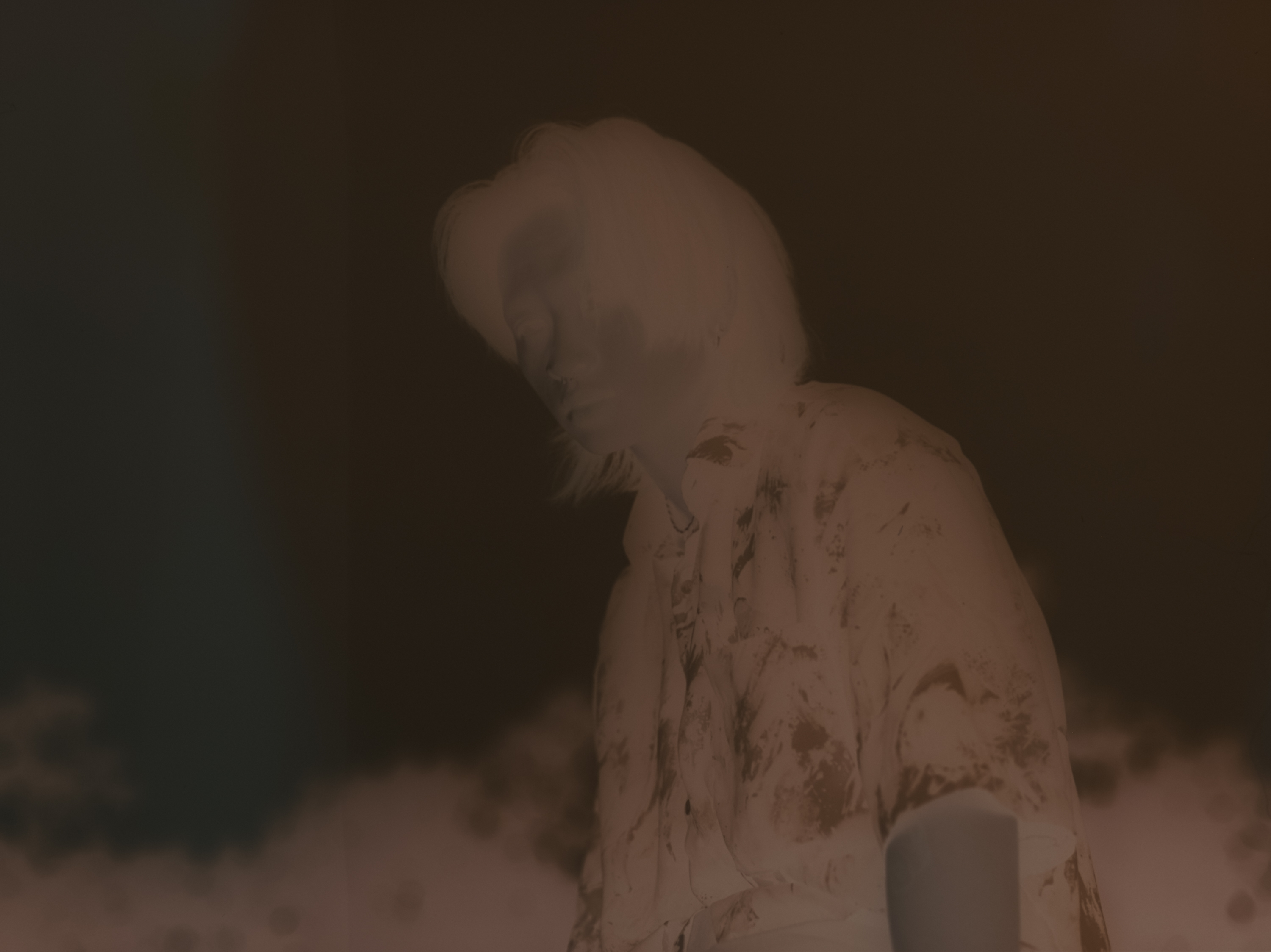

A quick and dirty post processing inversion of one of those negatives gives me this:
If it is something like dichroic fog, that might not always show in that workflow.
I'm wondering if the problem is with the stabilizer.

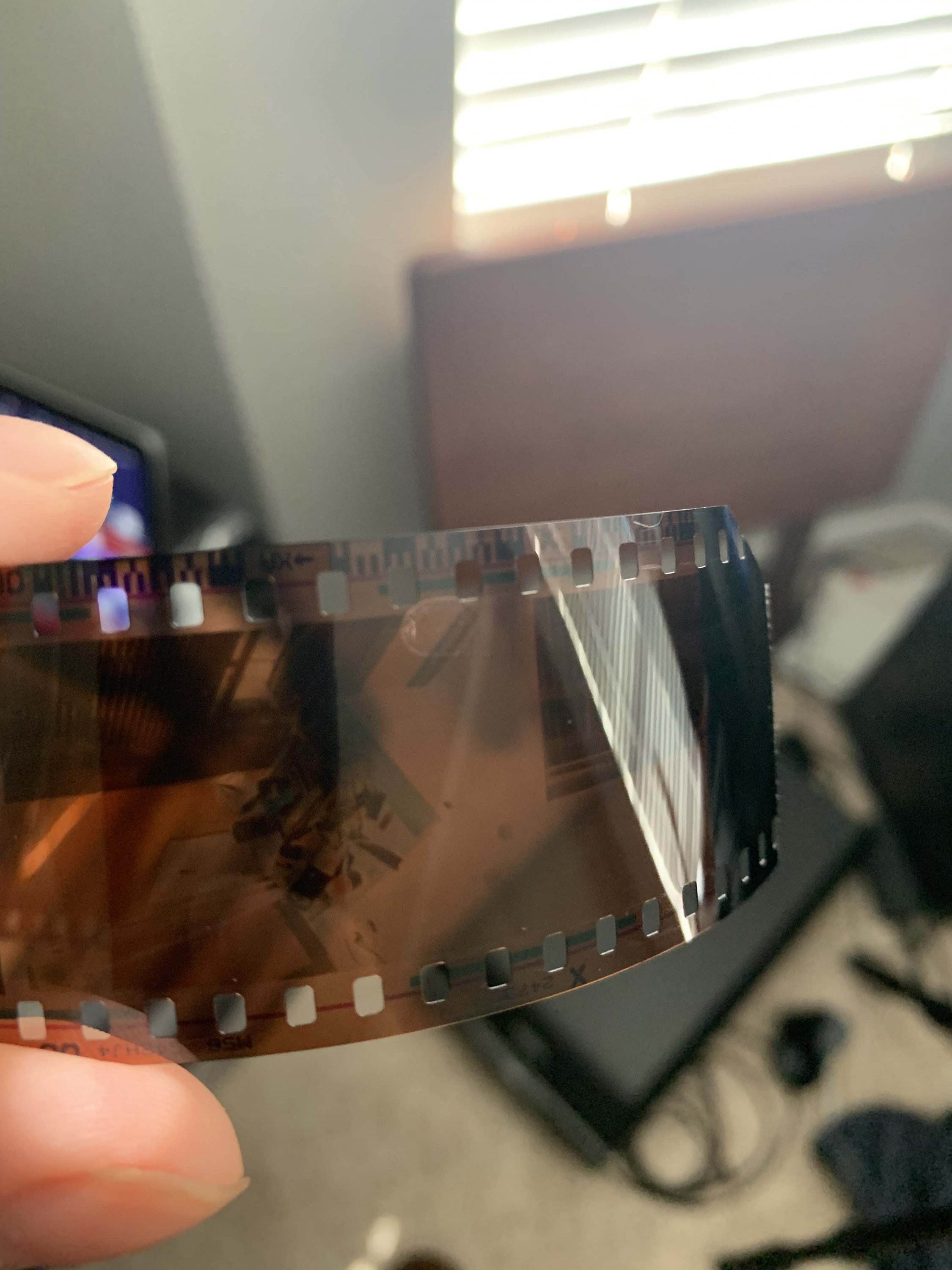

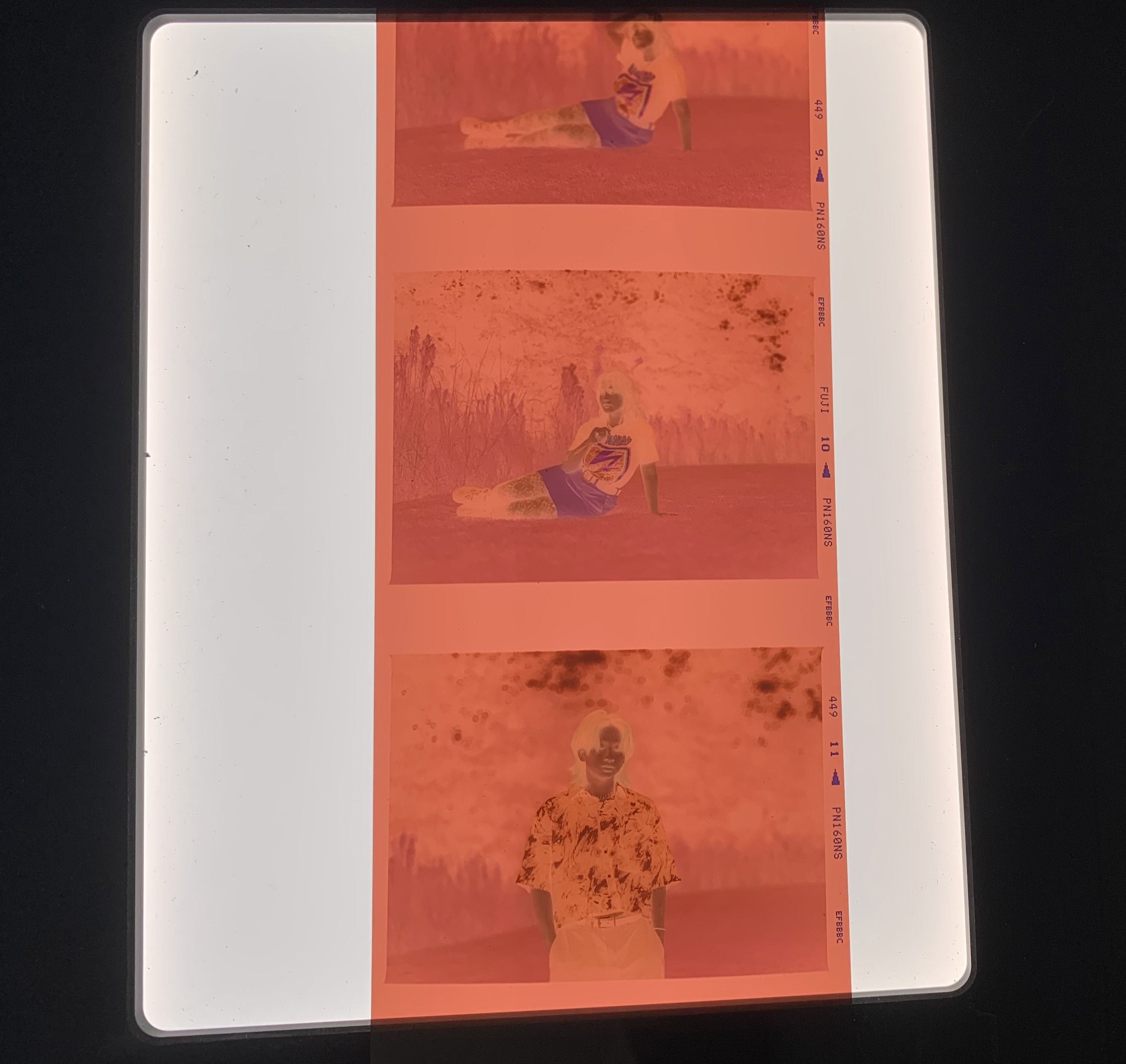

So I tried pouring the chemicals in and out quickly as well as doing a pre-soak for 5 mins at 100f or 38c and that seems to have solved the problem however I am noticing these water spots that I think are from the stabilizer on the negative. I have also been rinsing with lukewarm water between pouring out the developer and adding the blix.
brbo
Dec 28, 2011
2,165
EU
With smaller format the streaking is less of a problem. Water spots are from stabilizer, yes.

Presoak for color film is a must. Not recomended for bw.
The spots are only on the non-emulsion side of the film. Wipe it off with alcohol.

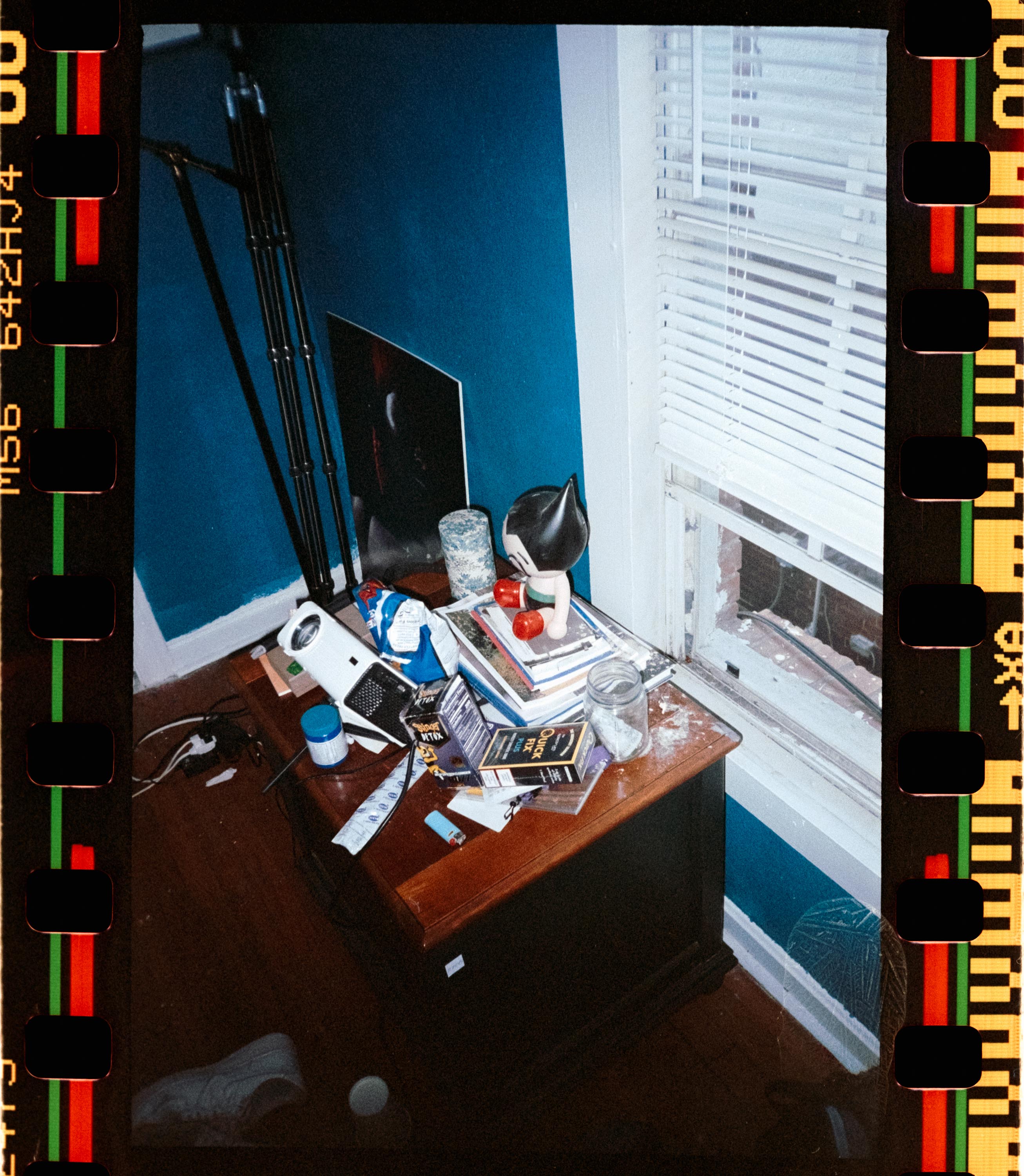

After developing some more 120 film the streaking is gone and I think it's most likely due to the faster pouring times. Thank you @koraks I did however try pre-soaking the film and am not sure if that played a part as well. But thank you all for the help. I now need to figure out what ratio to mix the stabilizer since the one Cinestill recommends is yielding spots on the negative.
