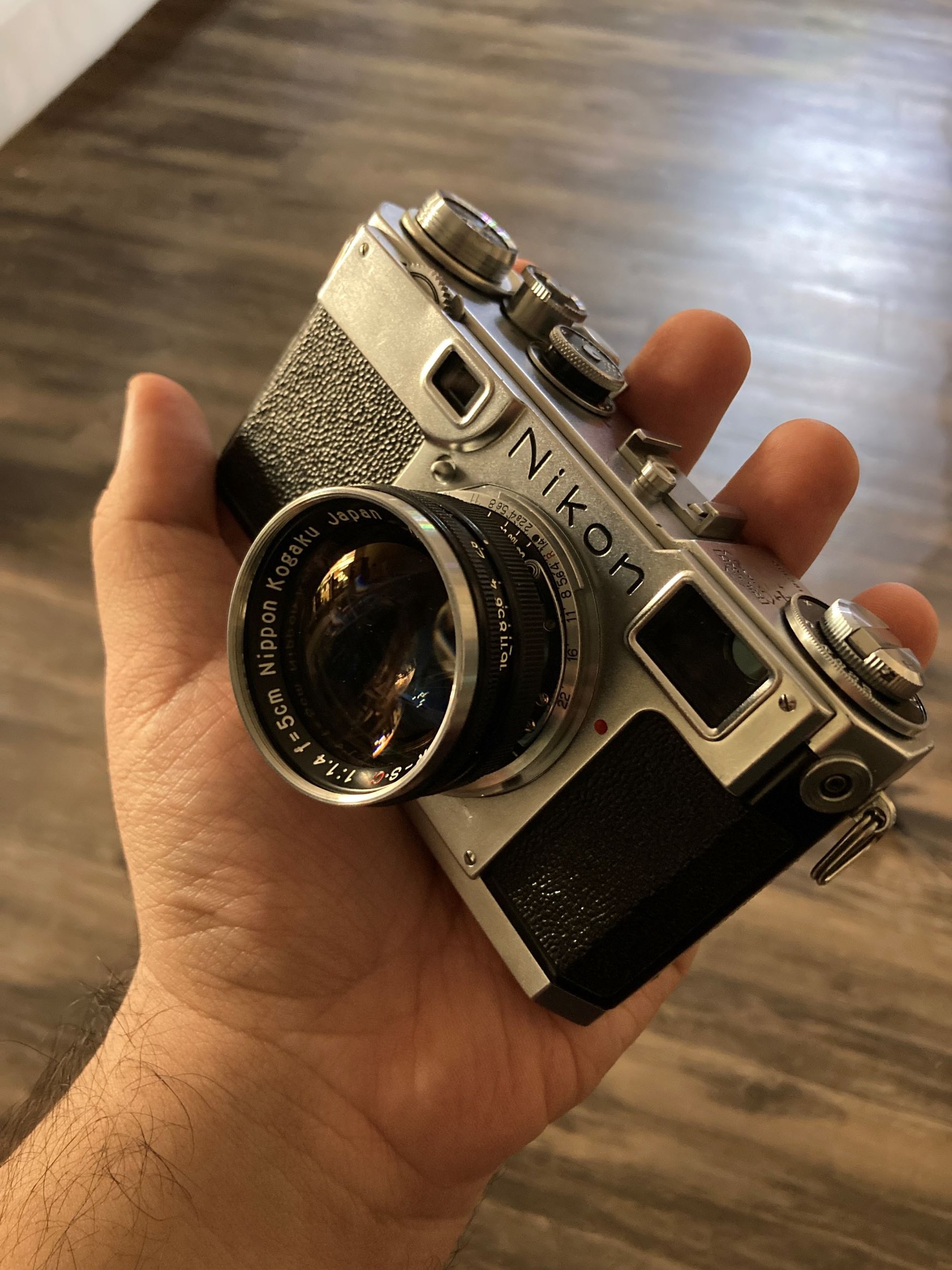

Well it just arrived. It astounds me how fast stuff from Japan gets delivered. Had to clean the 5cm f1.4 a bit, thank goodness its super easy to disassemble. So far I like it. The wheel focusing is super smooth with the 5cm and just has a tiny bit of resistance with the 25mm. Viewfinder is actually nice, I was expecting it to be bad but its not. Definitely cured the rangefinder itch. I'll take some pictures this weekend.
