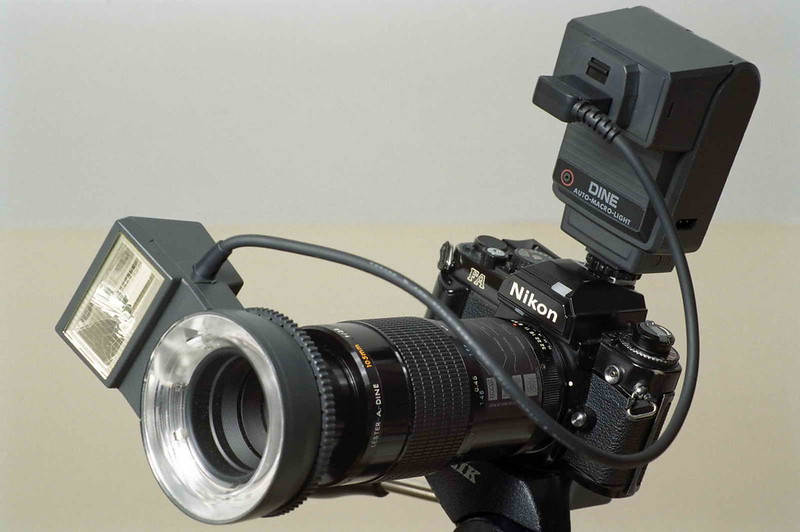

The FA is a fine camera and mine continues to be a productive shooter as I have had no issues with it. I agree with Ken's assessment that the metering is very competent and reliable.
Untitled by Les DMess, on Flickr
