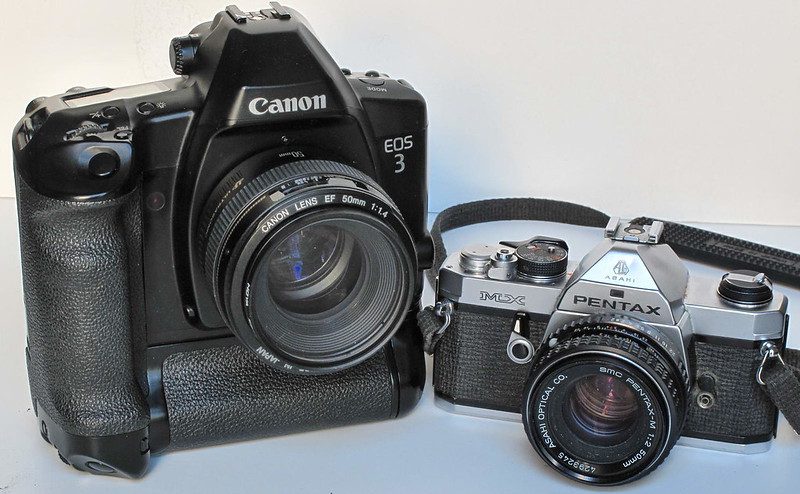

The F5/F6 tiny magnification is only 0.74X compared to the FM3A at 0.83X. The EOS1 is same as the F5/F6.
By comprison, the MX has a near lifesize VF magnification of 0.97X. Was eye opening when I first looked through it.
EOS3-MX by Les DMess, on Flickr
