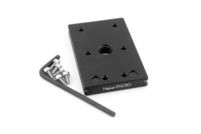

I have a lens support bracket for the camera and the 180mm or 250mm with TCs attached, since it gets pretty long at that point. It's not ideal, but it does appear to be a lot more stable when balanced in the bracket rather than on the camera mount.
I also have replaced the HB mounting plate on the camera with an Arca Swiss compatible plate made by Hejinar:
No other adapters are needed. Not sure if that plate will fit any other cameras other than the 501C, but I worked with Chris Hejnar to develop the SWC/M plate so he is really great about modifications.
As for your question on the dedicated lens collar; I haven't use one of those specifically, but there are a few companies that made similar products to use on other lenses (IIRC, RRS used to make one for a 70-200 Nikon lens years ago, and other companies make something similar for telescopes, etc.). You basically would clamp it as close to the balance point as you can get it, which I suspect is right in front of the focus-shutter collar mechanism.
It looks/feels like it would be a bit back-heavy with it that far forward. However, if you are intending to use an AS plate on it, you could get a longer plate and mount it so that you have a bit of room to balance the camera better on the tripod head. That may be the approach I'd take. Alternatively, the lens support bracket I shoed above should work well and may give you better flexiblity.
