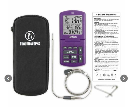

A few years back, America's Test Kitchen reviewed and picked some Thermoworks products as standing out from the pack. When a good sale hit my email, I bought a basic rig from them and have enjoyed using it for tight controls in the kitchen for yogurt making, meat cooking, beer brewing and tuning brew temps on my espresso gear. It's easy to check calibration and is confidence inspiring in general use. I bought my son a version one Christmas with a remote neck lanyard for smoking and slow cooking outdoors without needing to monitor so closely at the grill and he's loving it (while not being a gadget freak). I see they now have Bluetooth/Smartphone gear, too.
I've been fine with glass/mercury/alcohol lab thermometers in the darkroom but when playing with the chambers in a Nova processor I tested yesterday, I pulled out my digital rig and realized how handy it could be in the darkroom. It also has a timer built in and could make for a nice assistant in the darkroom. They make multi-channel rigs and quite an array of options/probes/features that could adapt well to photo duties. They seem to function in the mid-price range between the disposable cheapies and the lab grade professional gear. Their site is at: https://www.thermoworks.com/
The basic rig I'm using is this one:

I use something similar on a regular basis.
I confirm its readings regularly by checking it against my calibration standard, a Kodak Process Thermometer.
