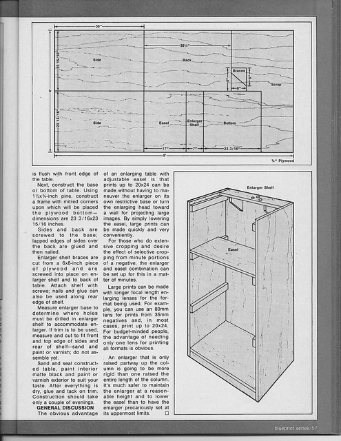

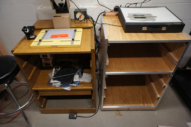

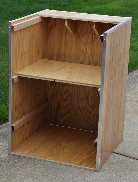

Omega DII Drop Table no 2 nearly completed by Nokton48, on

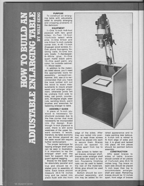

Today I put this second Omega DII Drop Table together. I think it came out rather well, I used the plans right out of an old Peterson's Photographic book about making photo equipment. I used an expensive sheet of oak plywood wood (might as well!), and some oak strips, from the local pro woodworking store, and they even cut the pieces for me in the store. All I had to do was put it together.
A few more embellishments and it's ready to use. And some good quality heavy locking casters as well.
Thomas Safelight Restored by Nokton48, on Flickr
Phase I nearing completion 2 by Nokton48, on Flickr
My late Brother in Law built me this drop table, thirty years ago. He was a contractor building expensive custom homes. I gave him the Peterson's plans (same ones I just used) and he surprised me with this table at Christmas. Basically this machine is scaled to make 16x20s max, with cropping. It is sturdy 'cause the enlarging head stays low, where you can see and handle the controls.
In my new darkroom, the plan is for two Omega DIIs, side by side. Today I will finish the drop table. :smile:
Jim B, what do you think??

I had a drop table in my previous two darkrooms, similar to what's shown above but much wider as I had two enlargers side by side. I had tight head room in a cellar this allowed me to make large prints up to 30"x20".
These days I use a floor standing De Vere 5108 with built in drop baseboard. If I didn't I'd definitely go back to a drop table, my one enlarger mounted on wall brackets the other to the rear of the table with a strap to the wall for rigidity. So easy to work with and the same benefits as my floor standing enlarger. Personally I'd want more width, I guess I had about 50% more than those examples.

16x20 is as large as I go without getting very complicated. That will do for me right now. In the next thirty years I figure I will expand.

A sturdy wall-mounted enlarger permits a lighter drop table. Rather than fit an existing drop table into your darkroom, design your own table to best fit the darkroom.

"Jim B, what do you think??"
I like it, Dan. That's similar to the design I have but mine is built in, not mobile. I'd have to go out and measure but I think the surface that I move is 30x42" (+/-). I have three sets of cleats I can lower it onto plus the floor.
Like others have mentioned, I anchored the top of my masts to eye bolts in the wall with threaded rod and turn buckles. Simple, solid design I copied from the dark rooms I learned in at our local college.
I'd post a photo but I lost my digital camera recently and I don't think I have any on my hard drive. Might have to borrow my wife's camera.
The fact that you intend yours to be mobile is interesting. I see advantages, for sure, but I think I would want some way to secure that mast when printing - maybe some unistrut or t-trac along the wall you intend to print in front of. Those heads are heavy and it seems like if you have your head way up and your mast unsupported you could get some vibration. Maybe not. It's probably just me obsessing over stuff that doesn't matter.
Really enjoying following the progress as you get your dark room together. Looking good.

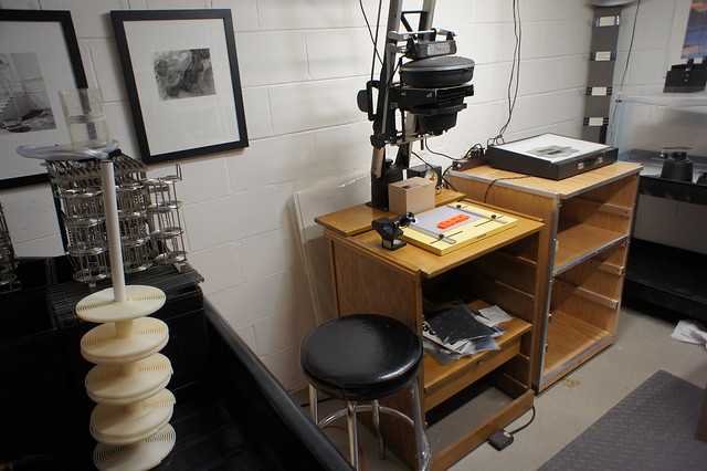

Second DII finally initial install by Nokton48, on Flickr
Side by side Omega DIIs is real luxury. Finally DII #2 is initially installed on the second drop table. Needs more cleaning and boku adjustments, but the images on the easel look sharp and all good. I can print on it starting right now.
