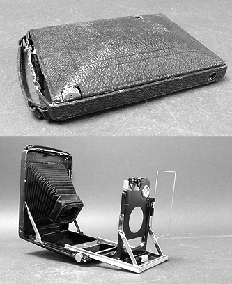

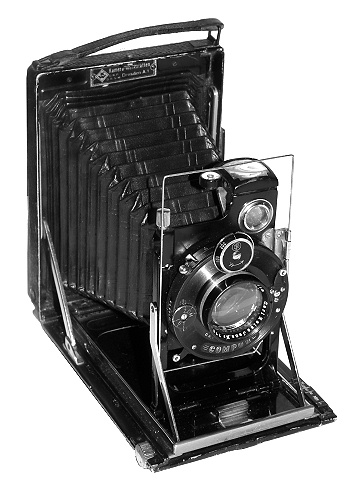

No not a Littleman . . . :smile: My 9x12cm Patent Etui's arrived in the UK a few days before me.
Wow, what wonderful engineering, small, light, and they fit a pocket, well a big pocket, but they are a fraction of the size weight of their European competitors. Compared to a Orion Werks at 1245gms the Etui weighs 815 gms and is slimmer and more portable.

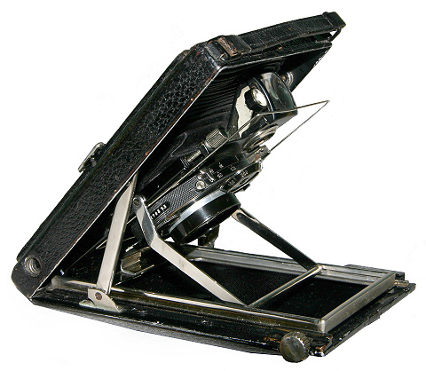

The silky smooth mechanism allows the camera to fold into it's case - Etui in German -with no room to spare.
Once open the camera is quick to set up and use.
The 9x12cm format is only slightly smaller than 5"x4" (10.1x12.7cm) but in comparison to a Speed or Crown Graphic (2.4 kg) the Patent Etui is a third of the weight and about a 1/5th of the size when folded.
The Tessar lens serial no indicates it was made around 1927, the Compur shutter has a 5 figure serial number which is odd, and has paper aperture blades.
The second Etui was described as "Korpus" with no lens or back, it had obviously been opened with a can opener, however it tapped back into shape with ease and it's now hard to spot any damage. This camera is to be a user. I had hoped to fit a Eurynar but its Compur shutter is much to large, so I'm back to finding a small compact coated 135mm lens that will fit :D
