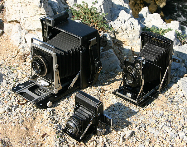

Here's some images to indicatethe camera's size. The first shows a 5x4 Crown Graphic, Ikonta 521 (6x4.5) and the 9x12 Patent Etui.
As you can see it is very significantly smaller than a Crown Graphic.

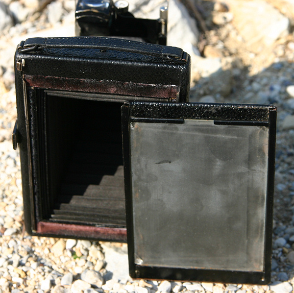

And here's the back for Curt, sorry I didn't bring any holders to Turkey as my luggage was already over-weight :D

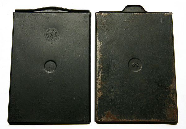

Lastly plate holders that fit, I posted them in an (there was a url link here which no longer exists).

Curt, I'll take some photo's of the back later today.
Ian
you will have to take my word for it Ian. That is unless it only counts if you have seen it :wink::smile:

Thank you Ian, it looks like it takes dedicated holders that slip in and they look very thin, someone really had the think cap on when they designed this camera. I wish some of the old designers of yesterday were here now to design some great cameras. I hadn't heard of the Etui before you posted yours, have a great time with it.
