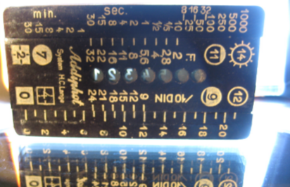

I just picked up an extinction meter - my first - an Addiphot. What is remarkable to me is that this device looks an awful lot like Fred Parker's Ultimate Exposure Computer.
Here is my take on how you use it. First you pick the main number for sun, clouds, bright indoors, dark indoors... then add the number you can see on the extinction scale. Since your eyes are always adapted to conditions, the highest visible number will usually be around 2 or 3.
The scale slides over the holes but I don't think it's part of how you use it. I think you show all 7 holes, read it, and then use the slide rule.
I'm not having the best luck with guessing exposures using it.
This seemed to have an amazingly long lifetime in the market... It seems to have been made in the thirties, and I see Popular Mechanics magazines from the '60s and '70s still advertising it.
