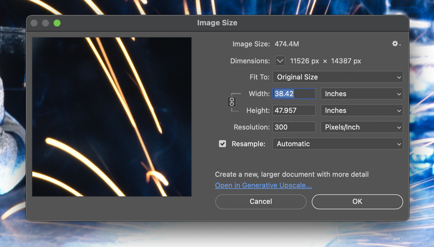

Ok one point of clarification. Mutli-shot can be enabled in electronic shutter mode!!! The trick is, you have to use an extension tube which has a chipset so there is some communication with the camera. I made some stitched scans (4x5 in 3 lines down from the top) and had to get closer than the helical allows. What do you know, the multishot feature returned!
The below 3 image stitch was captured in multi shot mode and the resulting file is roughly 40x50" at 300dpi. Not bad, not as good as the Creo. It's nearly 4000ppi.
Keep in mind the actual file in PS will look better than the compressed crop I posted here.
