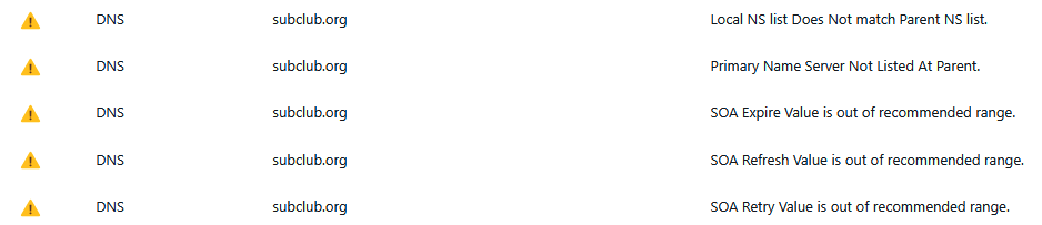

Btw, no access problems here. And indeed, the error posted in #3 is a domain name resolve error. I.e. the domain name doesn't resolve into an IP address. It's unrelated to SSL. @xkaes you might want to contact your hosting provider and file a support ticket with them. You can refer to e.g. this page to describe the problem: https://dnschecker.org/#A/subclub.org
Looks like there's a pretty serious/widespread problem with your domain name not resolving in a large part of the world.
Edit: and it looks like it may be a problem with a faulty DNS config:

You're welcome. Your web host should be able to help you out fix your DNS records. I expect this is really the problem; the incorrect settings are accepted by some servers, but not others that are more discerning.
Please note that this is really a server-side issue, so it's unrelated to what browser or operating system someone uses to try and access the website. The determinant is which DNS servers are used and whether they're OK with the technically incorrect DNS configuration.
