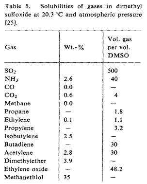

I'd like to discuss the use of DMSO as a solvent and preservative for developing substances (agents). And also as a liquid "sulfite".
DMSO is known to absorb SO2 very well. According to some reports, it is much better than DEA / TEA. In addition, gaseous oxygen is practically insoluble in it.
Unfortunately, there are not enough practical data on the use of DMSO in photochemistry. Therefore, I will be glad to any comments and opinions on this matter.

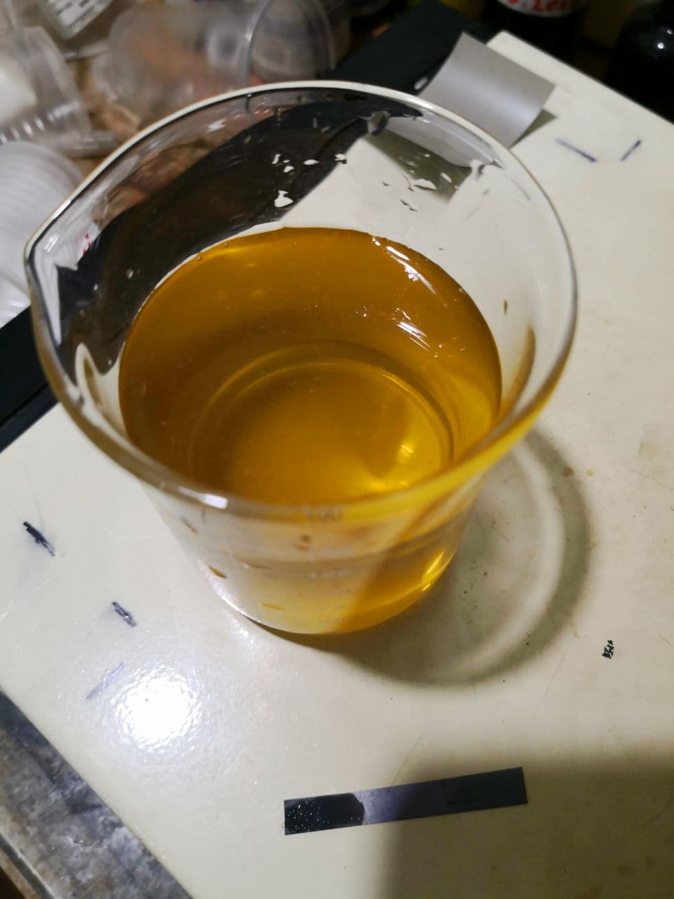

p.s. The first experience in the preparation of PQ concentrate. I saturated a small amount of DMSO with sulfur dioxide (warmed up a little with potassium metabisulfite). Then, dissolved hydroquinone and phenidon (very easily, at room temperature, by hand). I added some TEA to the resulting solution.
The concentrate was diluted 1 + 25 with water. pH of solution turned out to be about 9.x The color is bright orange. A piece of Fuji's X-ray film HR-U turned black in 30 seconds...
