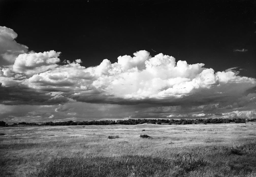

I am sure that the skies I shot in my last b&w roll were interesting. They were either a mix of blue and white or gray and white, as I have indicated.
If your skies are white then a yellow filter is the wrong filter for you. A yellow filter can produce 'natural' skies when the sky is a deep clear blue. If the sky is the normal hazy-light-blue/white of the urban environment then a yellow filter will do little.
You need to get a red #25 filter and stack it with a polarizer ... then your skies will show all the detail there is to be seen in them.

As I understand it, black and white film is disproportionately sensitive to blue, tending to render it white. A medium yellow filter will fix this, as will a polarizing filter under the right light conditions. Polarizers are most effective when used at right angles to the sun. They are also great for taking the glare off water. Red filters will show more cloud/sky separation than your eye can see and darken the sky. As the poster above showed, they can make the sky very dramatic, especially when combined with a polarizer.
